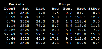

MTR under load, expected latency at the last hop is 11ms:

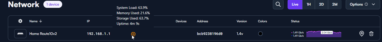

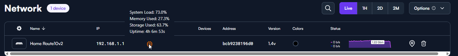

Alta Cloud Management UI:

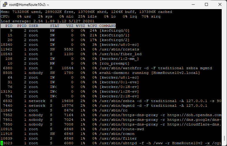

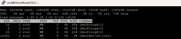

top output under heavy load:

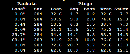

Eventually the high latency comes back:
Hmm how many active connections are you doing? Also maybe another screen cap of top? I assume it’s going to be the same processes.

It does look similar to the top screenshots in your case:
