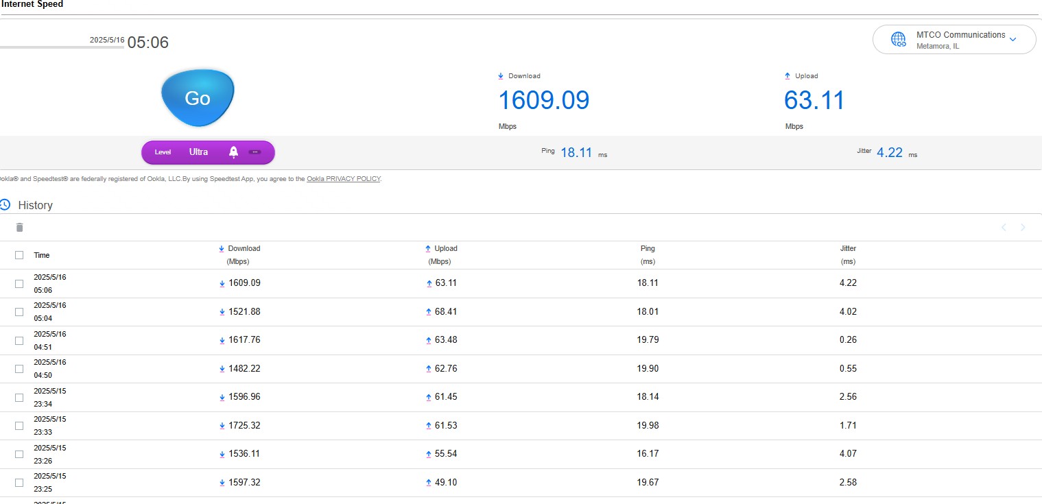

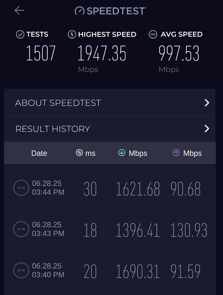

After a few months of failed config after config I think I may have finally made some progress. I have not seen results like these until yesterday. I have been trying to achieve higher throughpout combining the three 1Gbps cable Internet services.
I am using 2 Route10’s, 3 WANs (3 X 1Gbps cable connections), and an Asus ExpertWiFi EBG19P.
My father and I have rg6 cable between our houses and we have installed Screenbeam units to extend and connnect our houses. The Screenbeams communicate at up to 2.5 Gbps.
My father has two seperate 1Gbps cable internet WAN services which are combined using the first Route10. The second route10 is at my house with a single cable WAN which combines my 1Gbps cable WAN with my fathers dual WAN.
I have been working on this for so long I am not sure if I am dreaming when i see these results, either way I am a happy man. I do understand that the speeds are somewhat superficial, however i believe there is a lot of potential.
Sorry if this post is hard to follow, its 5am and i haven’t had my coffee yet. I am sure I have left out a lot of details so if anyone has any questions I am happy to answer them.
Have a great day!
just a friendly update:
I have removed all of the Asus hardware that i had implemented and am only using the Alta Route 10s now.
I am seeing a combined speed of around 1800Mbps from the combo of 2 1GB cable services.

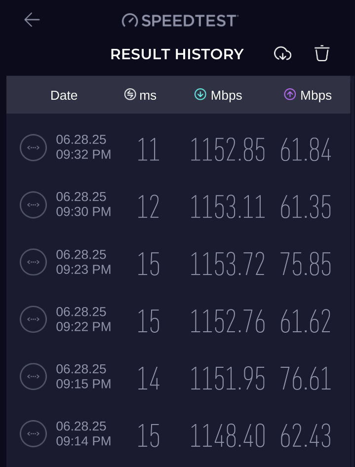

  2. Speed tests are inconsistent, sometimes I will see the combined bandwidth being utilized but other times it appears the Route 10 is only using one of the 2 connections. A reboot of all hardware and it seems to utilize both connection for a while.

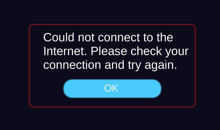

  4. Speed test (Ookla desktop software) randomly fails to execute test. Displaying no connection available. After a few clicks it seems to respond with under 20ms ping and no packet loss. I am not sure what is causing the failure because i can stream/surf web at same time so I know I have connection.

here is an example of when the load balancing no longer combines the two services. Usually a hard reboot(unplugging the route10), then modem reboot, seems to fix this issue:
Any ideas?

  2. So.. I need to get this out of the way. Load-balancing does not equal channel bonding. They are 2 completely different things, and from what you’re describing, you want bonding. We don’t currently support SD-WAN. Does your ISP offer MPLS or channel bonding over the WAN? Also, see HERE, and specifically quote:
* Linux outgoing network traffic load-balancing is performed on a per-IP connection basis -- it is not channel-bonding, where a single connection (e.g. a single download) will use multiple WAN connections simultaneously
* As such load-balancing will help speed multiple separate downloads or traffic generated from a group of source PCs all accessing different sites but it will not speed up a single download from one PC (unless the download is spread across multiple IP streams such as by using a download manager)
  1. The multi-WAN daemon on Route10 has no idea about the multi-WAN daemon on Route10 2. Further to that, when the one WAN is NATed that means the traffic will come from one IP/MAC. Right now connections are sticky per MAC, so the one WAN would choose 1 of the WANs and basically move most if not all traffic over it… So outside of having 2 separate multi-WAN daemons taht know nothing about each other.. Then taking a step back, if it helps to view it this way.. mwan3 in general will manage sessions, not packets, so it has no knowledge to boost/aggregate throughput in the way you’re hoping for.
  2. I would expect that sometimes there would be unexpected behaviour in your topology.. Maybe acceleration is misbehaving at times, could try turning it off to rule that out.
  3. Unfortunately what you’re trying to do probably won’t work the way you want it to with what’s currently available. It’s definitely an unintended use of this feature, so is unsupported.
Speedtests are not sufficient data to either prove or disprove what is or isn’t happening with load-balancing in this configuration, or even in general.. It’s a start, maybe, but you’ll need to verify the actual path of the flows across the two routers.. Remember for example, 1 WAN is behind NAT, so for that WAN all traffic comes from one IP/MAC, meaning it’ll always hit 1 WAN only at the other end and would NEVER expect it to be balanced normally like a WAN that is not behind NAT. Rebooting it just makes it more likely to switch back, so I can’t say that’s a sign of it dying, or not.
I think what you’ve achieved so far is admirable. I’m not trying to discourage further tinkering. But the reality is you’ve likely gotten almost all you’ll be able to in this Frankenstein configuration, without leveraging a different feature set. If you do decide to continue, and wish to share further results, fantastic! I wish the best success. However I’m worried that we’re at the point of diminishing returns, where you’re investing more time without making much if any more progress (without different features) .

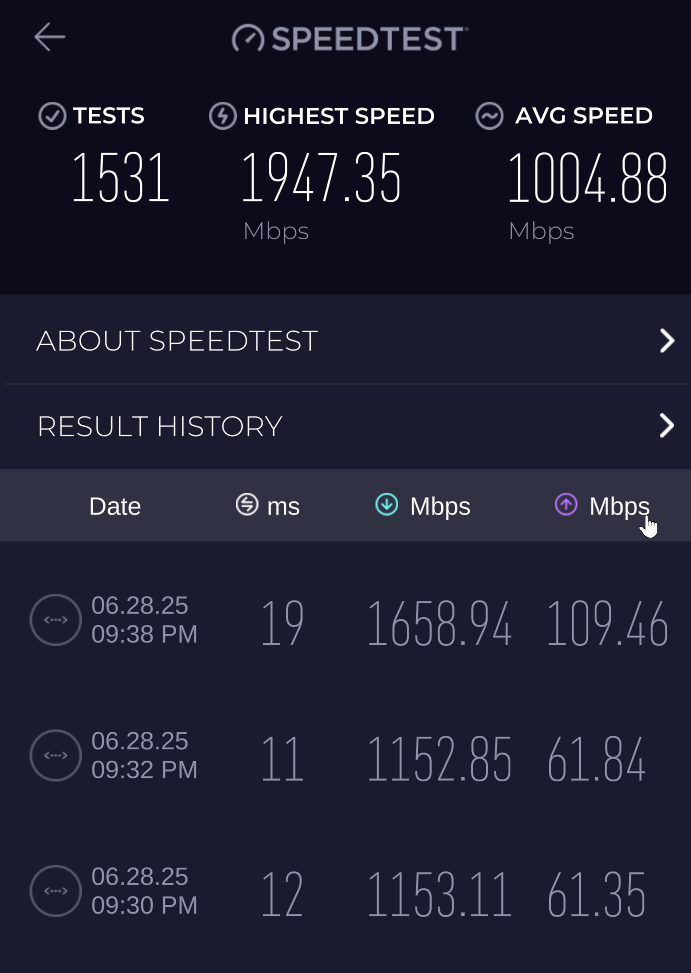

Another update:
I decided to remove one pair of screenbeam coaxial/ethernet devices.
I only have the 3 circuits, 1 at site A(Borroville), 2 at site B(Meadows).
I am starting to understand how these things are working and not working. I have simplified the setup as much as possible at this point. I have only 1 pair of 2.5Gb screenbeams currently hooked up, which I originally thought would transmit the 2 combined WANs at site B to Site A.
When i do a speedtest from the CLI by pressing shift and clicking the site name, i can see both sites balancing two connections independently. Site B using two WANs and site A using 1 WAN and the signal from Site B as WAN2. Both Route 10’s reach speeds in the 1900’sMbps. I assumed Site B would then be able to make available the most of its bandwidth to Site A. That is not the case. However, Site A, is able to utilize roughly 8-900Mbps from Site B, and I am seeing speeds close to 2Gb on most networked cpu’s.
So why doesnt the signal from Site B provide more than 1 WANs bandwidth. I cannot seem to break the 2.0 Gb ceiling
As far as youre responses, understand what you are saying. This is much more complicated than I knew lol. My experience and knowledge on these subjects is very limited but I am learning faster than i anticipated.
I cannot thank you enough for your responses and time

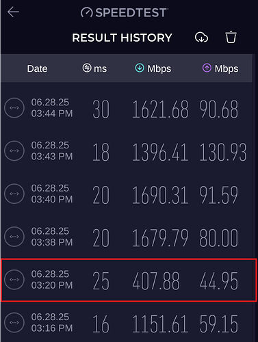

so i am having success but not without a reconfigure every reboot or setting change. I am having an issue with the pbr rule populating the startup automatically. is there a way to save a .cfg file on the route10 that would load my own mwan3 config instead of the default utilizing pbr?
