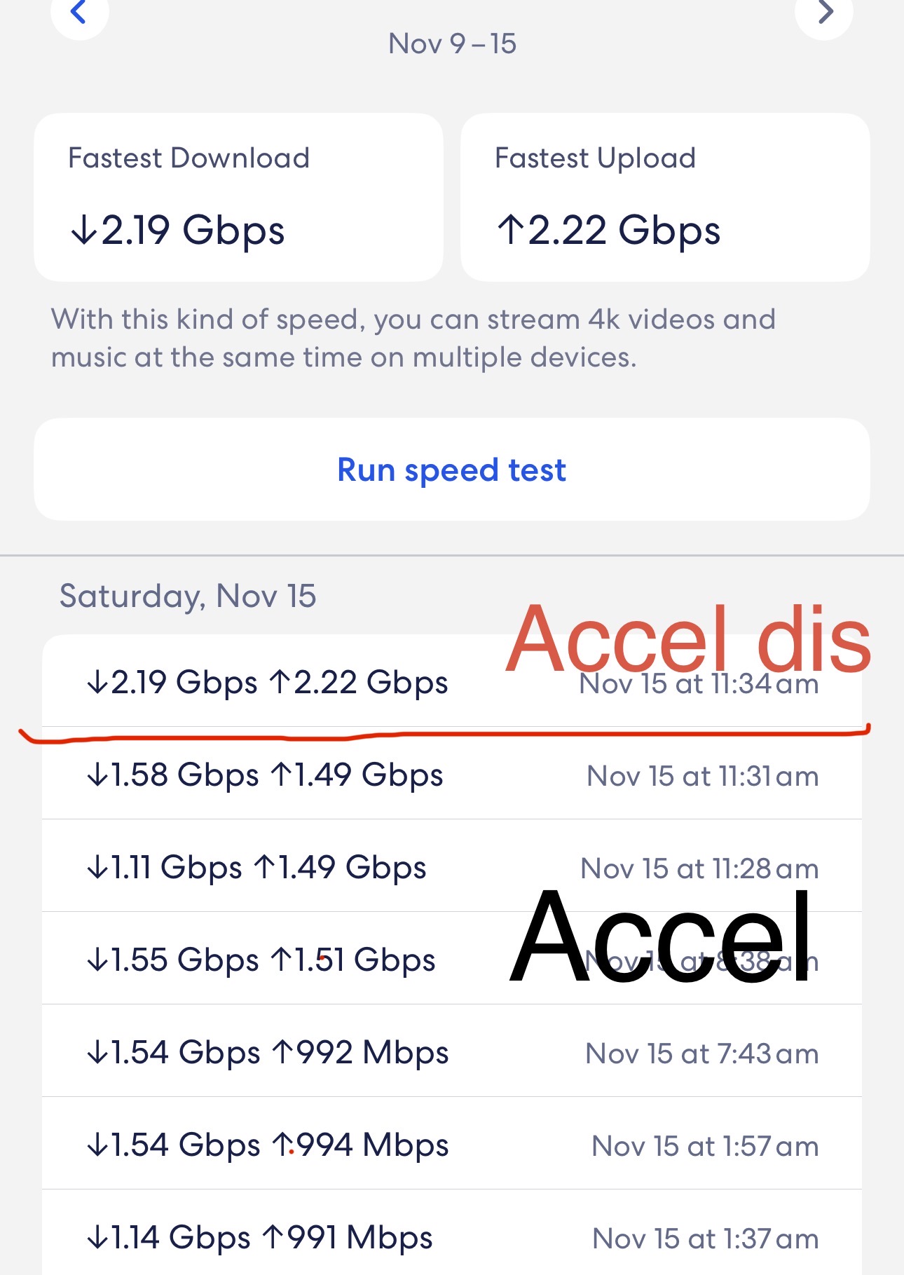

Looks like if I disable hardware acceleration it fixes the problem. Might create other problems, but it fixes this specific issue.

I tried that too and saw the same results as the normal acceleration setting.

i noticed with hardware accel enabled, when I do a throughput test, the cpu stat reported on the UI goes to 52-53%. With hardware accel disable, it only goes to 32-33%.
>20% increase in CPU for the same traffic seems off
