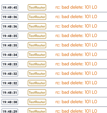

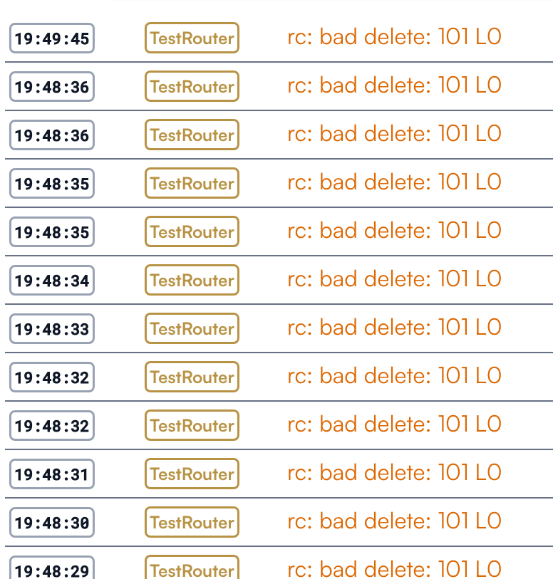

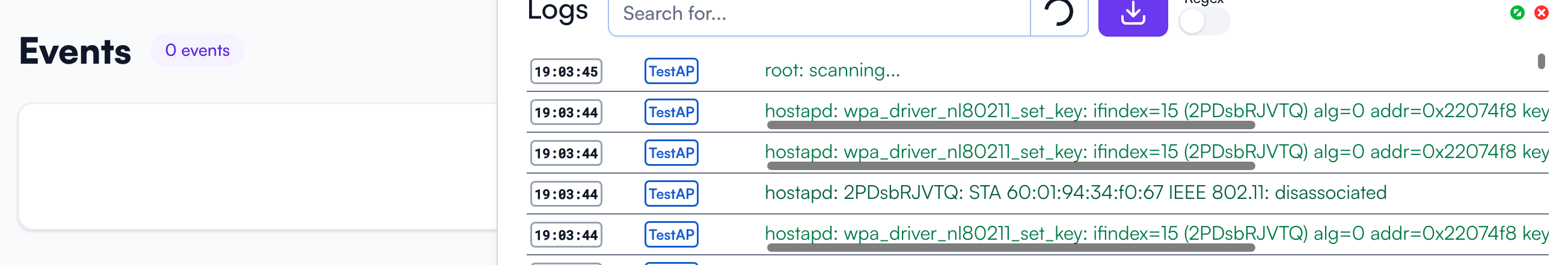

Alas, I must report something a little quirky going on. When attempting to delete IDS/IPS events from the cloud controller, they don’t seem to delete. The number of events revert after navigating away and back to the event page. This seems to be logged when when attempting to delete as well
I can confirm the same behavior. I have all devices updated to the firmware released today.
Just did an additional test on this @Alta-MikeD ; deleting events seems to work fine on sites where a Route10 hasn’t yet been updated to 1.4i. Just wanted to provide that extra bit of info :slight_smile:
We’re able to delete events just fine on our sites with 1.4i. Can you invite me to a site where you are unable to delete?
I just went and tried again… and once again it magically works now. Not sure what the problem was before.
