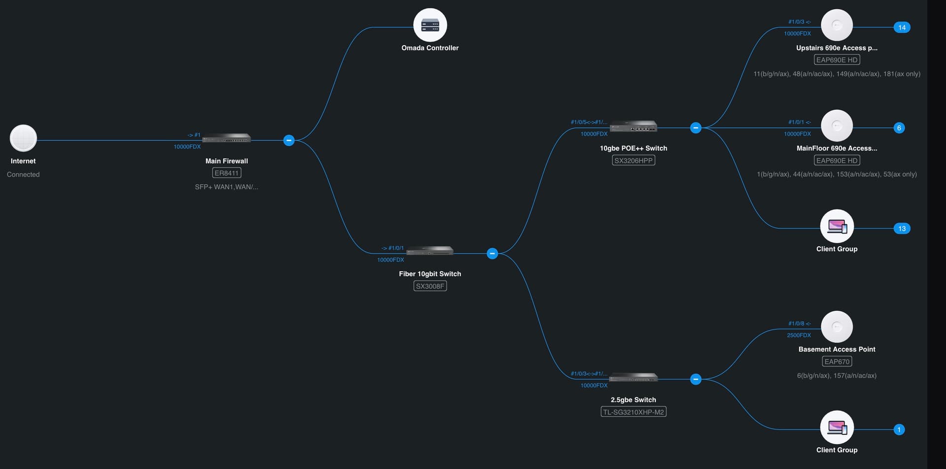

Finally got around to deploying the Route10 in my network it was comprised of all TP-Link Omada gear which I am looking to replace. Right now I have just swapped out the router nothing else
ER8411 Firewall / Router
SX3008F Aggregation Switch
TL-SG3210XHP-M2 2.5gbe Poe+ Switch
SX3206HPP 10gbe Poe++ Switch
EAP690E HD x 2 (Wifi 6E)
So imagine this without the ER8411.
Performance is currently on par with the ER8411 with IDS/IDP enabled to the highest degree on both. I have been putting this off since Christmas due to some health issues but it was a relatively easy swap and everything is currently working. Will update as I go !

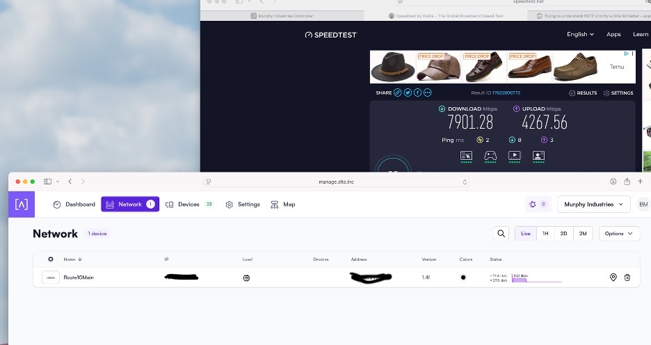

Your upload speed is far away from ‘symmetrical’ 8/8 - what’s the reason for that?
With ids/idp enabled I had the same drop in upload. Disabled and full line and than some, but both Alta and to link Omada show the same performance hit in the same spot so I see that as the nature of PPPoE
Looks like.
I guess without PPPoE there’s way more possible:
10Gb Connection speed test, Full throughput
