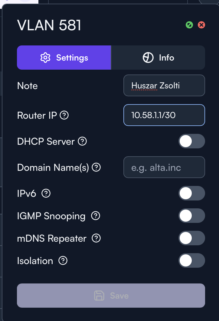

I just tested this and it let me create a /30

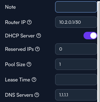

I was just able to create a /30 on my route10 without issue. One thing to check, perhaps your Reserved IPs setting is too large, and conflicts with the tiny /30 network?
Below are the settings I used:
Hmm, it appears we have a couple validation cases that need to be fixed. We’ll get this cleaned up. Thanks for reporting!
