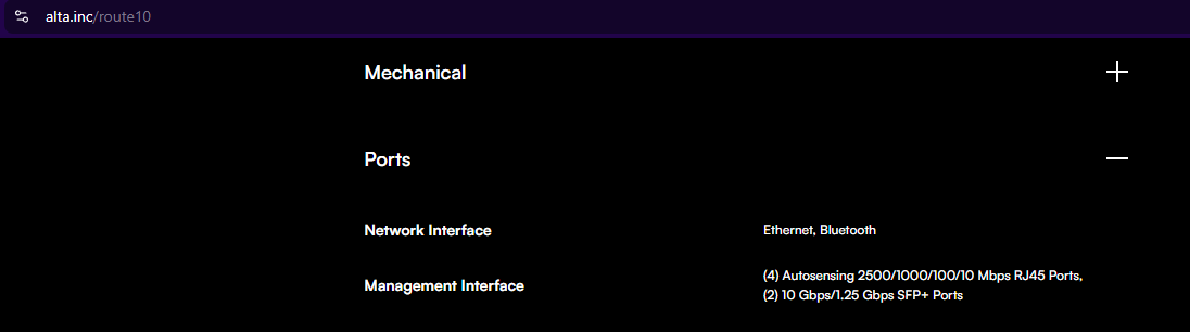

We do not officially support GPON modules at all, although some may work fine, assuming the module presents standard Ethernet to the host (ONT-on-a-stick type modules).
That said, we do not support 2.5Gbps optics (approximately 3.13Gbps SerDes rate). We only support 1Gbps and 10Gbps optical modules (1.25Gbps and 10.3Gbps SerDes rates). The only way to leverage 2.5Gbps or 5Gbps data rates via the SFP+ port would be to use an NBASE-T RJ45 SFP+ module.
Here are the specs:
