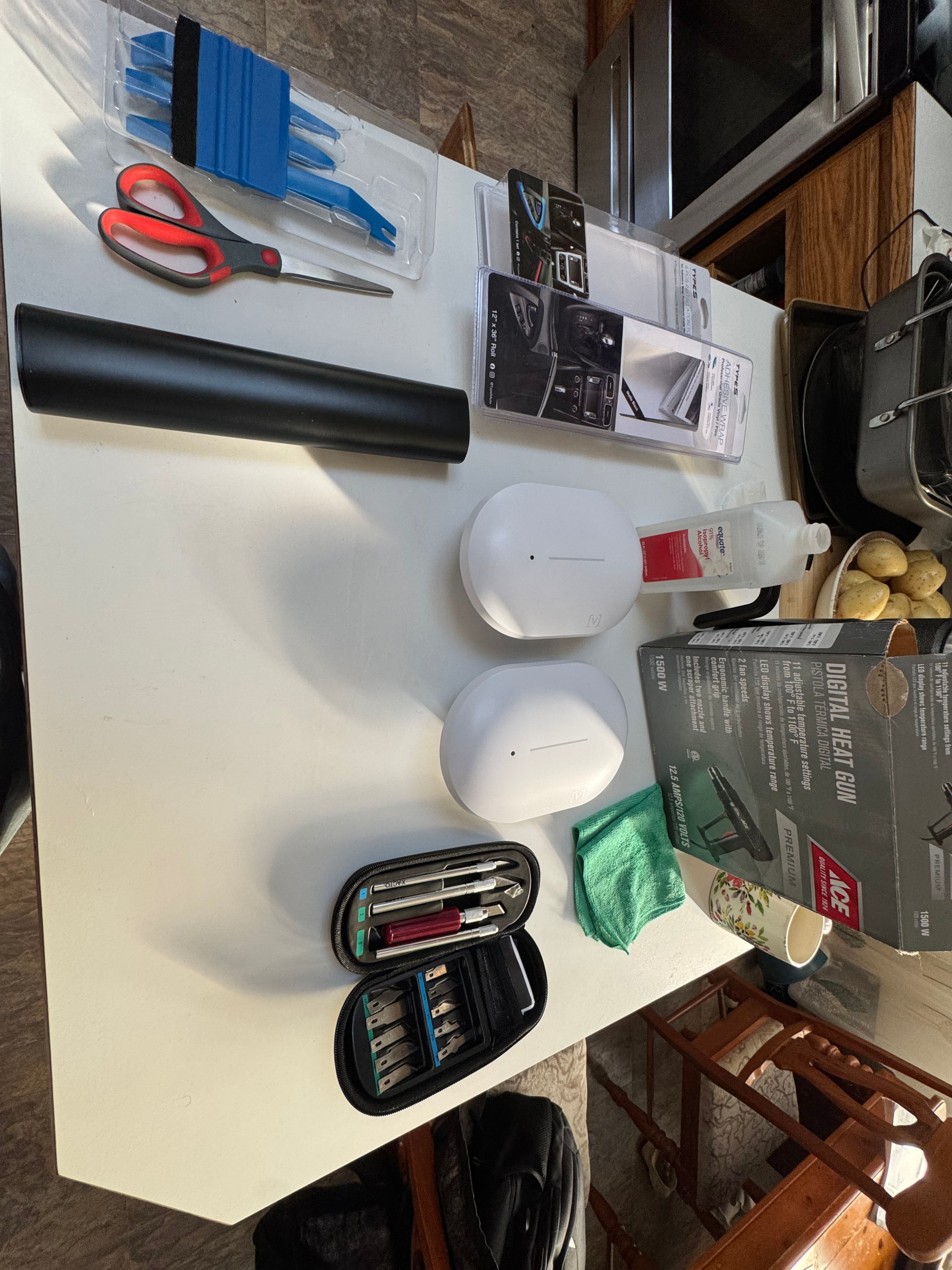

We went with Type S premium cast vinyl (Matte Black) — the same professional-grade film used in automotive and marine wraps.

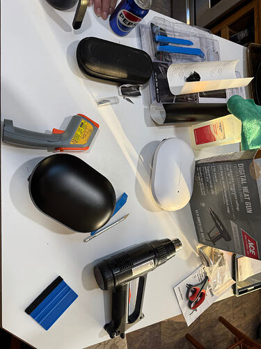

  • Wrapped only the top radome — left the aluminum heat sink untouched.
  • Used a digital heat gun, precision knives, and squeegees for a perfect contour fit.
  • Post-heated to around 220°F to set the film memory.
  • Cleaned and prepped with isopropyl alcohol (≥90%) beforehand.

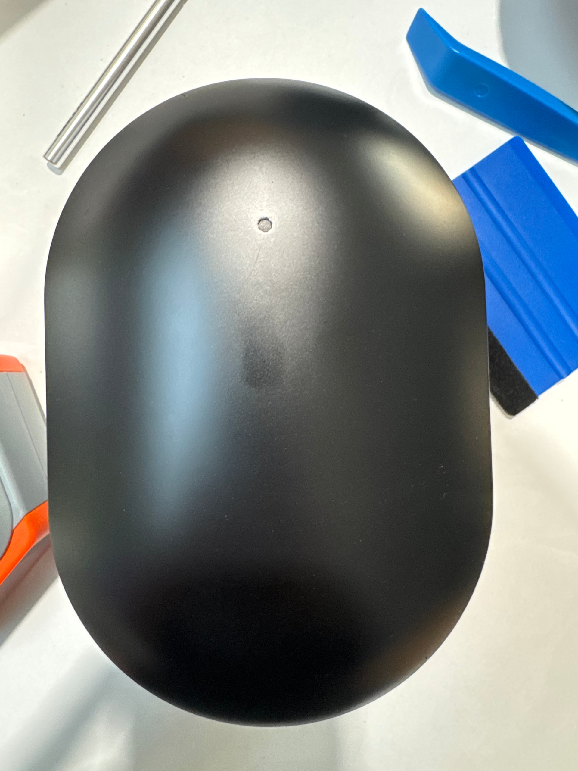

The result? Factory-quality matte black that looks like it shipped that way from Alta Labs.

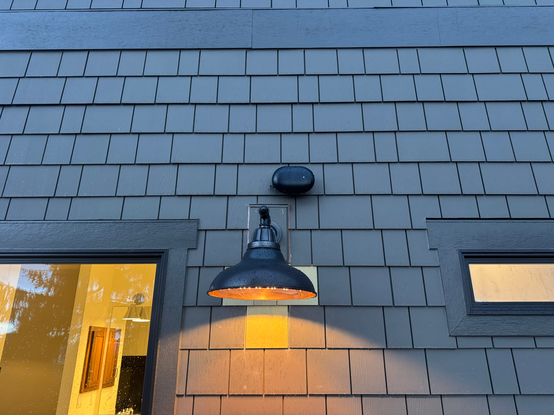

:bullseye: The Result:

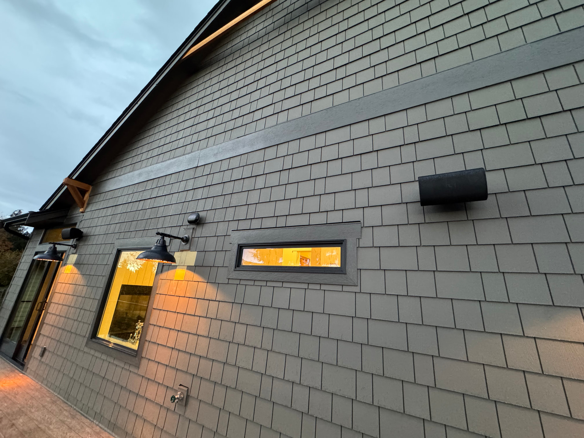

Now the AP6-PROs disappear perfectly against the dark siding — right alongside the black outdoor speakers (yep, we swapped those too :upside_down_face:).
