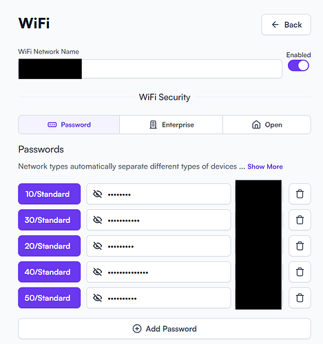

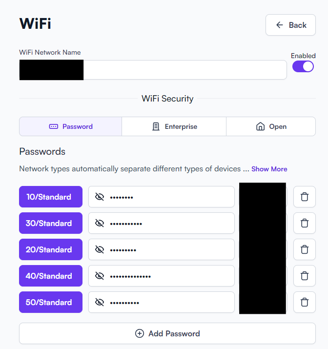

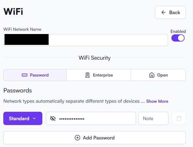

Could you share a screenshot of both the working configuration as well as the non-working configuration, please? (Of course, blur/mask passwords as needed)
Yup, here are two screenshots - one shows the SSID with AltaPass in use and the other an SSID with just a single password.
AltaPass:
Single Password:
The other settings are identical between the two.
Happy to give you access to the site if you want a look further, I still have some Ring devices on the “with AltaPass” SSID to try to see how often they have a problem before moving them to the single password SSID.
