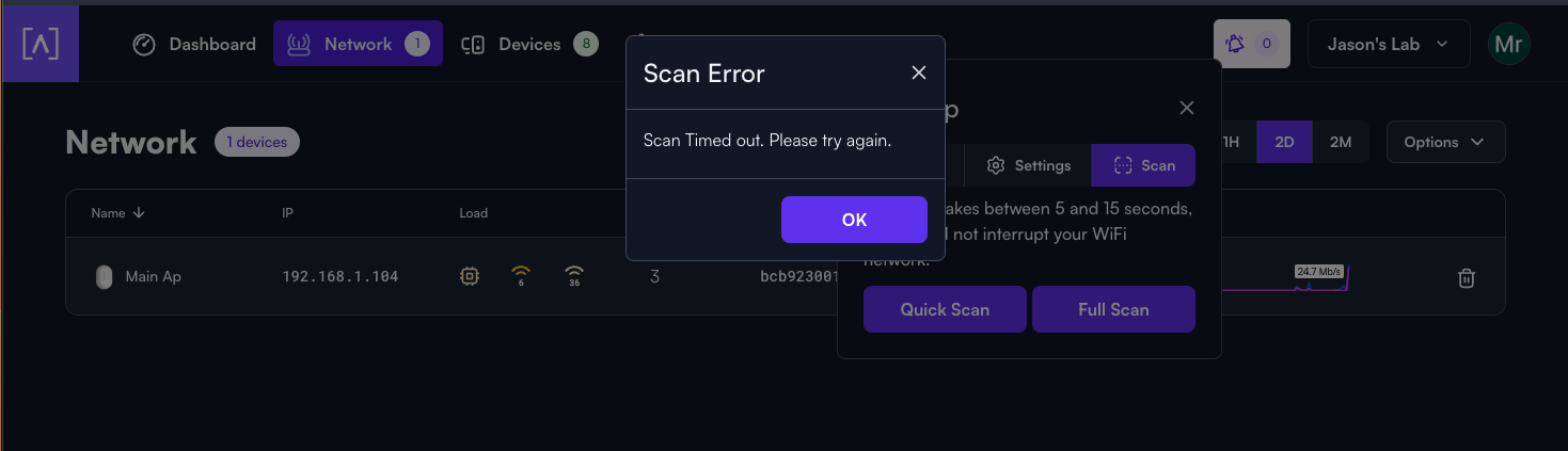

Quick scan - Full Scan doesn't work
I searched the forum, but can’t see anything or any posts about the Scan not working. Am i the only one ?
Tried both but get same error with time out.
Tried connecting to the network with the ethernet then logging back into the portal same thing, tried it connected to network with wifi still same.

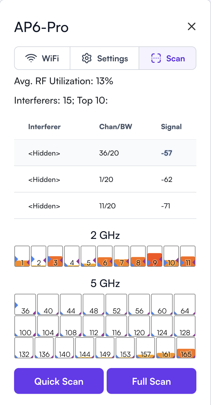

Working for me. AP6-Pro running 1.1f. Firefox browser on MacBook Pro.
