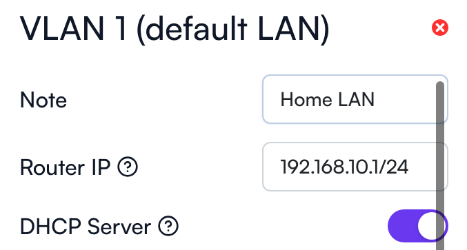

Route10: DHCP - can you currently disable DHCP on the router? I would like to point to a third party DHCP server.

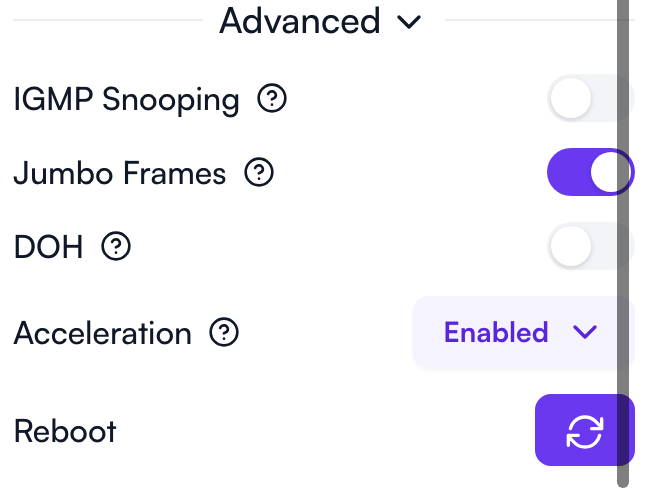

Route10: Can you restart router via GUI?

  • Yes, DHCP can be disabled per network (per VLAN basically):
  • Yes, that’s available in the router settings under advanced
