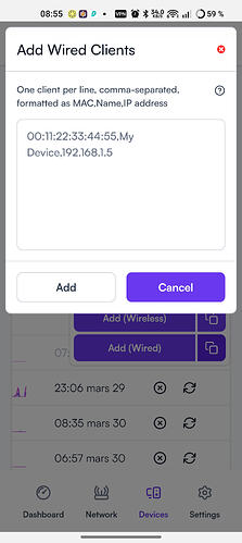

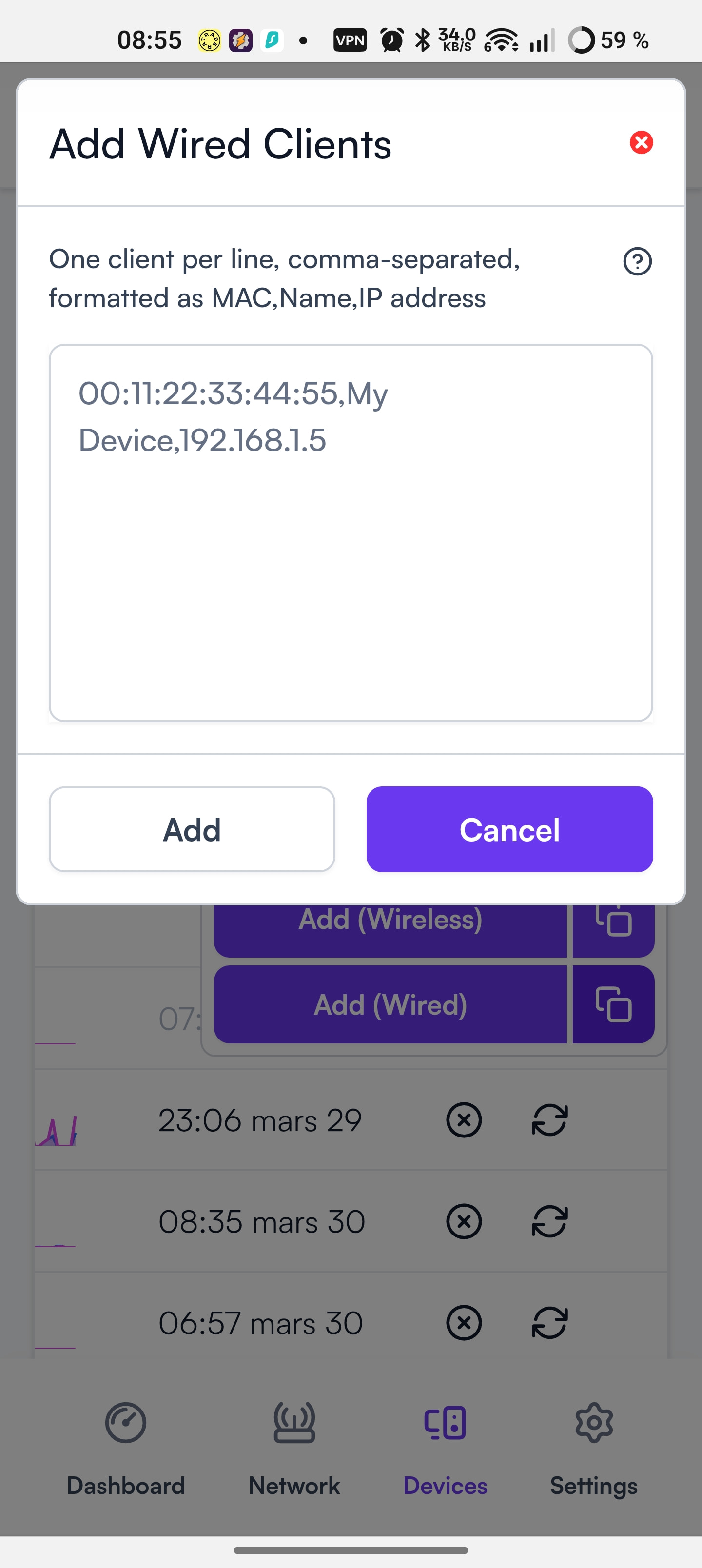

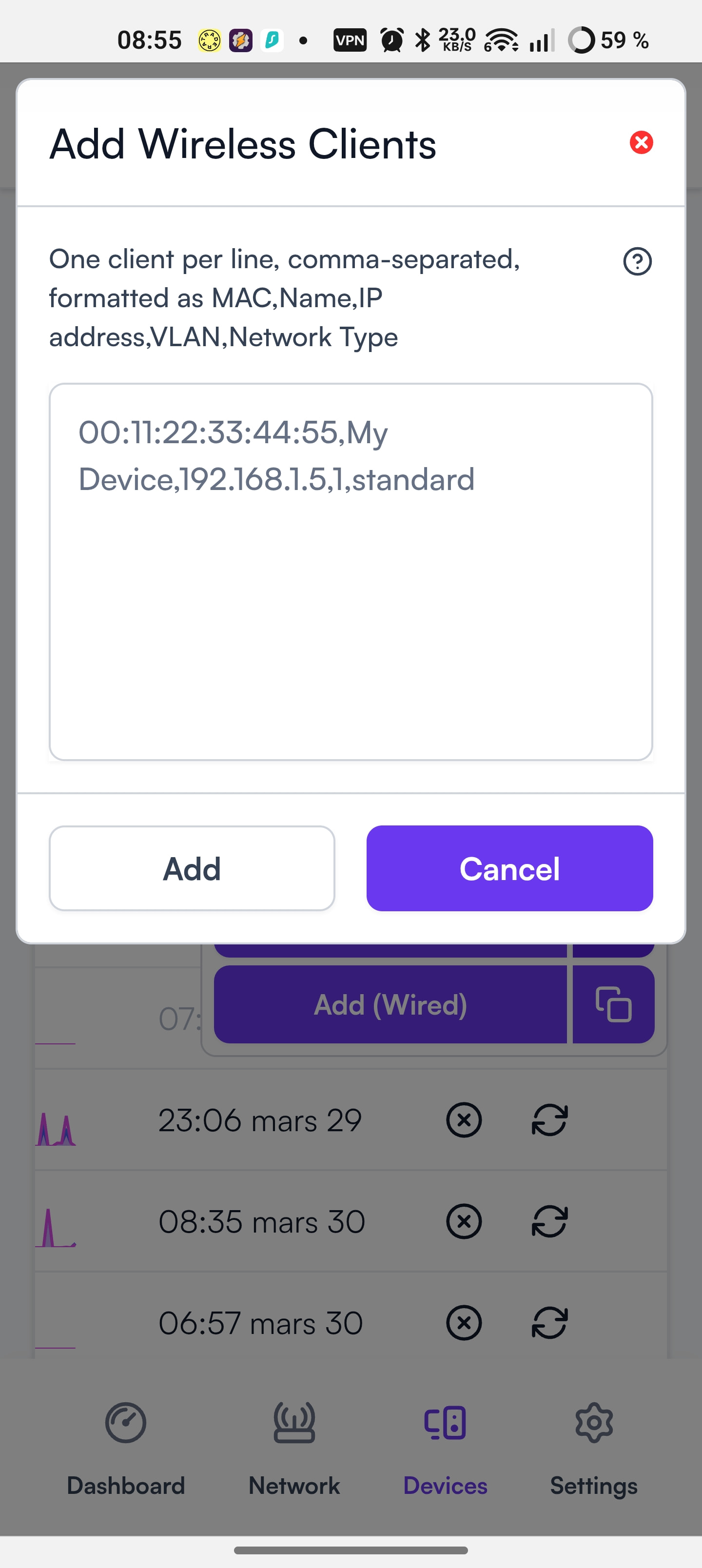

  1. DHCP management
Bulk entries are available. See online help article.
https://help.alta.inc/hc/en-us/articles/35073566347803-How-to-Reserve-DHCP-by-MAC
and attached screenshots of bulk add via Devices in Cloud UI.

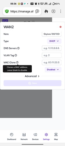

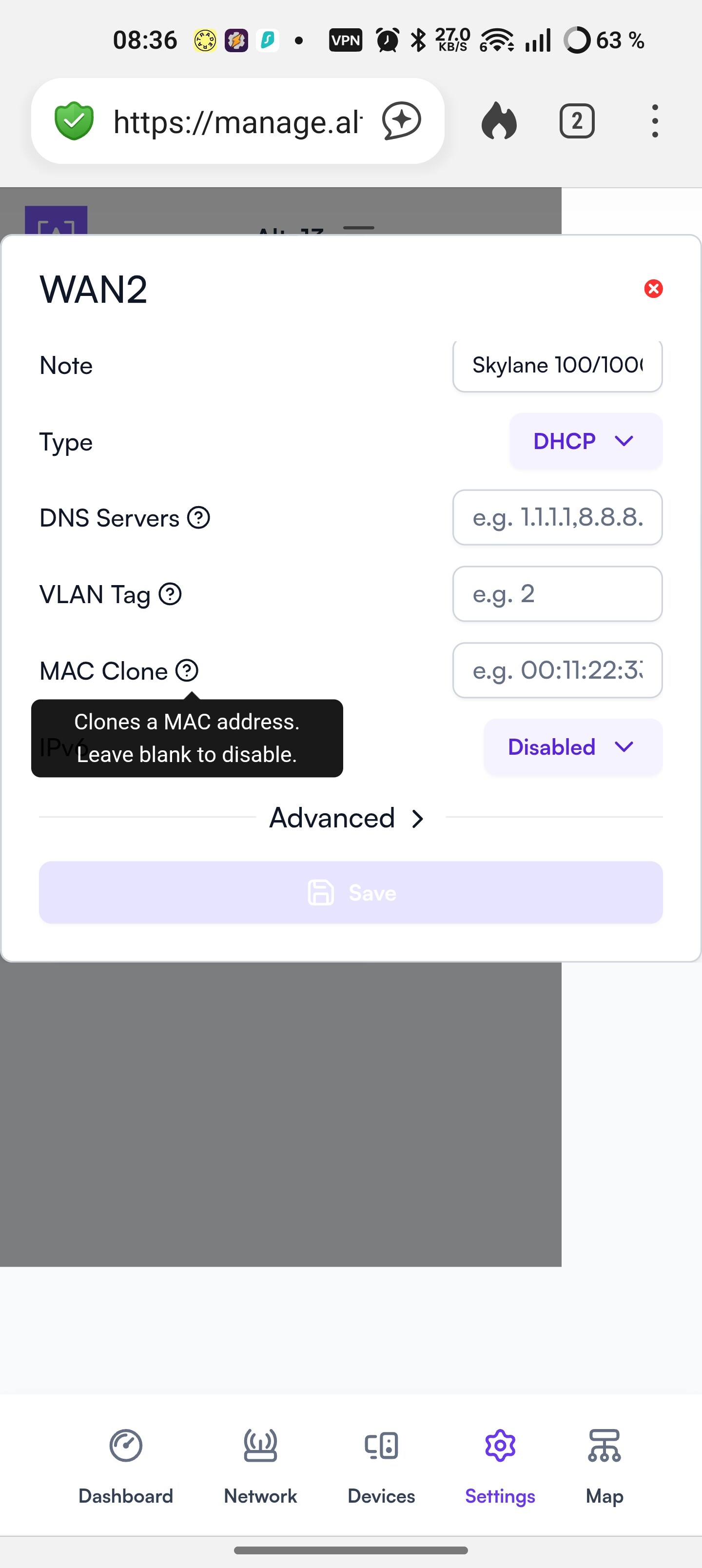

  1. MAC Clone:
Should be available. See online help article.
https://help.alta.inc/hc/en-us/articles/33805681985435-Route10-Initial-Setup
and screenshot of WAN config for Route10 viu Cloud UI.
