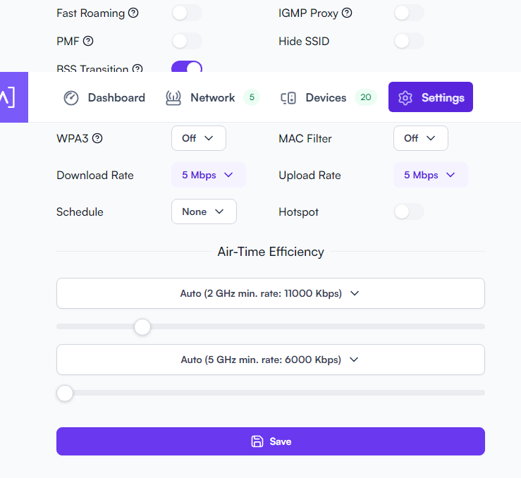

It looks like the dropdown closed when you took the screenshot of your configuration, so I’m not sure what your limitations are set to. Could you clarify that, please?

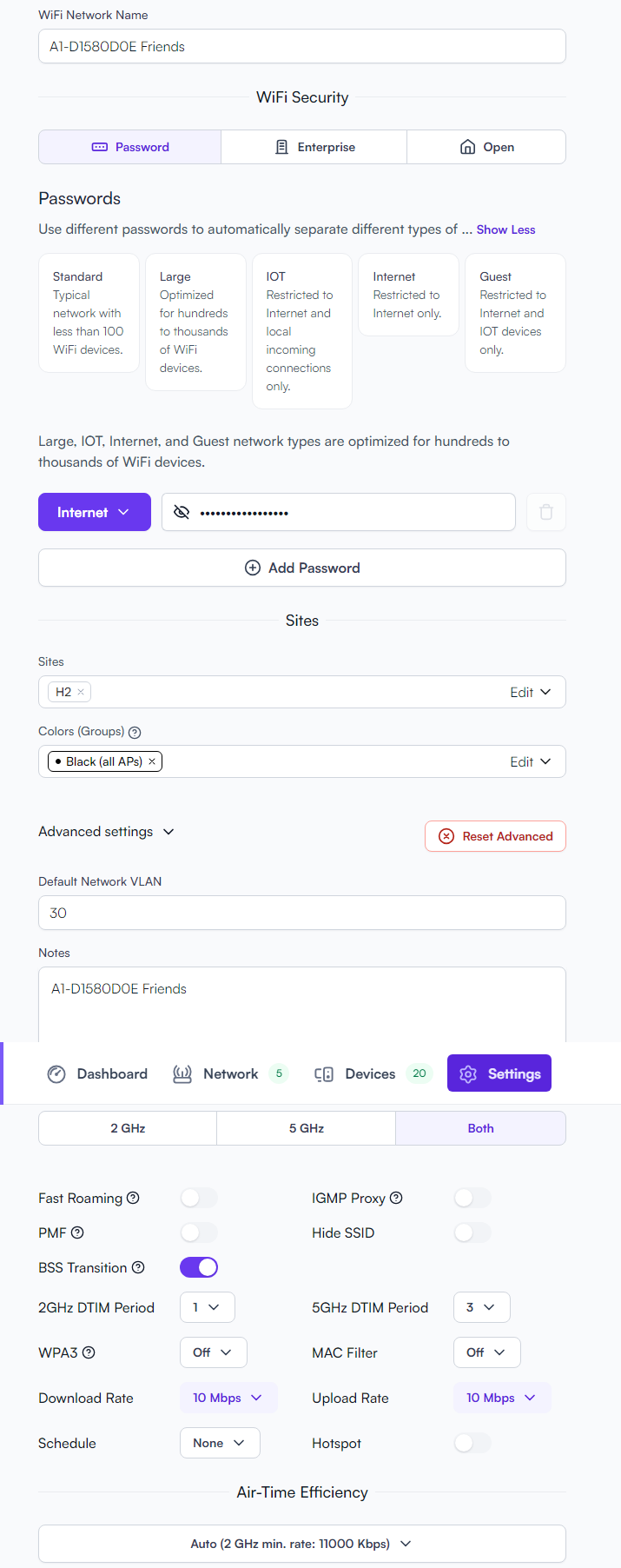

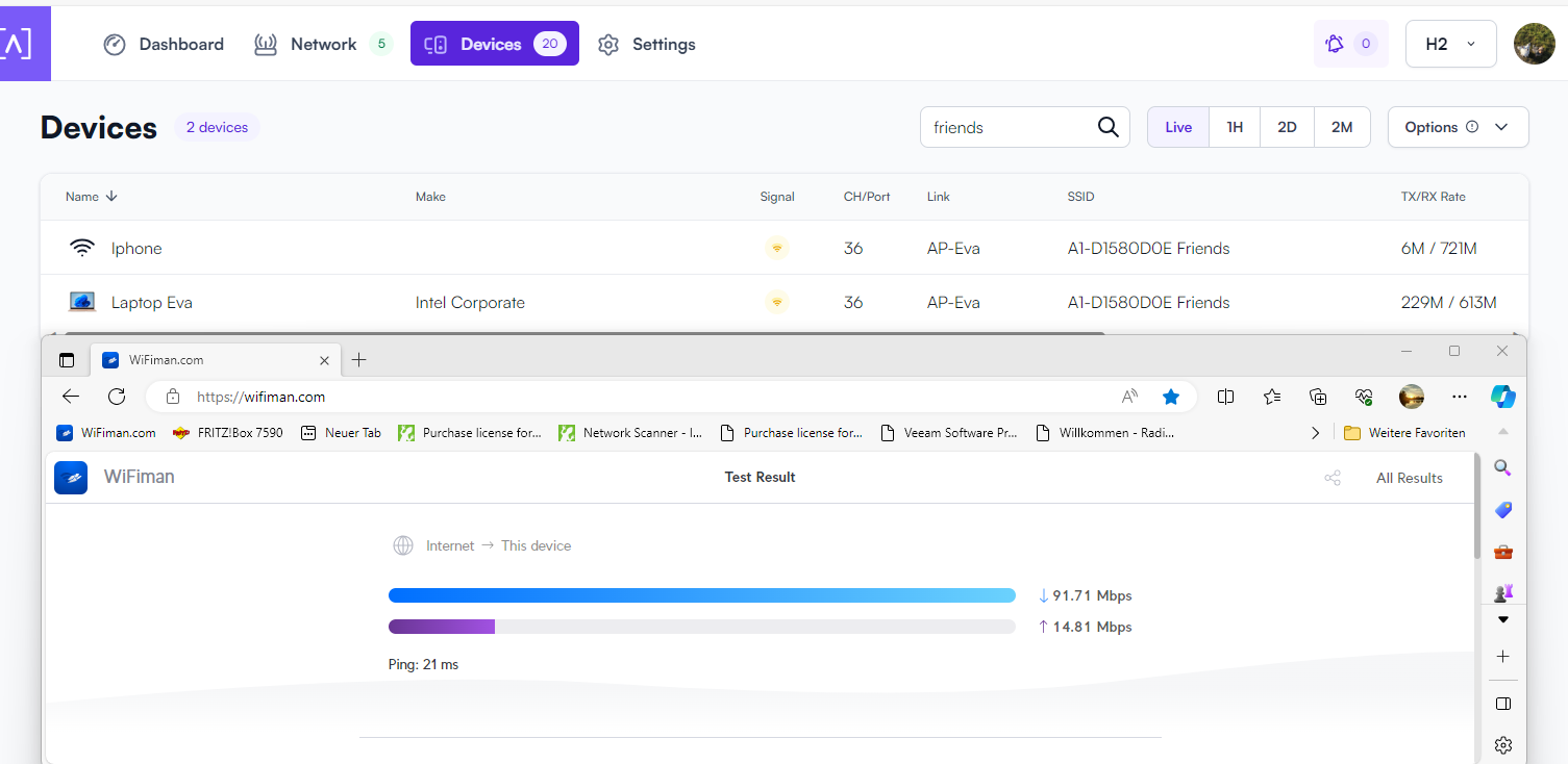

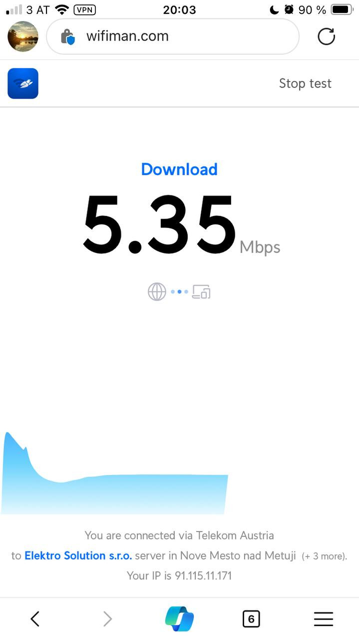

I have now done a test, it works on the mobile phone. unfortunately not on the laptop. see screenshots… have saved the settings at the access point. I’m using both devices in the Friends Wifi.

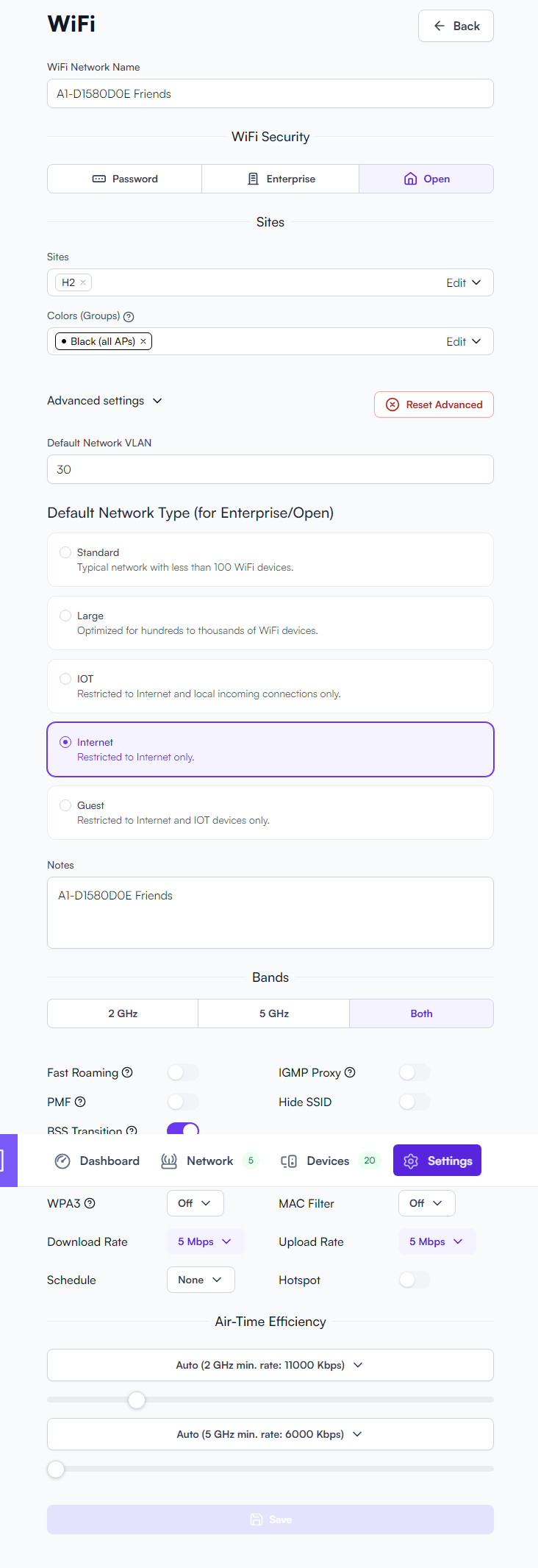

have now created a wifi without a password. on the mobile phone I have the set value. but laptop unfortunately doesn’t. See screenshot
I have reconnected both devices to the wifi. No password required

I have restarted the Access Point. On My iPhone the Limit is still exist. On My win11 Laptop i became the Full Speed of My Internet Speed.
