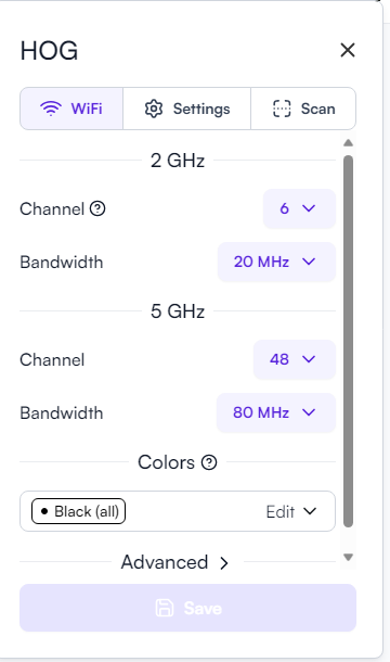

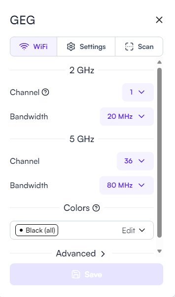

I have 2 AP6-Pro access points, if I run them with 160Mhz - 5Ghz I have various problems, even with the wifi settings when I set them to automatic. currently I run the access points with the following settings
maybe any of you have any tips so I can use the DFS etc. Unfortunately, most devices then halve the bandwidth or other problems occur. Report Devices, Wi-Fi Disconnect, Wi-Fi Connect, etc…
