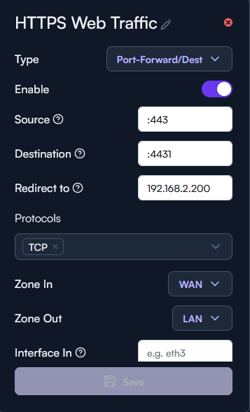

So.. I’ll admit I’m not a network engineer though I’m a Systems Engineer.. I generally know a lot about networking but I’ve never configured higher level stuff from scratch. The thing is though I’m apparently not understanding something as I’ve been attempting to do something as basic as forward 443 https traffic from the wan to my webserver and I cannot seemingly pull this off. I weirdly was able to forward something else but 443 seems to be refusing no matter what I do. Am I missing something? Do I need to make filter rules for each port forward? The thing that works has no filter rule so that wouldn’t make sense. I looked through other topics but they seem to get resolved without really stating a solution and I find it crazy I’m having this issue. I’ve been wanting to move to alta from my AXE16000 since a @Unflawed basically did the feature request themselves that forwards domains via vpn.

Basically, you need to leave everything as default except for:
  1. Set destination to :443 (WAN TCP port you want to forward)
  2. Set Redirect to to your web server
  3. Select TCP protocol
  4. Set Zone out as LAN (optional)

I guess re-reading it a few times… it does make sense but I guess I’m just not used to this wording. I assumed the source was the interface/port(wan) and you could get specific and that the destination was the port(destination you were wanting to send it) but guess I should of asked why “redirect to” was a thing as well..

If I could query you a little further. I did what you show here on the internal routing but the problem is the device it’s routing to as you can see with the port forwarding is a different port.(443 is used for something else on this host) How would you go about hitting the correct port if it just is basically using a host file type situation.
If you want to do a different port on the LAN side, just change it on the Redirect to value, i.e. 192.168.1.10:4444
