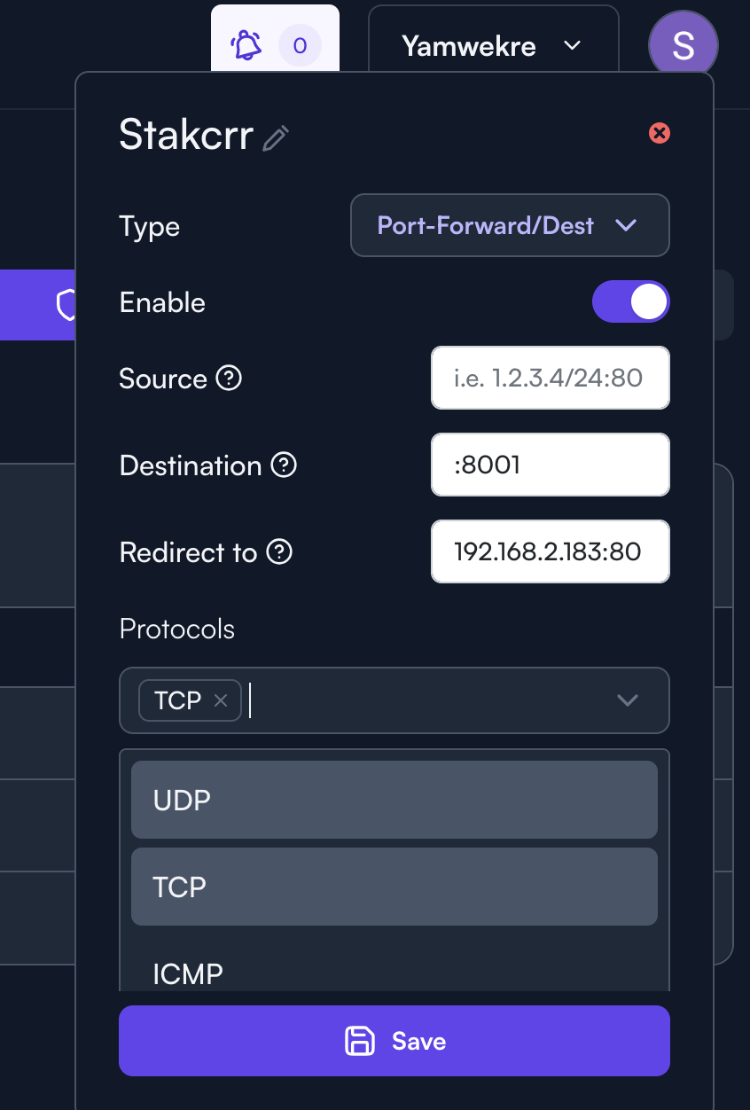

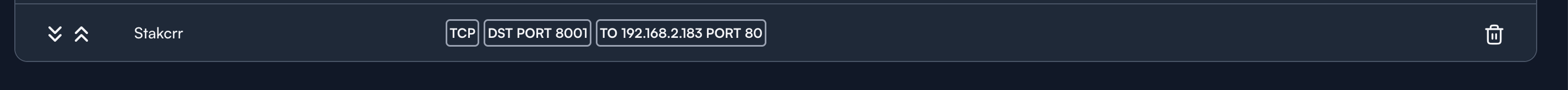

I use Route 10 last version firware. I can access my three services (three servers with different IP addresses) that are broadcasting on port 80 from my local network, for example, http://192.168.2.183:5. But I can’t access them via the WAN (http://ddns-server:8001). When I try to access them, I’m redirected to my router How can we solve?
My Port Forwards config

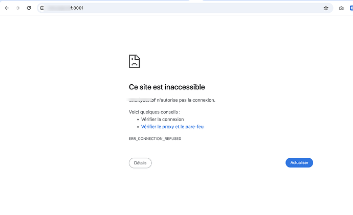

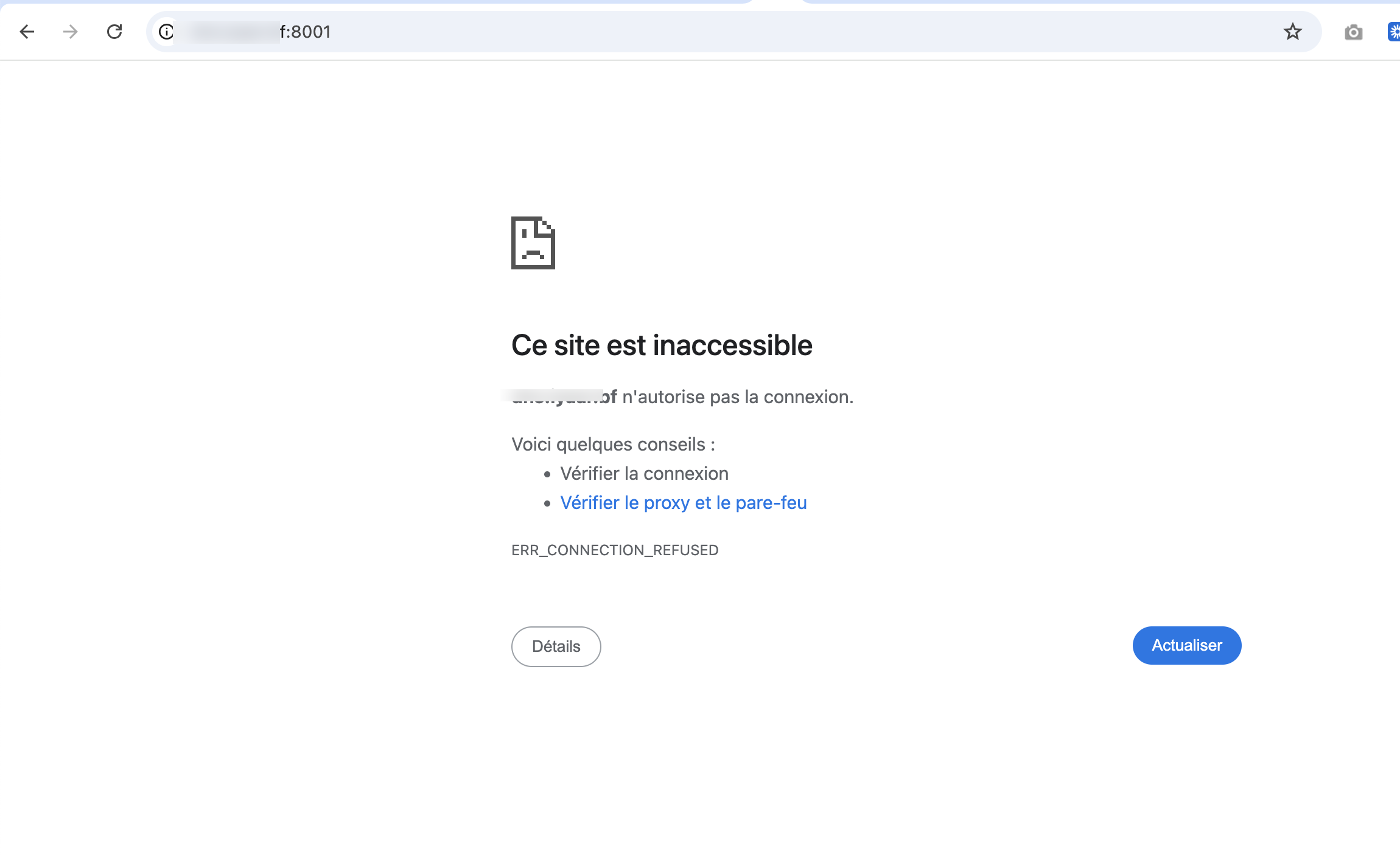

Look the pictures now it is same. Internal and external network. can not connect
