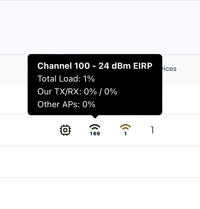

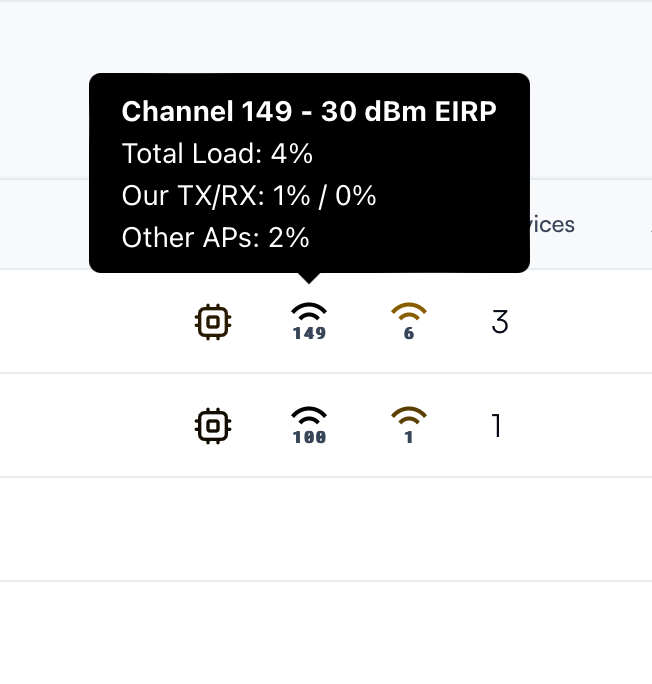

Hello, a few questions here.: As you can see pictured - 2 of my access points both run on CH36 at 5G, yet one displays an output of 30dBm and another on 23dBm. Any idea why these differ so? I can confirm the AP at 23 dBm has noticeably worse performance than that running at 30 dBm, so I believe what the UI is telling me. Both APs are set to the High power setting for 5G band.
I have changed channels and can’t seem to achieve 30dBm on any of my APs except the one at 30dBm. Whilst changing channels and playing around, I also notice a serious degradation in performance, using anything other than channels 36 through 48. To achieve over 170mbps throughput I need to be on 36-48 or it’s just not happening. Any advice would be appreciated. TIA Alex

Probably a bug - the maximum is supposed to be 23dBm on 36 to 64?
To get 30 you are normally in the 100 to 140 range of channels?

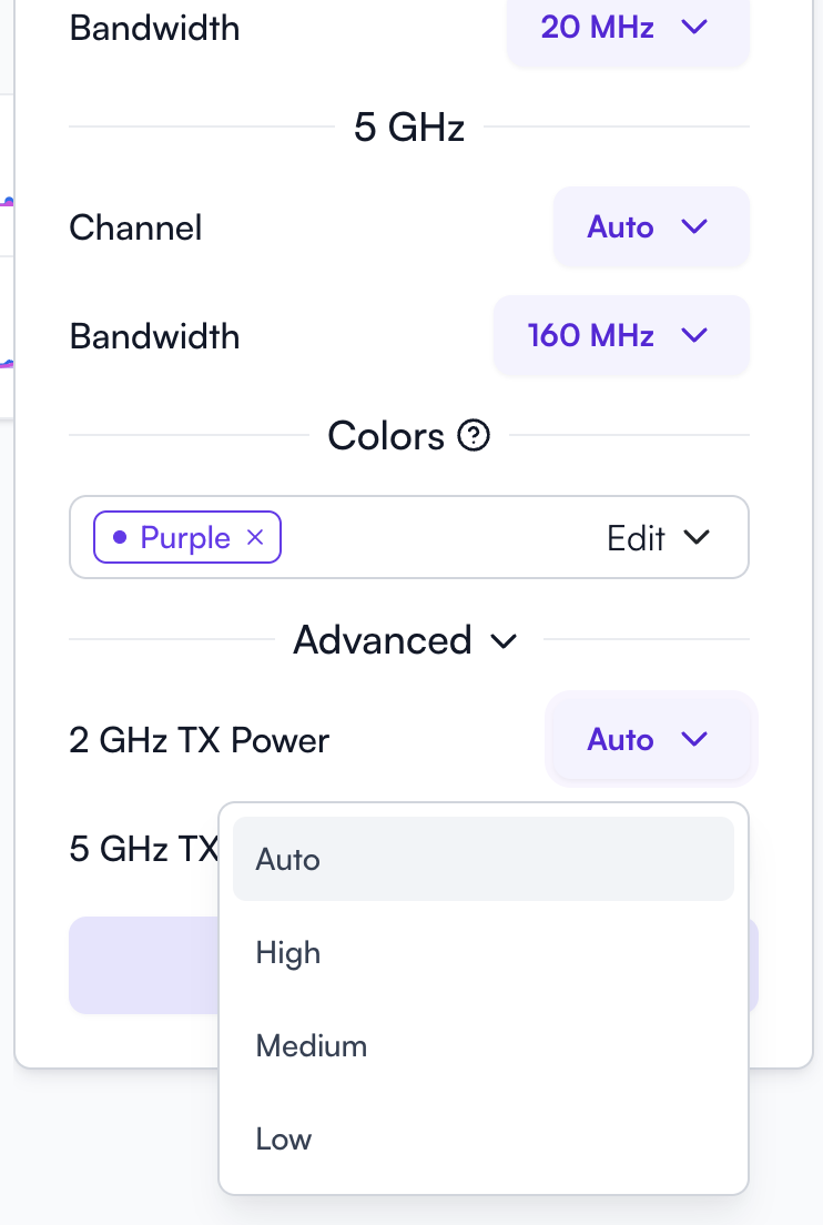

Hey @MarzBar any chance you can share what settings you’re using? Have you tried changing manually to “High” power setting?
I had thought this - why I’m bringing attention to it. I really could do with the extra power but then comes my next problem. Changing the APs to these higher channels does not result in the output power changing from 23 to 30, it stays the same as you can see here. The next problem is the reduced performance above 64. I cant seem to get anything more than 200mbps at a push with the higher channels.

Hi Matt, thanks for the reply. As mentioned in the post the APs on both 23dBm and 30dbm are both on High output power.
