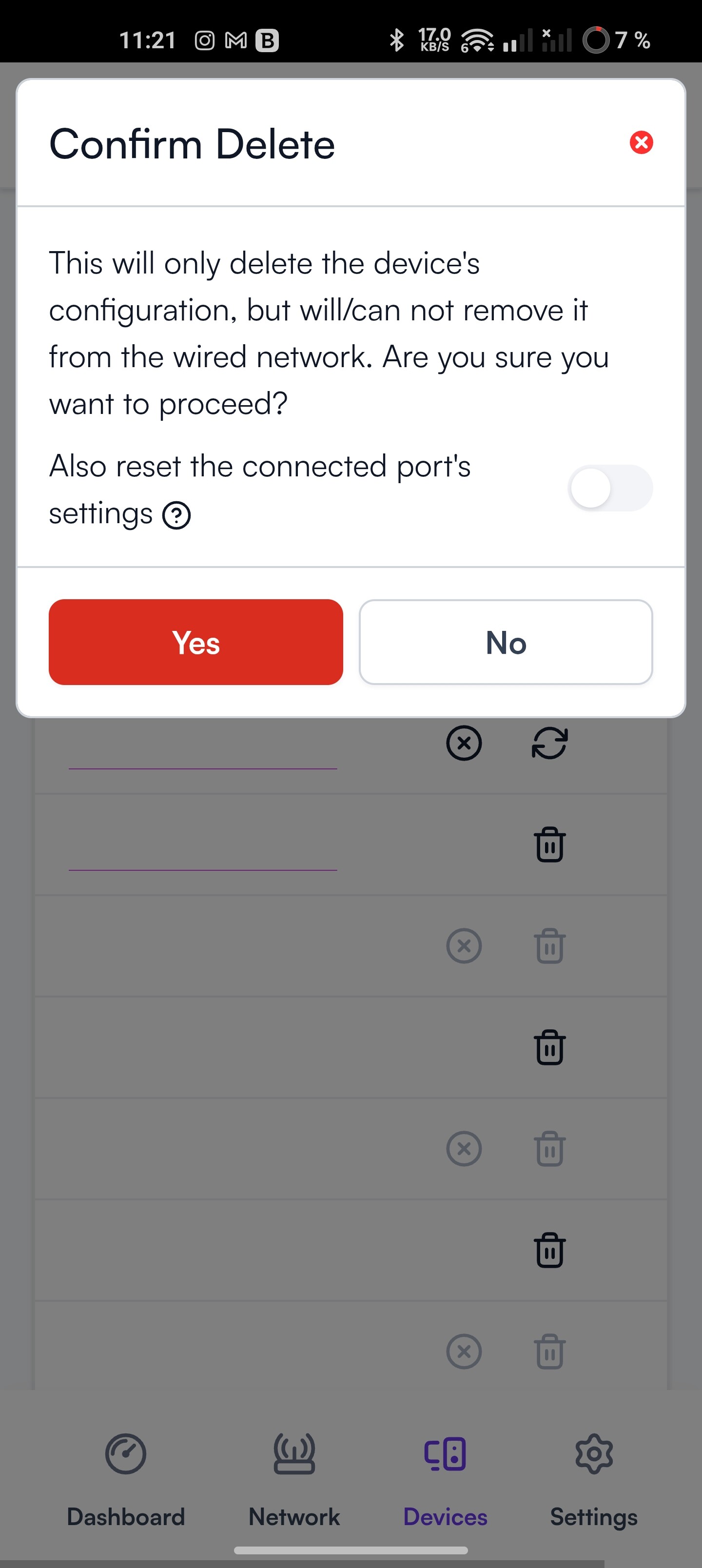

The latest (?) Control-update introduced a safeguard against removing an active (wired?) device from the device list, which strangely pops up here for the WiFi device:
They (the devices) stay in the devices list also after trying to remove them. IP remains as the previous DHCP IP and it strangely shows up as associated to the default VLAN instead of the correct one.

So, this might possibly be one or more related or completely unrelated issues/bugs to the devices list:
  • WiFi device is interpreted as wired.
  • WiFi device is stuck in devices list, and can not be removed (via the Trash-bin button and the following pop-up).
  • The pop-up text and slidebar selection and info is not relevant for a WiFi device.

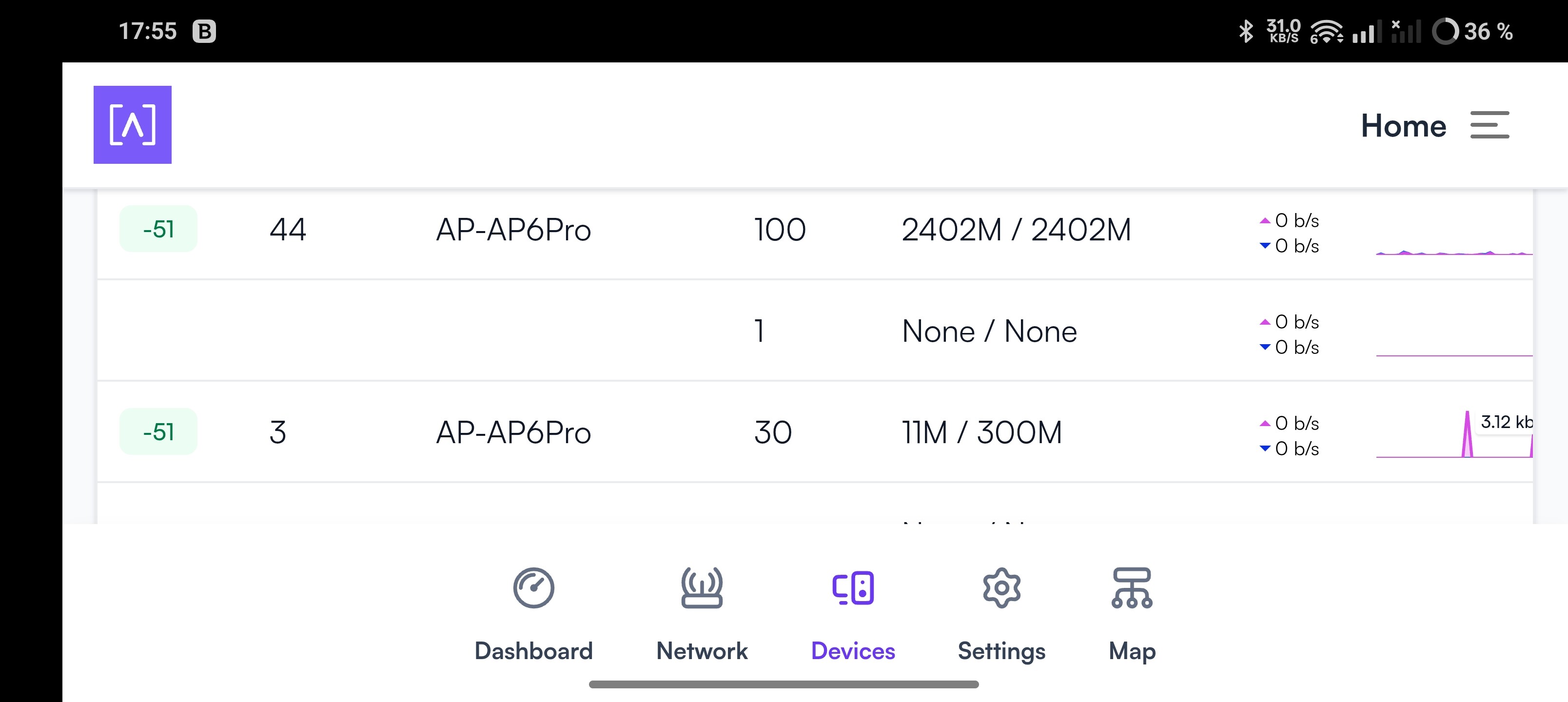

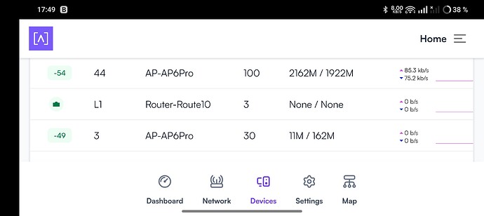

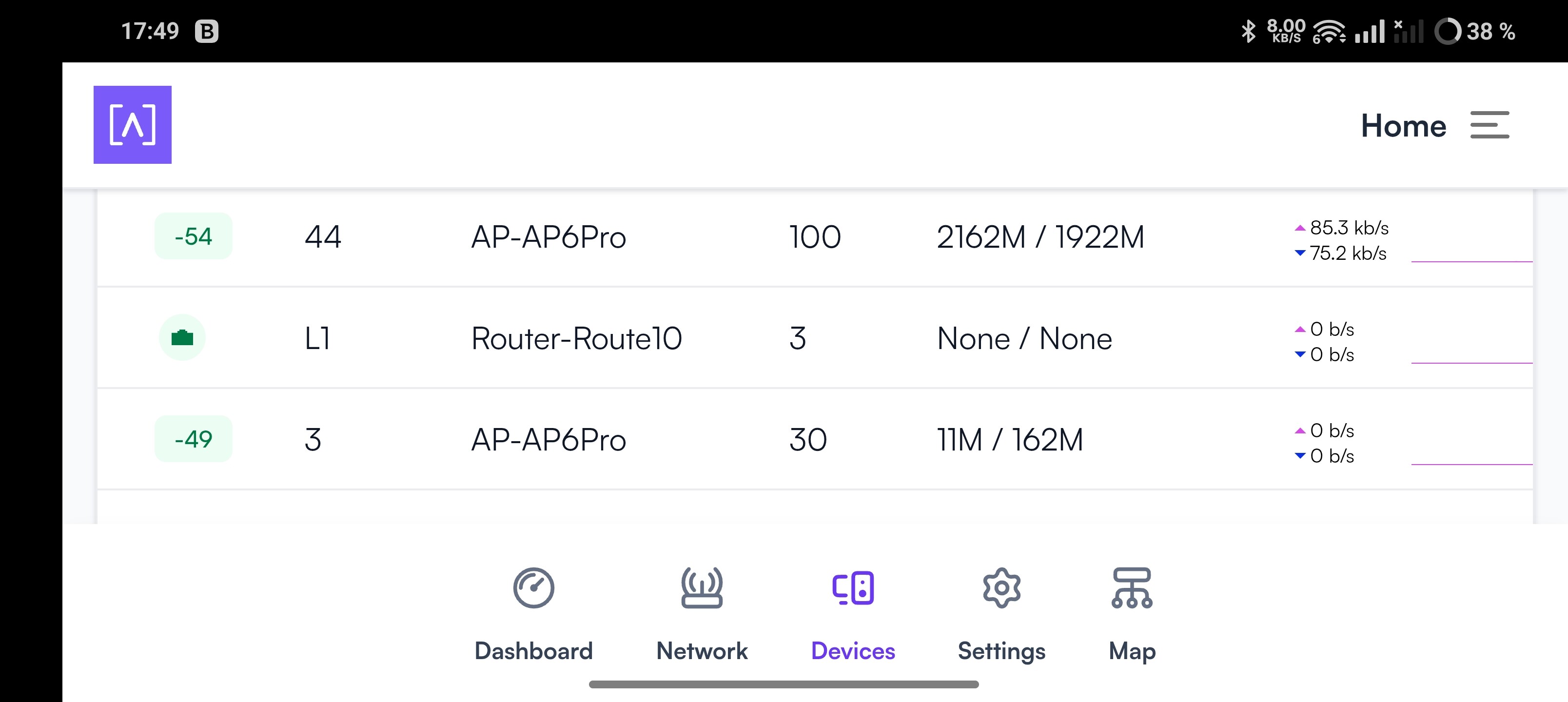

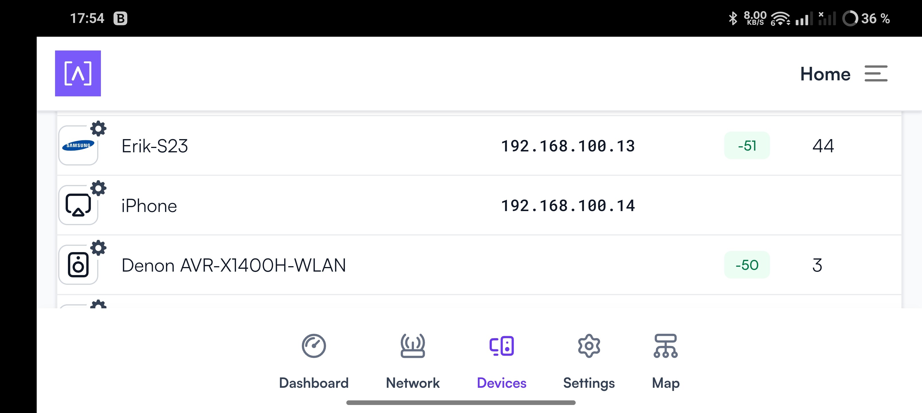

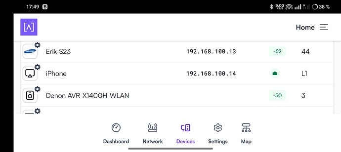

Update on this one for input to Alta troubleshooting:

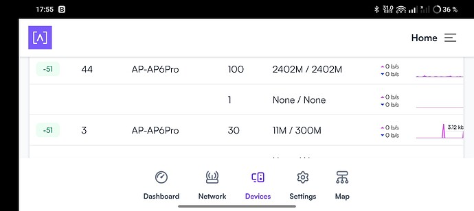

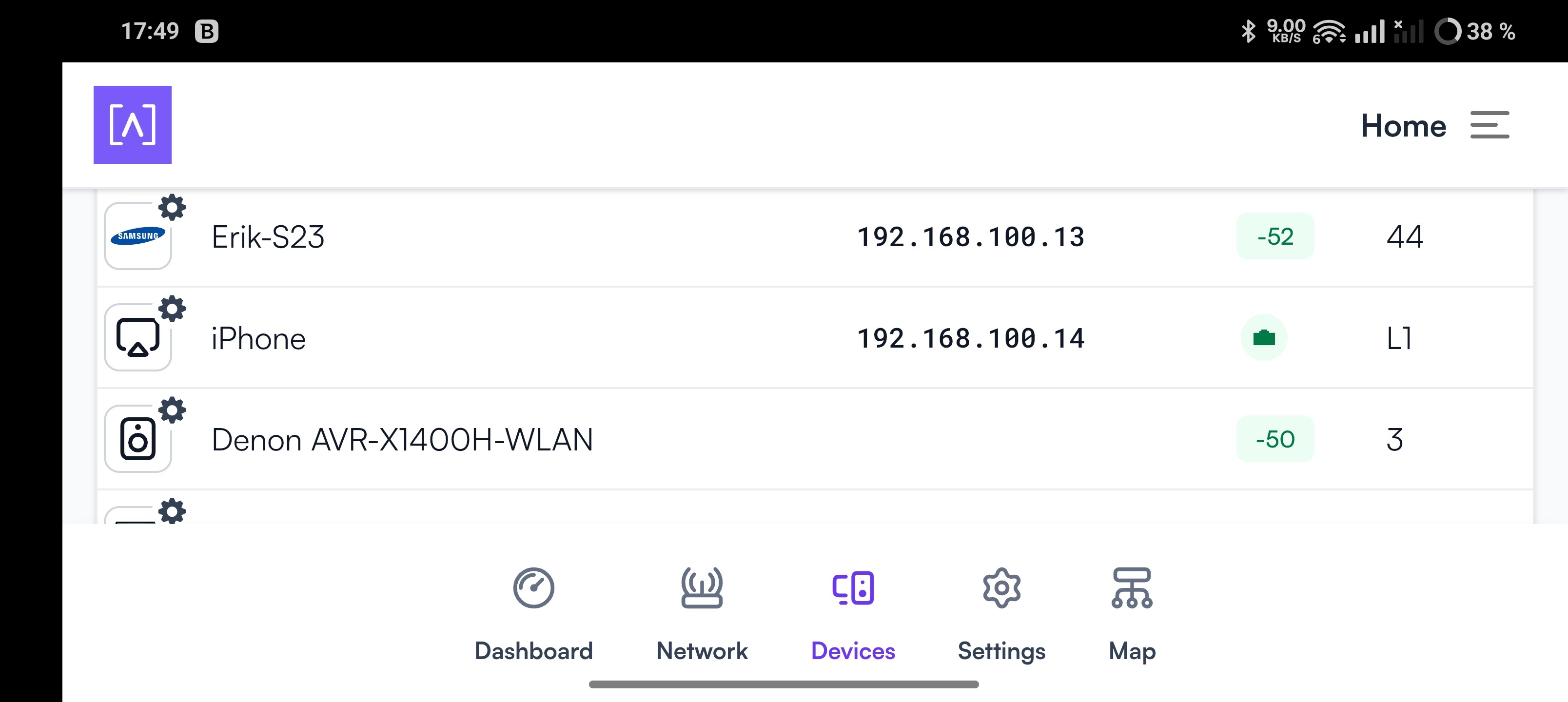

One device (iPhone) re-appeared in the network and then disappeared (wife coming home and leaving again). The line content turned gray, whereby it became possible to perform a WiFi forget device with the Trash-bin. But, it then re-emerged as a wired and active device, attached to L1 on Route10 (where associated AP is connected) and with a bogus VLAN, see screenshots:
Then after a short while Signal, CH/Port and Link turned blank and reverted to default VLAN again:

I’ve noticed the same issue on my MacBooks after a recent macOS update. My guess is that the “Private Wi-Fi Address” feature in macOS might be causing a conflict with the Alta controller. It seems that Alta registers the same device twice: once with the randomized MAC address as a WiFi connection and again with the actual (hardware) MAC address as a “wired” connection. However, the “wired” connection always appears as “active,” even when the device is asleep, despite no actual network activity being registered. Removing the “wired” device doesn’t work as Alta will automatically pick it up again. I have had these entries for a few weeks already, so it doesn’t seem like it will get dropped automatically.
