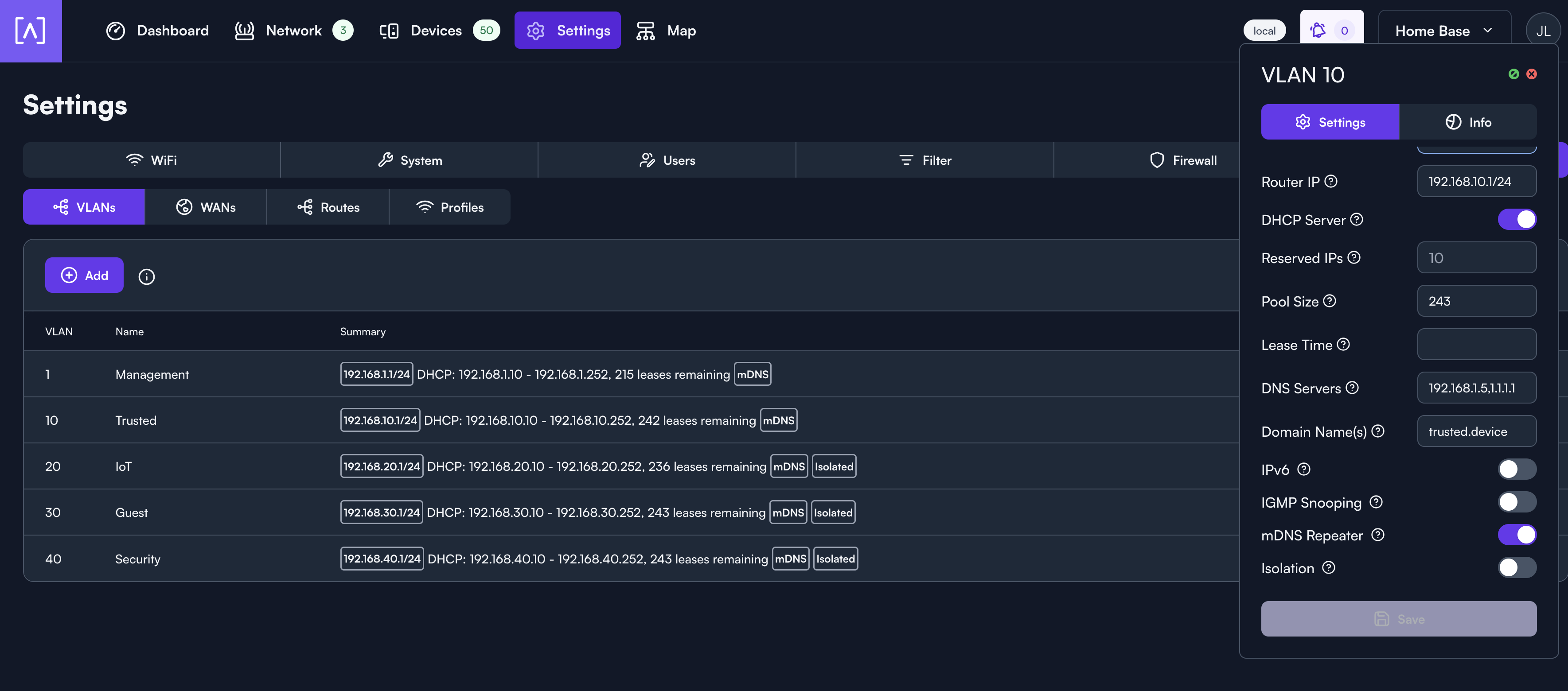

I’ve setup 5 VLANs, management, trusted, IoT, guest, and security, made firewall rules so that every VLAN can access my PiHole for DNS and their respective requests show up in the query log of my PiHole but nothing can access the internet except for the default management VLAN. Devices show up in the device list with proper IP’s, can ping local devices, be pinged by devices in VLAN 1, yet cannot go to google.com or any website.

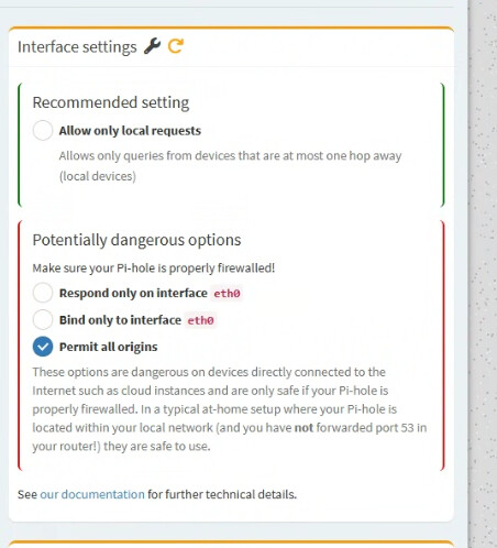

Make sure this is on so pihole can listen on more than the default interface.
This is under settings, dns, and advanced.
Yep, was one of the first things I had enabled.

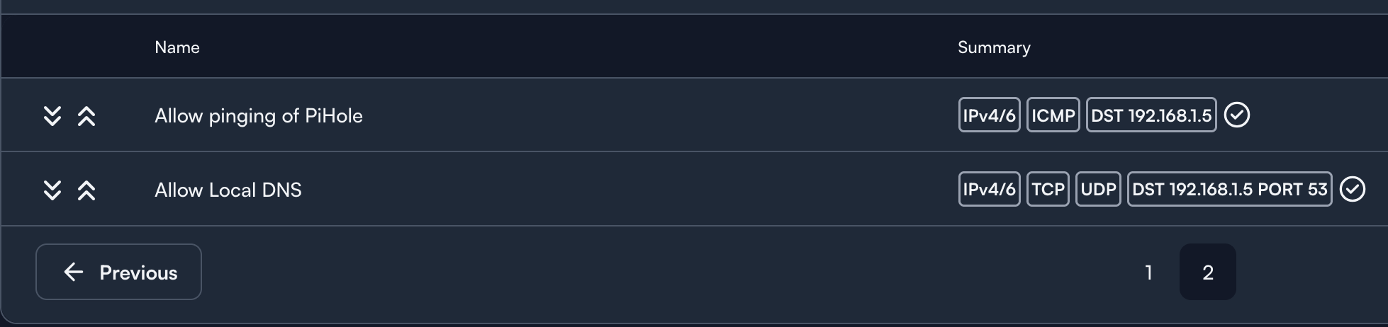

Does your rule look like this? Mine works like this
Also make sure the allow is before a rule that is blocking traffic from that lan if you have one. Order usually matters.
Mine looks like this and I don’t have any rules blocking traffic yet since I can’t even get the traffic flowing yet :sweat_smile:

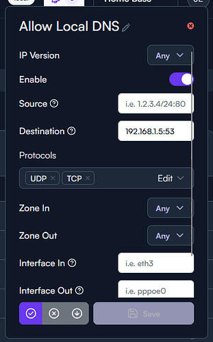

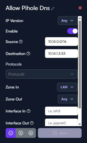

Regarding the Allow local DNS rule, it should perhaps be changed to Zone in = LAN, as WAN would otherwise be included.
