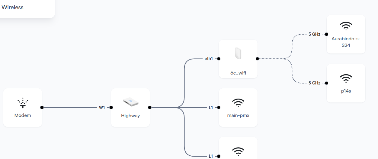

Just installed my Route10 wired + AP6W wireless access point. In my previous Wifi Router setup, I used to be able to access local clients using “hostname.local” name. However it does not work in this setup. The following is my network map:
I’d like to access main-pmx from p14s. What settings do I need to change?
One quick thing is I believe the Route10 defaults to .localdomain instead of .local. So hostname.localdomain should generally work instead of hostname.local, although that could be changed to local in the network settings if you want :smiley:
Thanks a lot! Your comment reminded me that I had DNS over TLS configured. After removing custom config, I am to resolve the hostnames directly.
