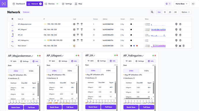

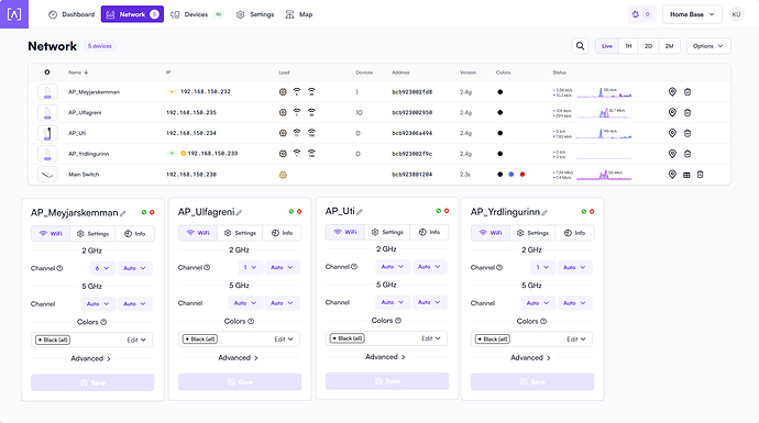

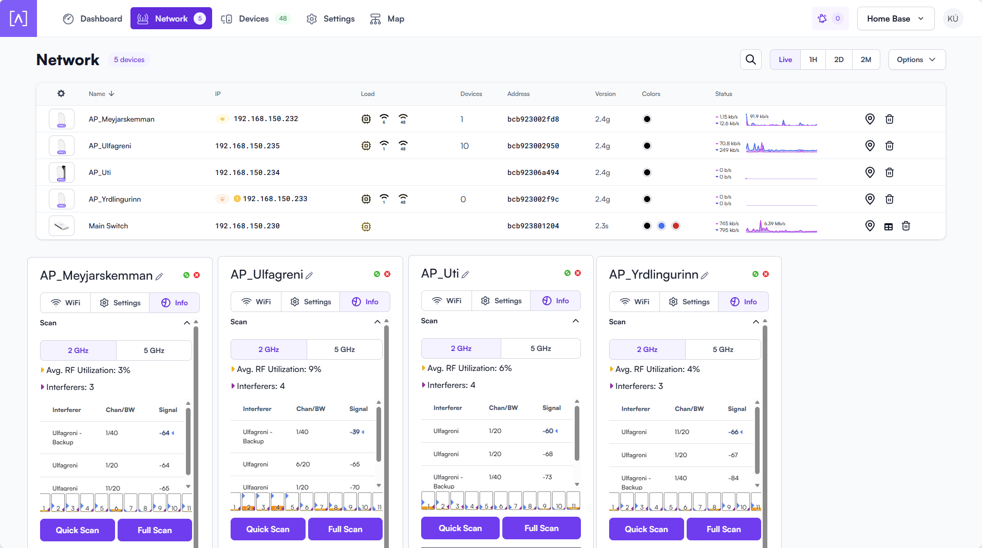

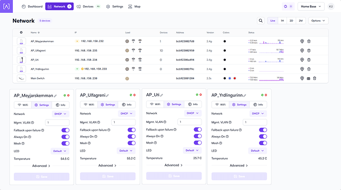

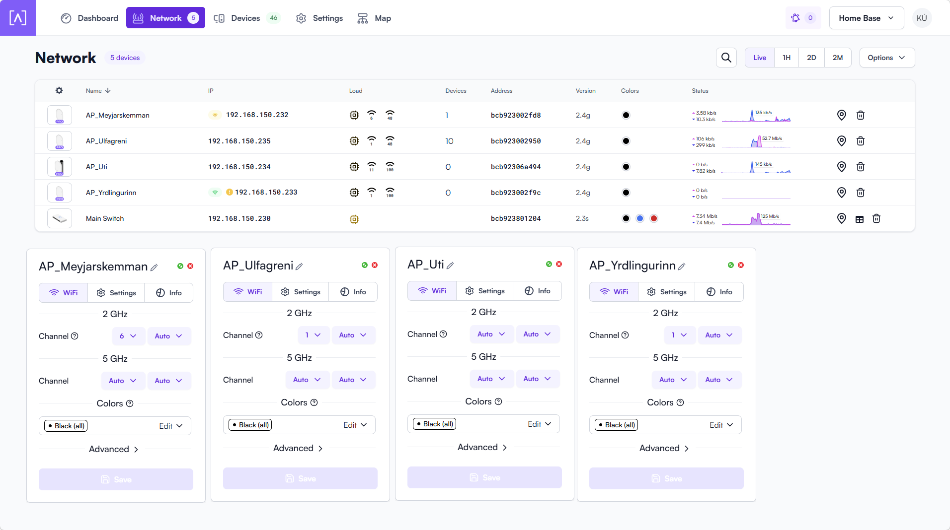

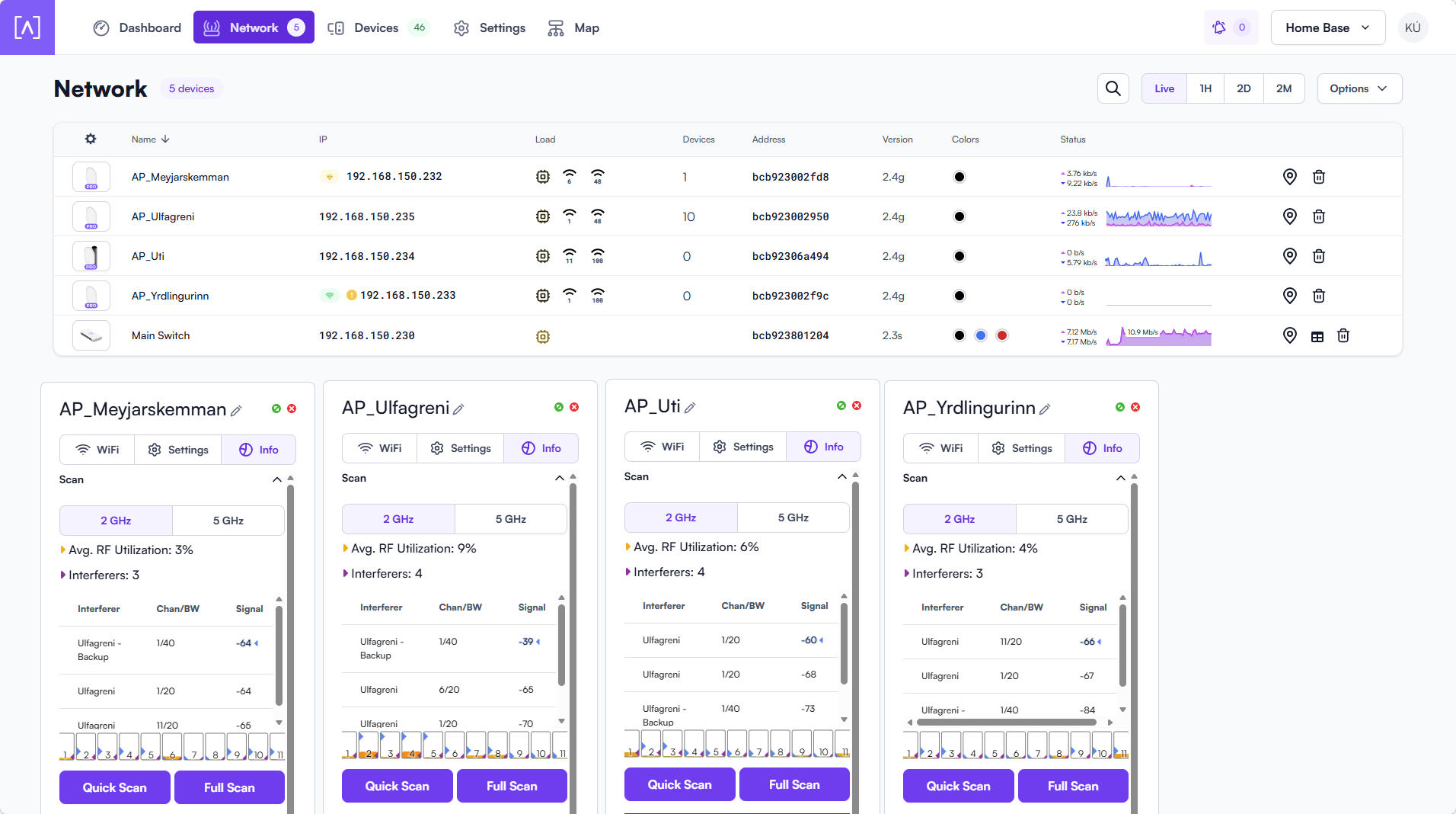

Here are some screenshots from when it worked on Cable and one where I had disconnected the cable.
Summary
All APs are up to date on FW.
Any thoughts on what could be wrong?
EDIT: I brought it in, it will not even connect there via Mesh, within 3 meters line of sight. Therefore I conclude that it will absolutely not mesh, but if connected via cable, it will mesh with other APs.
Could this be a lemon device? Any thoughts on how to further check on this?

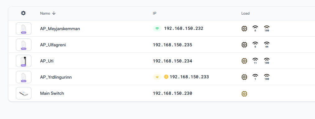

I have not tried that. I as under the impression that the APs would arrange things by setting them on Auto. I do notice that the outdoor AP (that is currently on a cable) has now connected to 2 of the other APs on channel 100. However, the AP that is closest to it in distance (about 1.2 meters) is on channel 44.

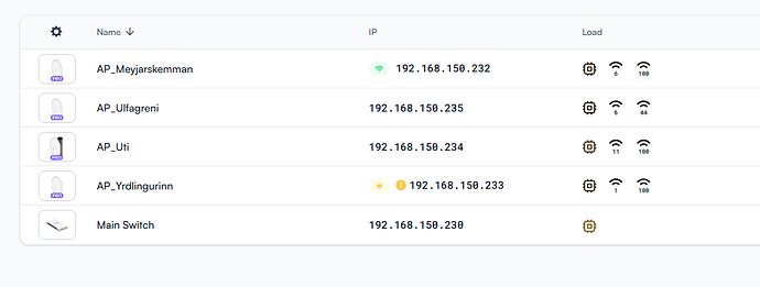

This is the current connection setup:
If you set the AP that is closest to the Outdoor to channel 100, then the others on Auto, then you should be good.

I moved it to the roof and connected it. At first, it did not connect, so I did a full scan, which seems to have enabled it to join. I therefore recommend that is done.
