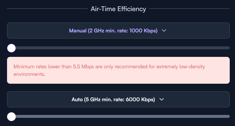

Welcome to the club! I had trouble connecting my Pixel to the 5Ghz network as well. I corrected this by going to Settings, selecting my network, dropping to Advanced Settings and adjusting the Air-Time Efficiency all the way to the left as such.
I’m not sure if it helped any, but I also set 5Ghz to bandwidth 160 on the network device setting on the AP

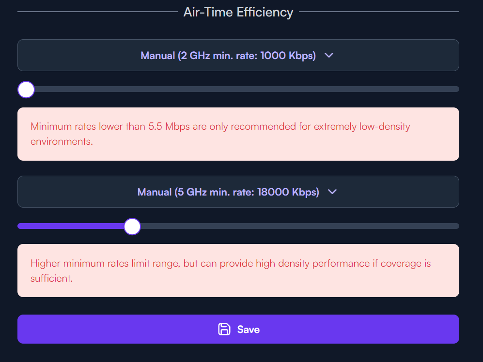

Think I figured it out with manually upping the 5ghz setting and now the phone is connecting fine everytime on 5ghz. Guess I would like to know is 18000 too much or too little to get the best out of these AP’s?? I always tweak all of Unifi AP’s and other brands too but I need to know the best tweak settings for Alta AP’s?
In my opinion you are very close to the AP and the signal is WAY too high. The antennas on these bad boys are really good. I bed if you were that close and turned the 5Ghz down to low, it would work without the need for that change.

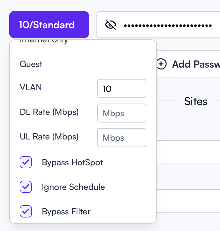

Also, for your SSID, I would suggest going in and enabling all three bypasses.
Yes Rutman286! I went and mounted it for testing and turned the settings back to auto and phone connects fine now to 5ghz about 40’ away from it.
