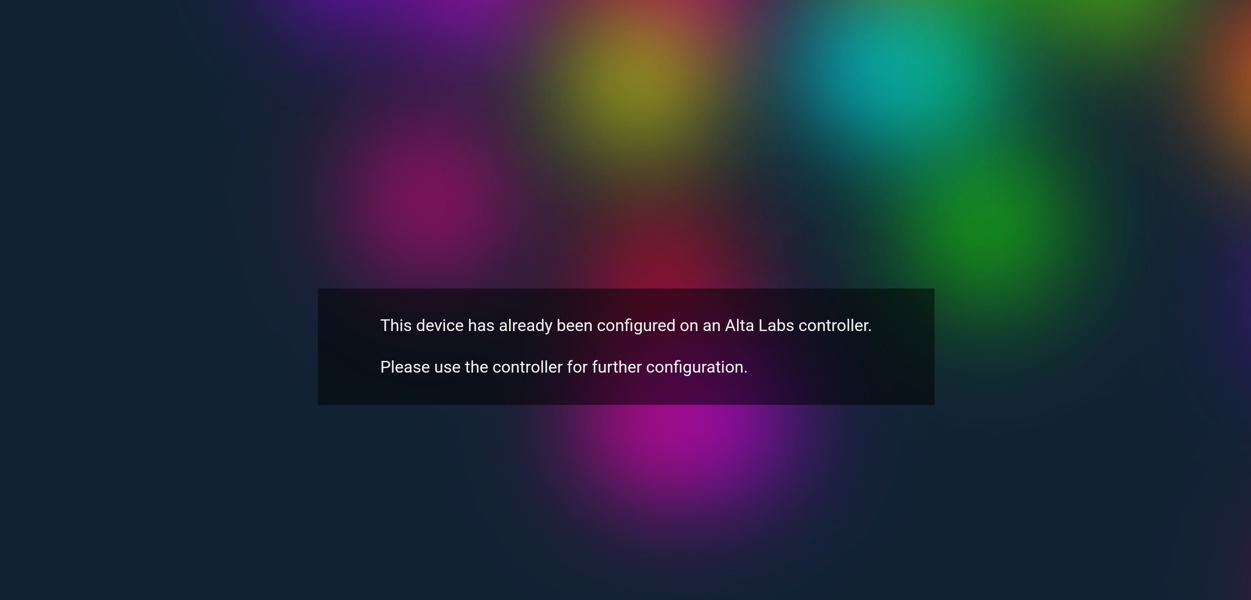

Performed those steps on the AP. Now the device is showing ‘disconnected’ on the Cloud Controller and is not showing up as a device to add on the Local Controller.
Browsing to it’s IP shows this message:
Can you share the controller logs by running journalctl on the controller as root? Would be best in a DM, if possible (or gdrive link, etc.)
