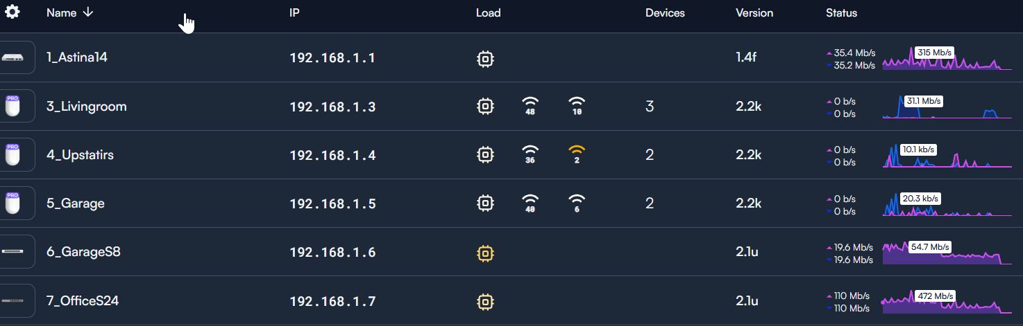

Hi,
Is there anyone that experience the same issue as I have on my system?
It looks like everything is working, I have connection to my CCTV and my NAS online and they are updating with the correct time.
I also have not got any message that the WIFI is not working so I guess that is fine too.

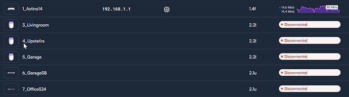

But if I open the WEB page for Alta I get the following view.
So it looks like everything is disconnected.

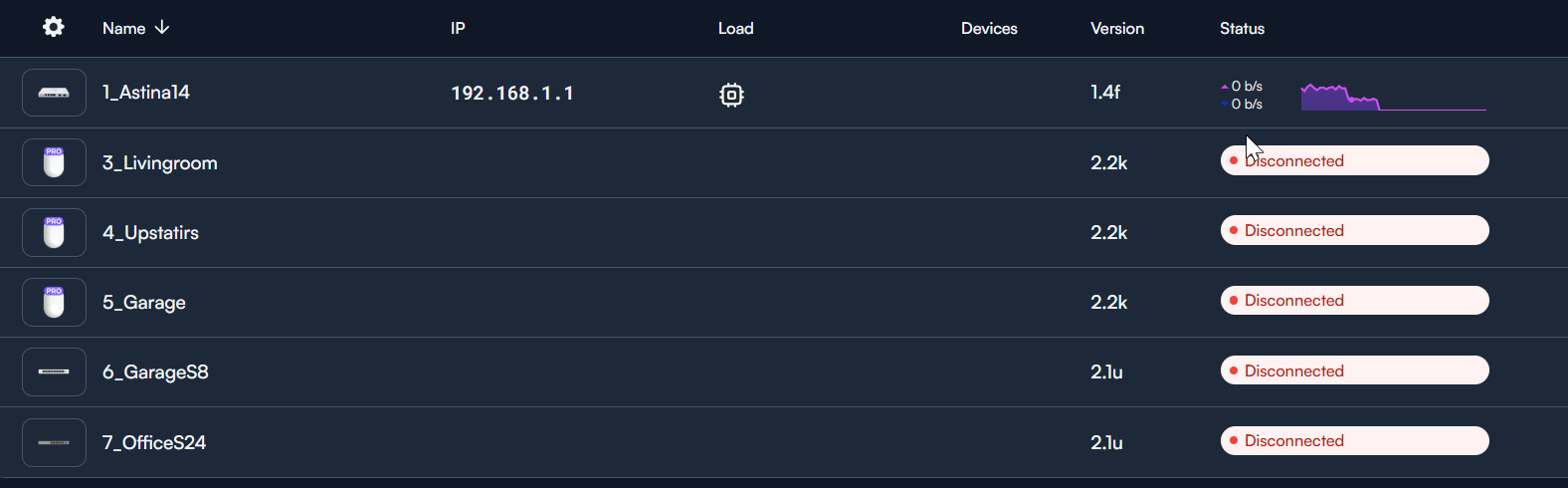

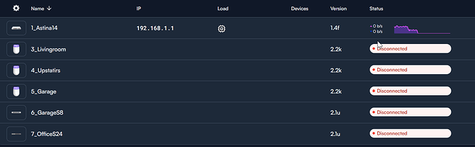

But can also inform that this morning the interface looks different and I still have not done anything.
As you can see today the route 10 has connection but all devices show disconnected. Still all items connected are working.

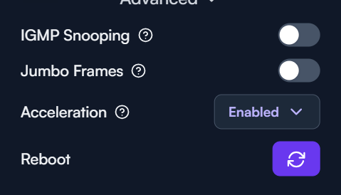

Have you tried rebooting, or briefly holding the reset button then adding the devices back to your site?
@Alta-Josh
What you mean I can remotely rebooting the Route 10?
I can not hold the reset button because I am 1000km away.
After rebooting I need to add the Route 10 to the site?

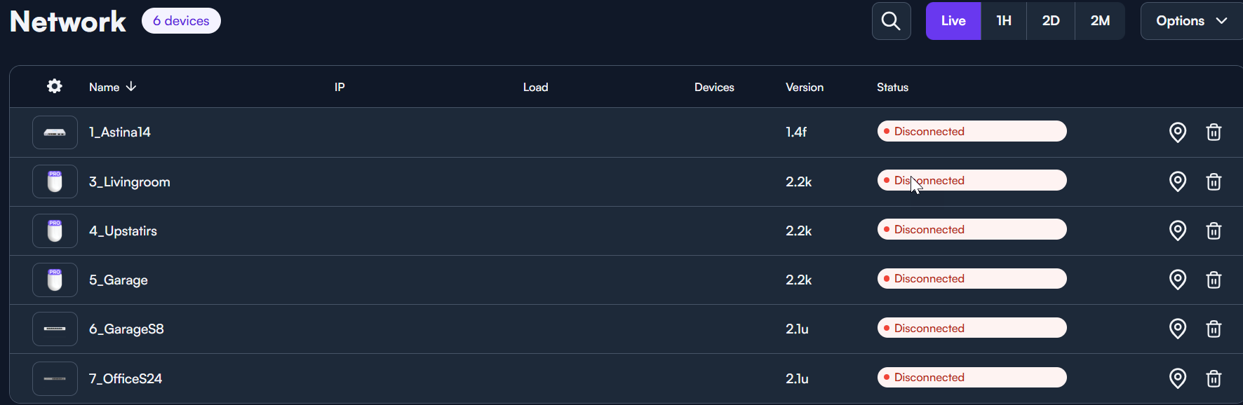

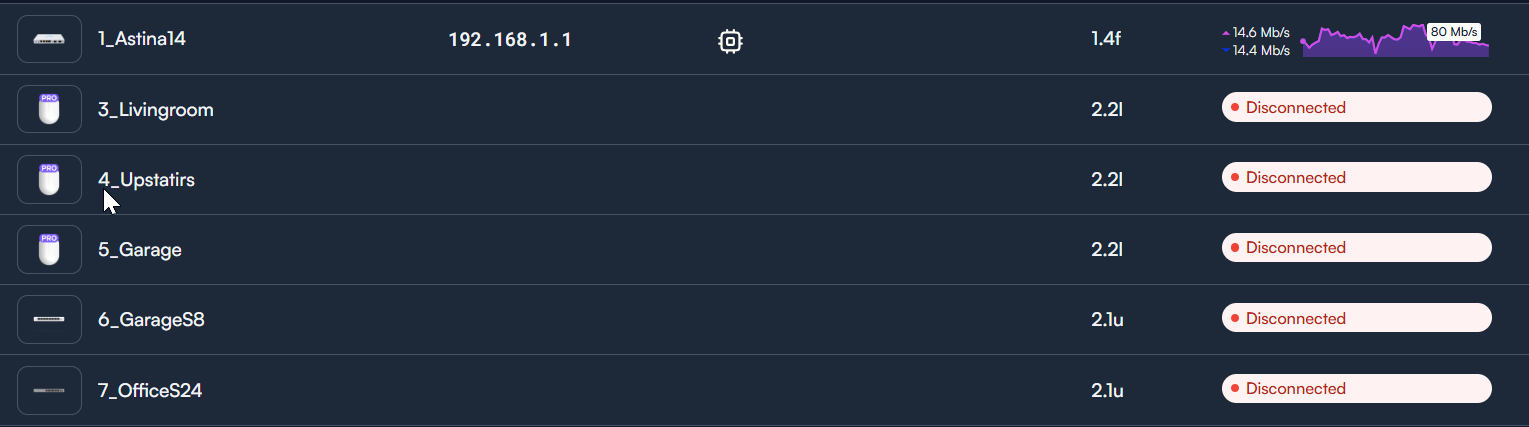

Hi again,
now again the same has happen. But this time IPv6 is disabled so there is something else and the DNS is set to 8.8.8.8 everywhere where I found it can be set.
Is there anyone that has a easy solution to this and just so you know I am not able to access the APs and the switches to see the suggested file.

But for now I have resolved the issue. I pressed the Reboot on the Rout10 and now the system is normal again.
