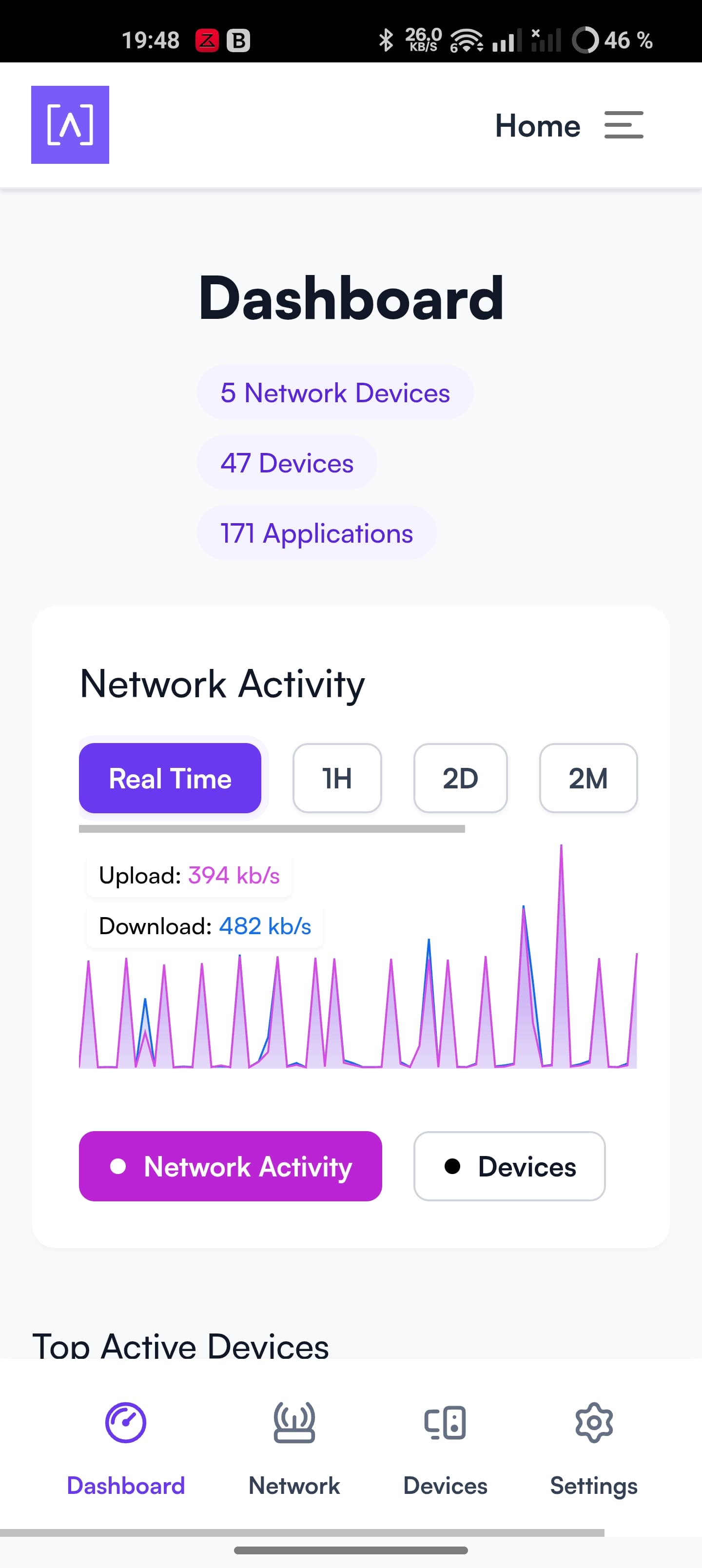

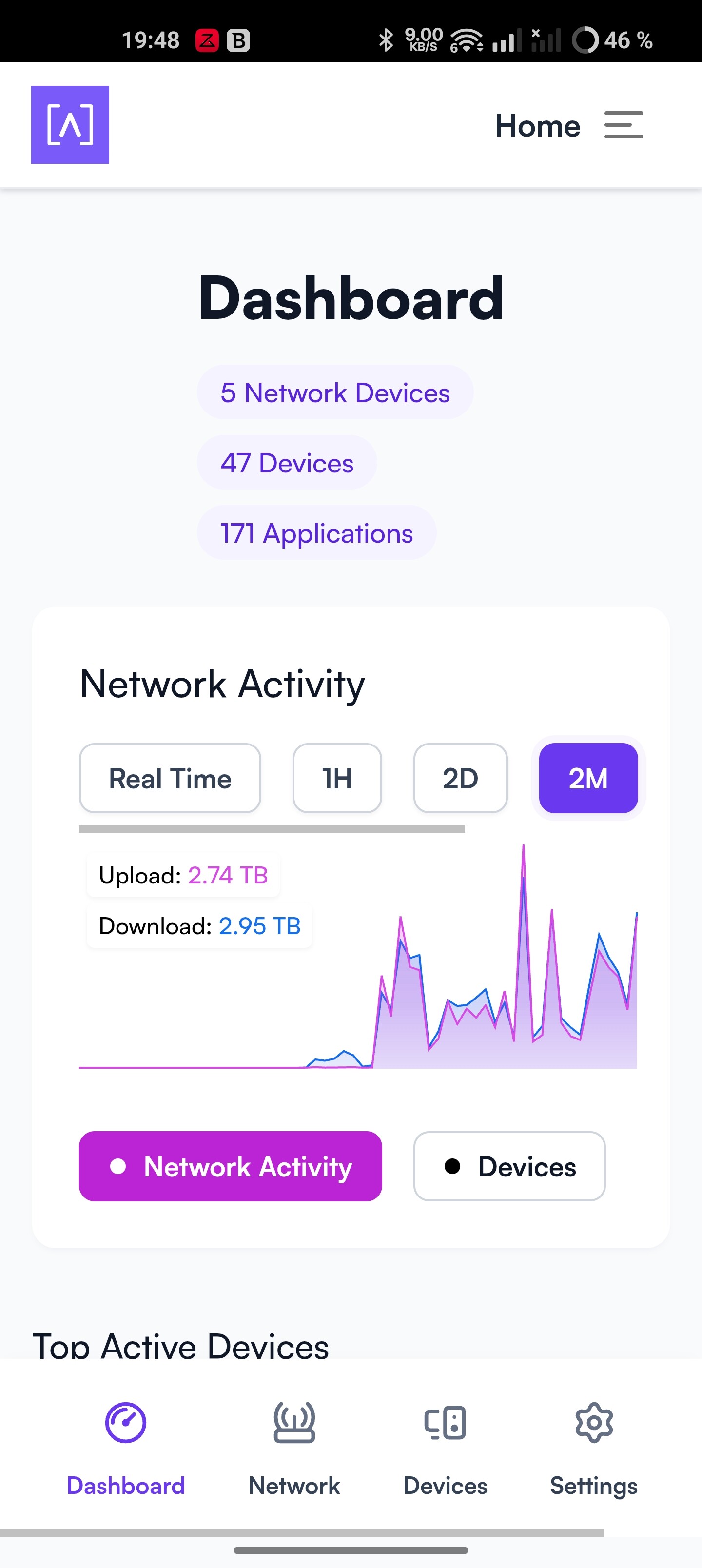

On the Dashboard page, starting off at the default Live view with a number of Devices, Network devices and Applications. Then changing from Live to 2M (or 1H, or 2D) I get the accumulated number over that period of time. All correct so far.

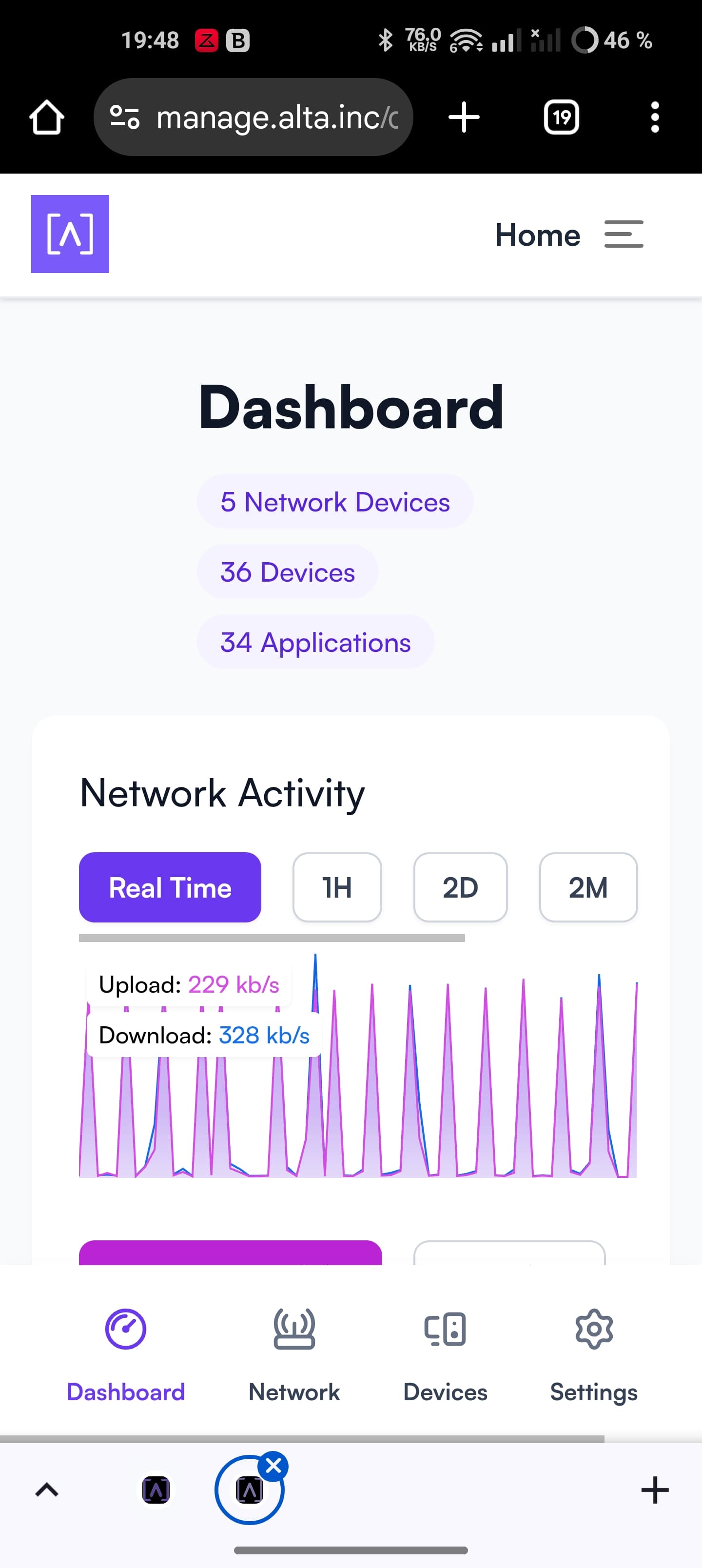

Then, when changing back to Live again, the 2M (or 1H, or 2D) accumulated numbers are still there, which I consider is incorrect. Any change from a longer to a shorter timespan incorrectly maintains/presents the longest selected timeframe’s accumulated number of Network devices, Devices and Applications. Only if I refresh the page I get the correct numbers again.
This behavior also applies to the list of Devices under Network activity (also Dashboard view/page) as well as the list of devices in the Devices view/page.
