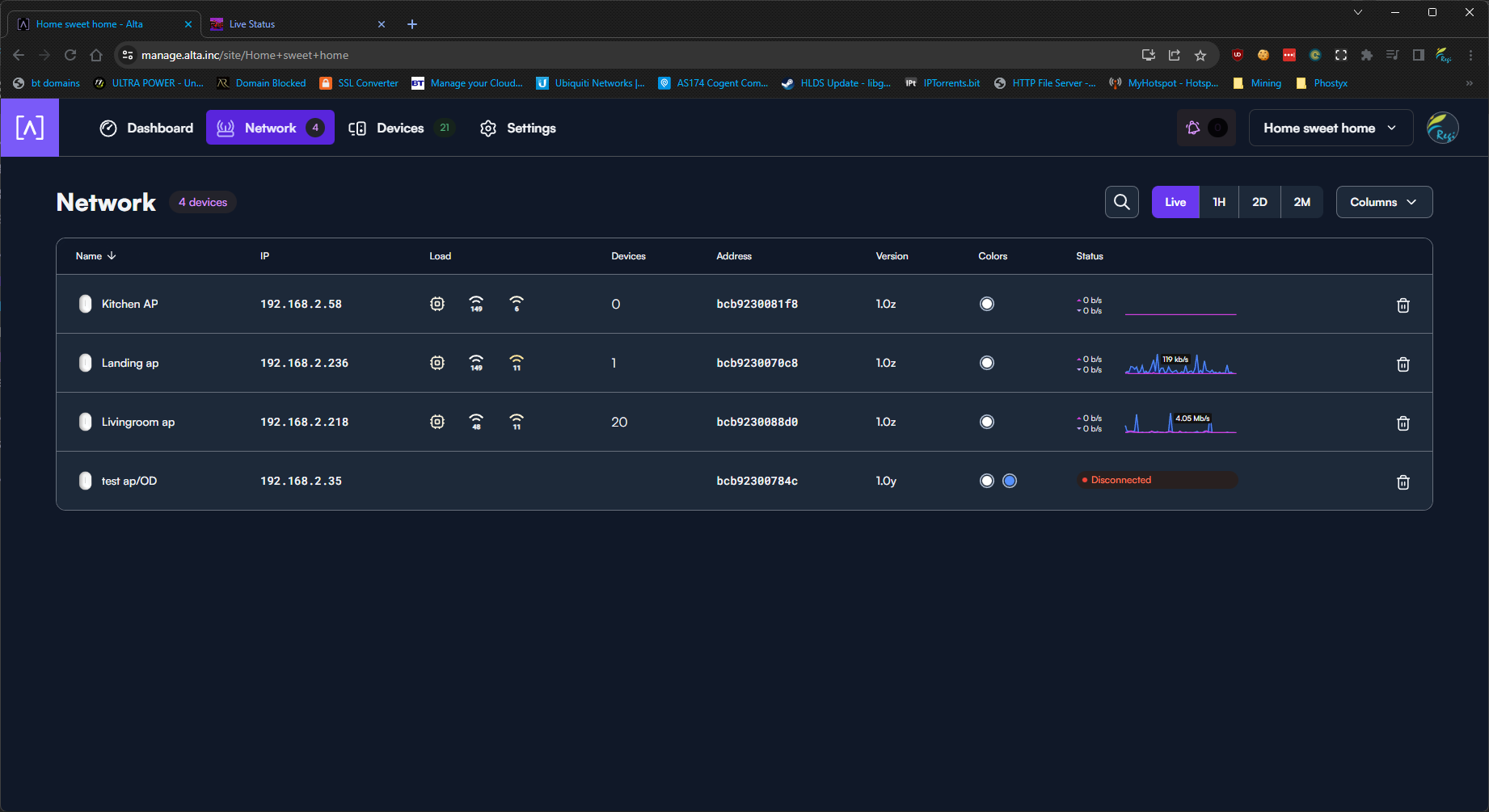

Just upgraded from 1.0y to 1.0 Z
cant do a mass upgrade so 1 at a time upgrade weird upgrading had to upgrade twice
sucessfully upgraded now
another thing ip address just changed with out me knowing on the ap

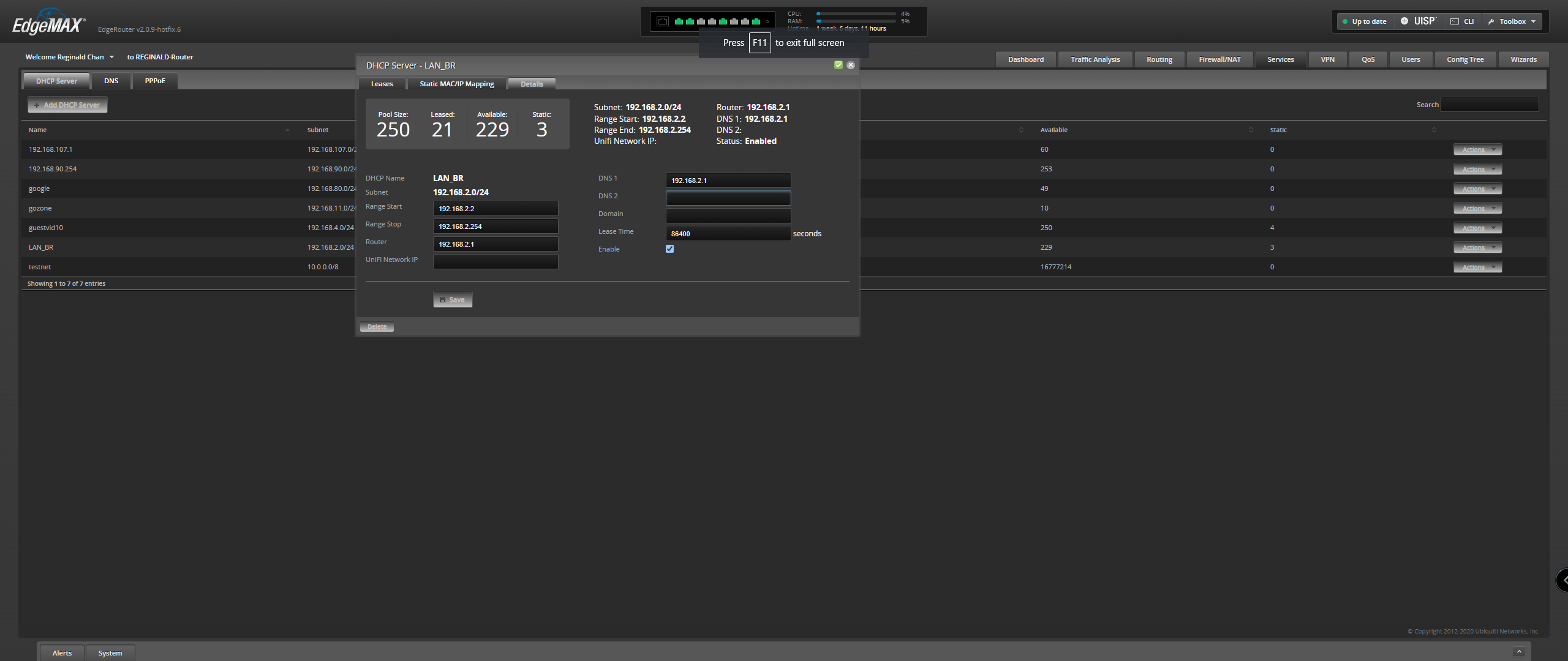

yes DHCP was used but was supposed to remain the same no expiry time on
ip should not have changed that soon
Do you have an IP reservation set for that AP? With DHCP there is no guarantees that it will stay the same IP for extended periods of time unless you have set a reservation for that IP.

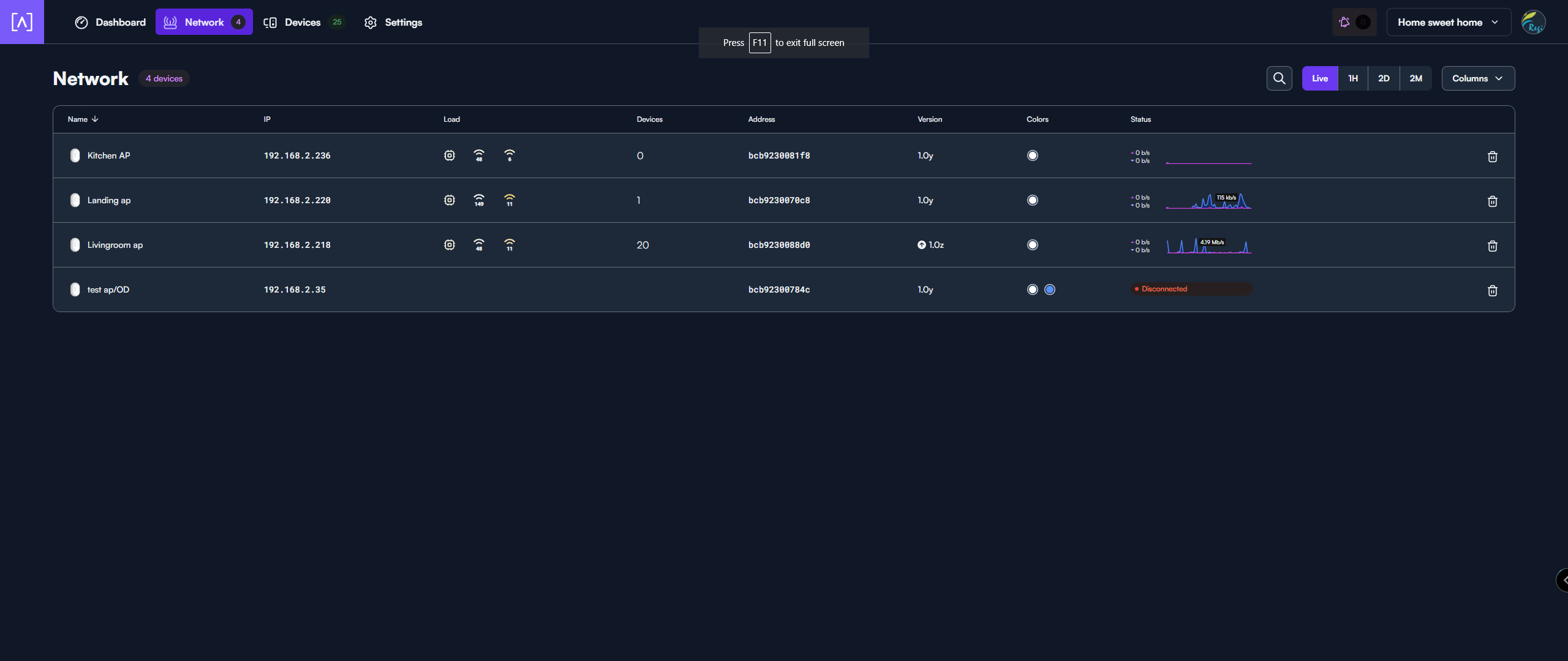

ok its just happened to another ap i did not change the ip but this should not happen if it has not disconnected this has not happened to my other aps and has happened when i upgraded to this formware its contastantly rolling ips my ther devices are running dhcp addresses and has not changed at all ive never had to static ip my old aps this can definately been this firmware thats changed and my dhcp ips are leased for 1 day or 86400 secs
yes i have Vlan tags too
so im going to have to static reservation the aps now then for some reason its losing the ip forcefully after a day now even tho my other devices are not this mist be a bug in firmware
i have never had a device lose connectivity after a day the previous firmware 1.0Y it was stable was fine until i upgraded to 1.0z what changed theres no change log to read

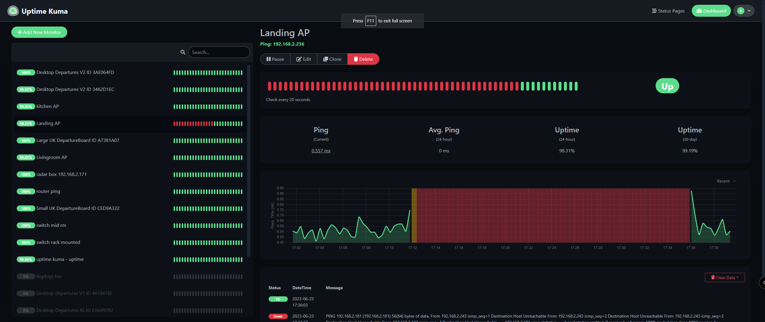

think my aps are restarting i just lost a call when it happened
