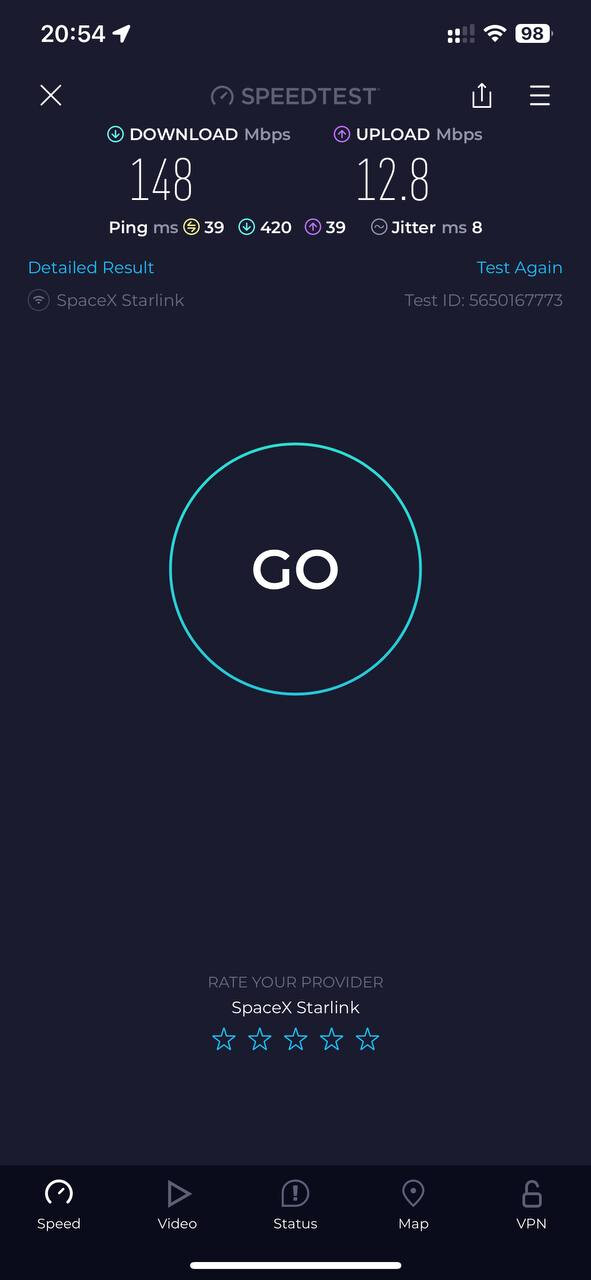

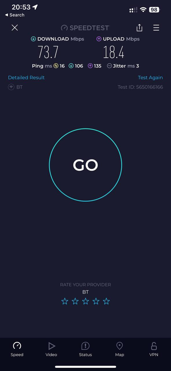

heres 2 of my speed test over Star link and Bt business in the uk
StarLink starlink is on same network Vlan tagged 574
Bt business main network 80 /20 line speed i get about 73/73 and up load 18 /19
