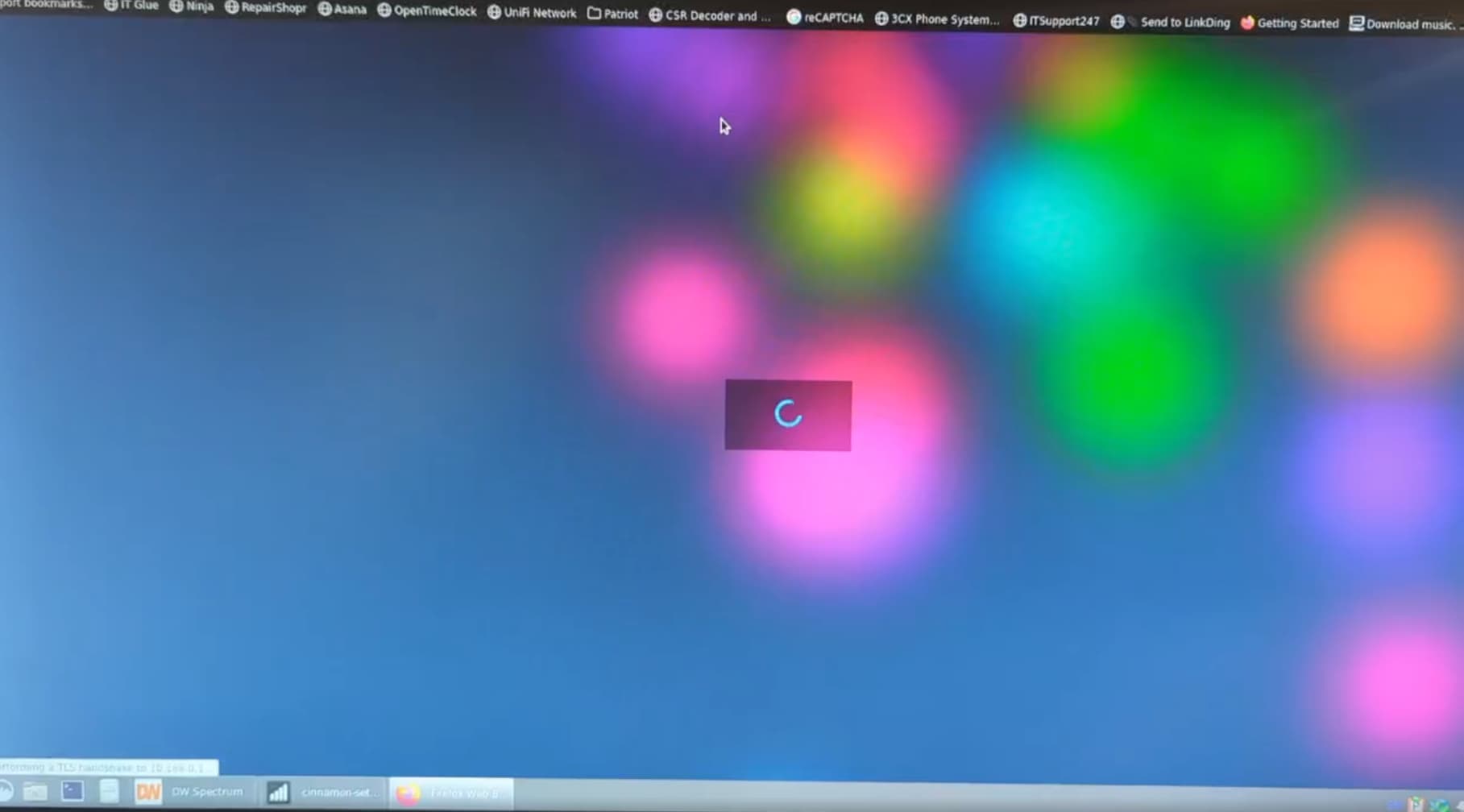

All the devices connected to each VLAN network are connecting to what they should, so no problem there. Here’s where it gets weird. A few devices on my “Streaming” network (Echo Dot, Fire Stick, etc.) are getting an IP address of 10.188.x.x instead of 192.168.12.x; and some of the IoT devices are getting 172.x.x.x instead of 192.168.50.x. If I browse to that IP’s logical gateway (eg: 10.188.0.1 for the streaming devices), I get a page like this and the host header identifies as Alta.
