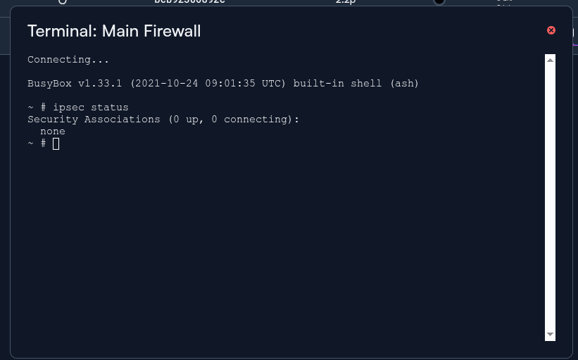

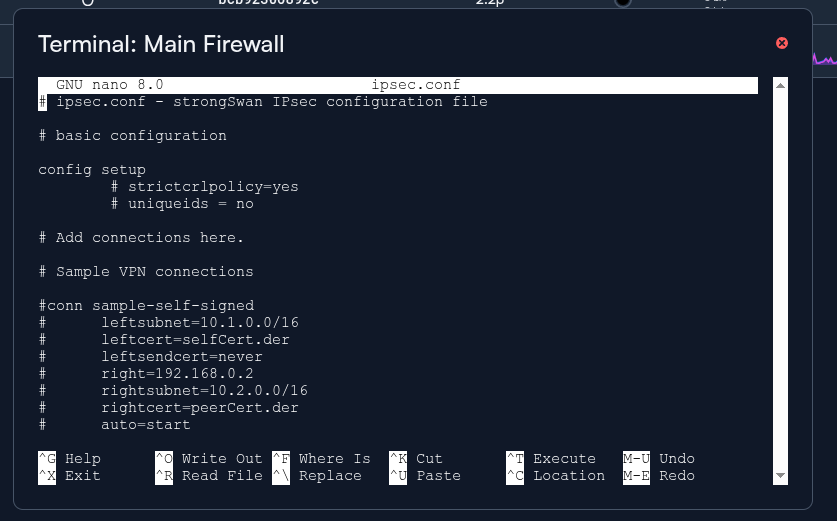

I just ran the command ipsec status and it shows no connections up and 0 connecting. OK digging deeper, ran nano /etc/ipsec.cong and there is no config.
Is the cloud not pushing the config ?
We don’t actually configure IKE based VPNs there so it’s just a default file; we use swanctl to manage strongSwan. If you check /etc/swanctl/swanctl.conf you should see the main parts of your config. Here are some useful shell commands:
swanctl --list-sas → check live tunnel state
swanctl --list-conns → confirm configuration
swanctl --list-certs / --list-keys → verify credentials
swanctl --list-pols → verify kernel policies
swanctl --list-pools → cleanest way to see just the configured subnet(s) for address assignment
