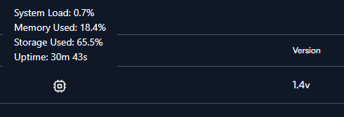

I lowered the RAM usage to about 29% (as seen in the UI). Note that I have other custom services running. This translated to less swap file usage.

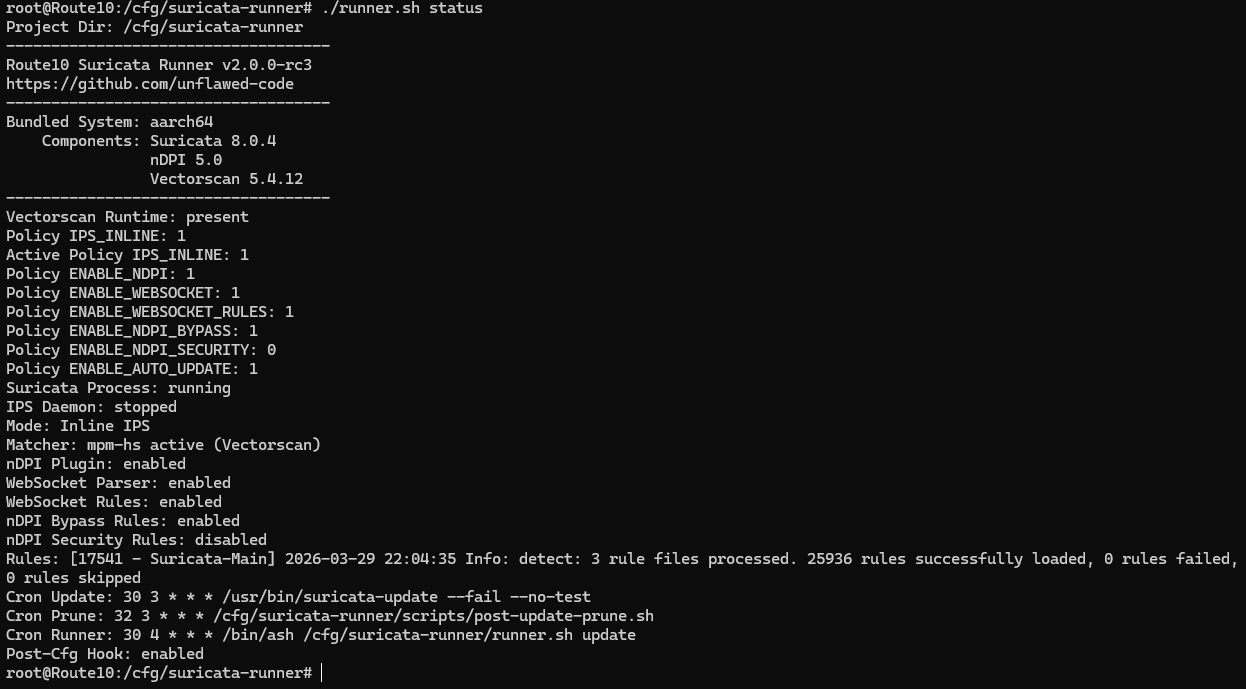

Aside from stability fixes (comes as a patch which might not work in the future), the script also allows you to configure what security categories you want Suricata to load. Of course the more categories loaded, the higher the memory consumption will be.

IPS Inline support is now available. Check the Github repository.
Just a note that for IPS Inline mode to properly work, the script will turn off software/hardware offloading. Offloaded packets bypass the CPU and thus bypass the NFQUEUE.

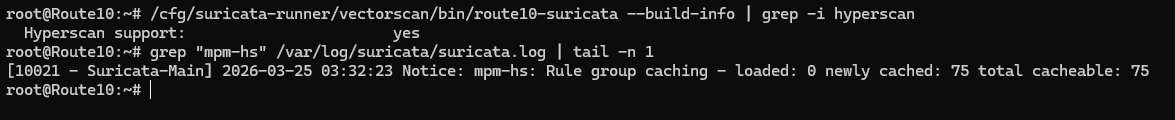

I would still recommend using the IDS + Reactive Blocking mode. Route10 doesn’t use a processor that supports instructions that scan data extremely fast – specific Intel or modern processors where Hyperscan can be used.
@ebuckland81 As expected, my download speed dropped to ~380 from ~530 Mbps. I added some NFQ tuning, see if it improves your download speed.

Porting Vectorscan is feasible. It should be faster in parsing rules. But the bottleneck will still be NFQ. Plus offloading is off, so I expect marginal improvements to download speed.
With IPS_INLINE=1 and 4 security categories, I get a download speed that’s near my 550 plan – from ~380 Mbps it’s now from 525 to 535 Mbps. Of course this is with some NFQ optimizations. Vectorscan alone will not boost performance significantly.
I do think with Aho-Corasick + NFQ optimizations I’ll be able to get near ~500 Mb. But why bother when there’s Vectorscan.

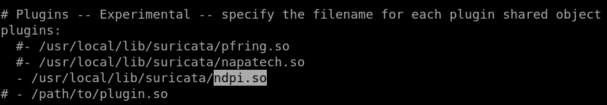

Vectorscan + Suricata 8.0.4 + nDPI 5.0 + NFQ tuning can significantly boost download. Of course you have to tune your security categories – I wouldn’t include everything.
Please note that Suricata 8.0.4 and nDPI 5.0 adds more performance tuning control. For example, I have this bypass rule which lets Suricata check only the beginning of the traffic and skips it when it identifies that it’s Netflix or Xbox:
pass ip any any <> any any (msg:"Route10 nDPI bypass Netflix"; ndpi-protocol:NetFlix; sid:2900101; rev:2;)
pass ip any any <> any any (msg:"Route10 nDPI bypass Xbox"; ndpi-protocol:Xbox; sid:2900114; rev:2;)
Refer to the documents in the /rules folder for details.
I hadn’t spotted that ability to setup a bypass rule when using nDPI with Suricata, so that’s a really neat catch.
How was patching the compatibility between Suricata and nDPI if you don’t mind me asking? I kinda gathered there was a bit of a stand off between the projects on who might be responsible for implimenting that support
Aside from missing dependencies in the beginning. I didn’t encounter compatibility issues when compiling Suricata 8x with ndpi. You mentioned standoff? When I compiled Suricata I had to pass enable ndpi flag and not the other way around.
