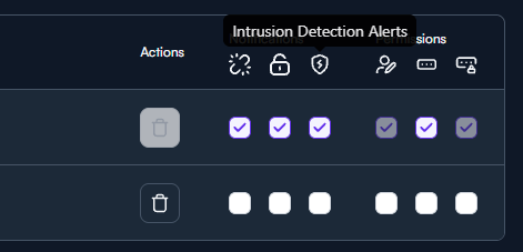

I would start with setting the notification level to high then going into users and making sure the intrusion Detection notifications are set (shield icon) which should send email alerts for IDS/IPS. Im not sure if Alta will send notifications based on basic blocks, they may have it sent to things that are more dramatic like matching on known bad traffic.
Sadly already had all that set but it doesn’t notify you when it is just doing filtering of the ips it would seem. Only if something hits the IPS system itself. Honestly it would get annoying getting notifications for all the filtered ip’s but it should be somewhere that you can visibly see what is being blocked.

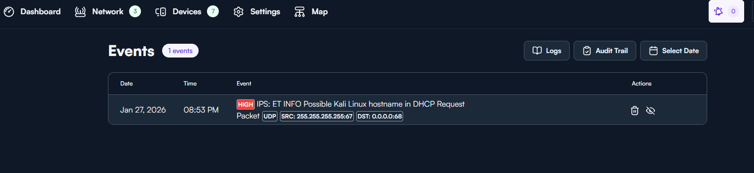

There are some surricata logs at /var/log/Surricata. Also if you click on the bell in the upper right you can see some of the alerts. There is also a log tab but i dont have anything listed there so im not sure what to expect to see in that tab but my network is just a lab with limited traffic. Only Event i have so far is the system finding out i’m playing with Kali. You may have more.
I was expecting the logs to show something but you need to search something for results. You could try searching the IP you had issues with and see if there are any logs that populate.

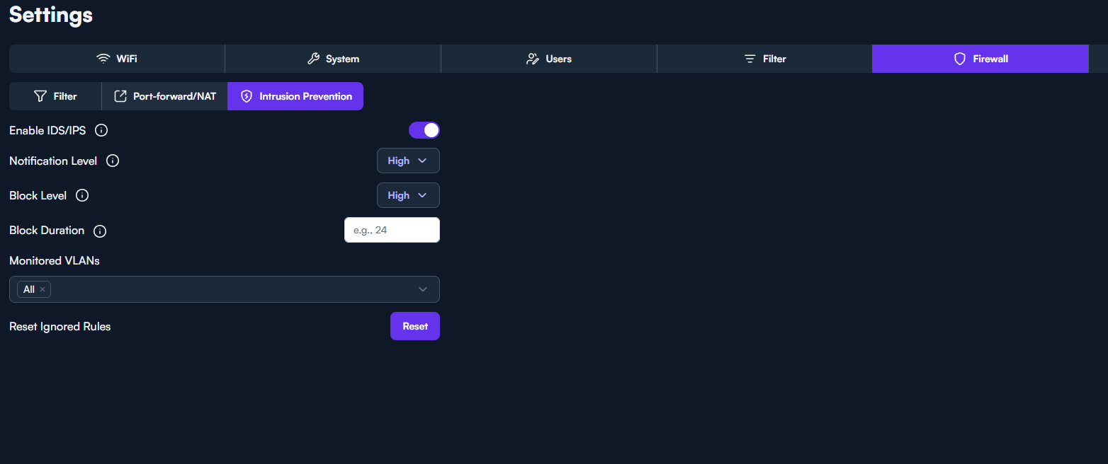

As far as I know, the Events section in the UI shows what the IDS has identified. The severity level you set results in events according to that level and above is shown in the Events log. Events/Alerts are passed from IDS (Suricata) through ips.sock to the IPS application, so it is not available in any of the logs. Also, it doesn’t imply that that traffic is actually blocked.
The actual blocks executed by the IPS function is not presented in the UI anywhere. The block level is set as another UI configurable level, and it would mean it would attempt to block traffic according to triggered events at the specified level and above. If you set the block time for IPS to some time > 0 you will also get temporary block rules in iptables, tagged ips which I guess you may be able to inspect/monitor via
iptables -S | grep ips
iptables -L | grep ips
iptables -L ips -v -n
The blocklist chain rules (or whatever the lingo is) are tagged as banIP, and activity could be inspected/monitored with
iptables -S | grep banIP
iptables -L | grep banIP
iptables -L banIP -v -n
Monitoring would be at dropped packets level. In order to see what IPs were actually dropped you would have to add log-prefix entries to iptables, and then monitor /var/log/messages via
tail -F /var/log/messages, or
tail -F /var/log/messages | grep <whatevertagyouchose>

I think that’s generally about right :slight_smile: I’ll note that IPS blocks do seem to pop up when streaming the logs as well. For example:
ips: run "iptables -D ips -s 192.168.5.13 -d 184.25.113.187 -j DROP"
Otherwise I’ll say that I do think it would be handy to see what’s being filtered by the new Block Lists functionality, as I don’t think there’s a way to right now.
