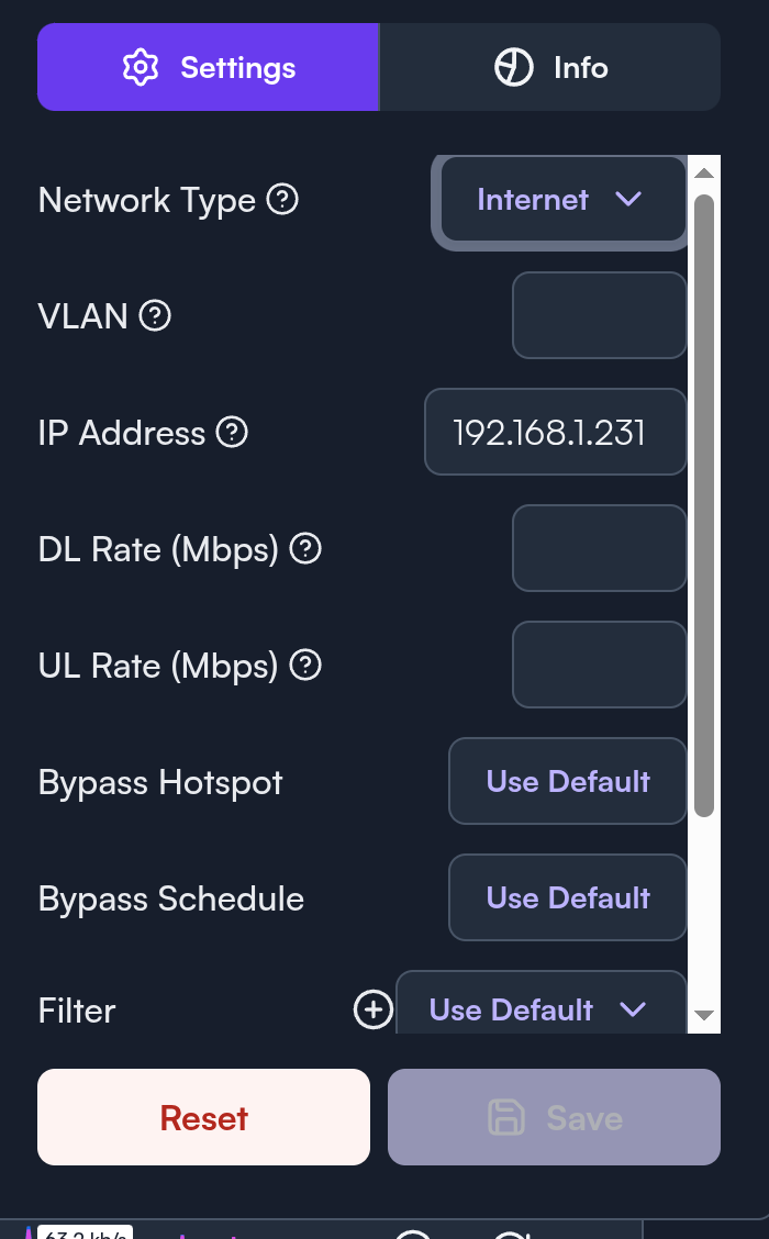

"Internet only" mode doesn't seem to work
“Internet only” mode doesn’t seem to work as expected, I’ve set some devices in my home that I need internet only access (i.e. no local network) it seems like those devices are still able to access the local network. I’ve set my phone to “Internet” mode (and reconnect wifi) yet I can still access the local services via IP, This is true with other devices that were set to this mode as well
