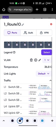

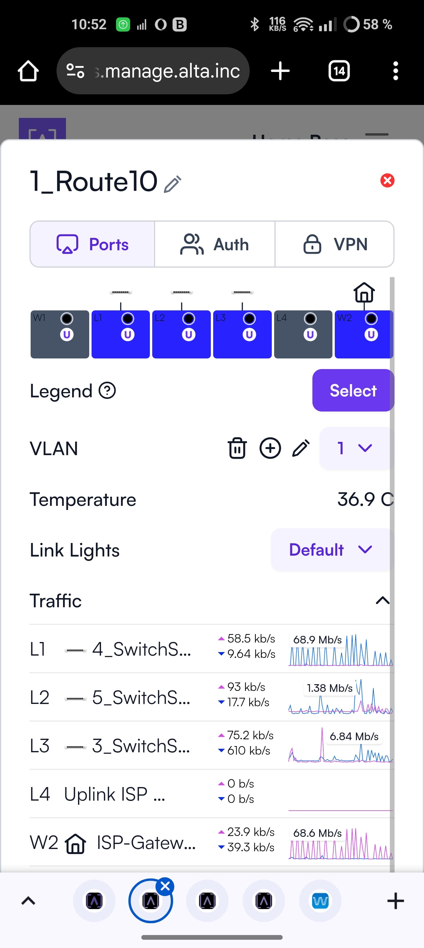

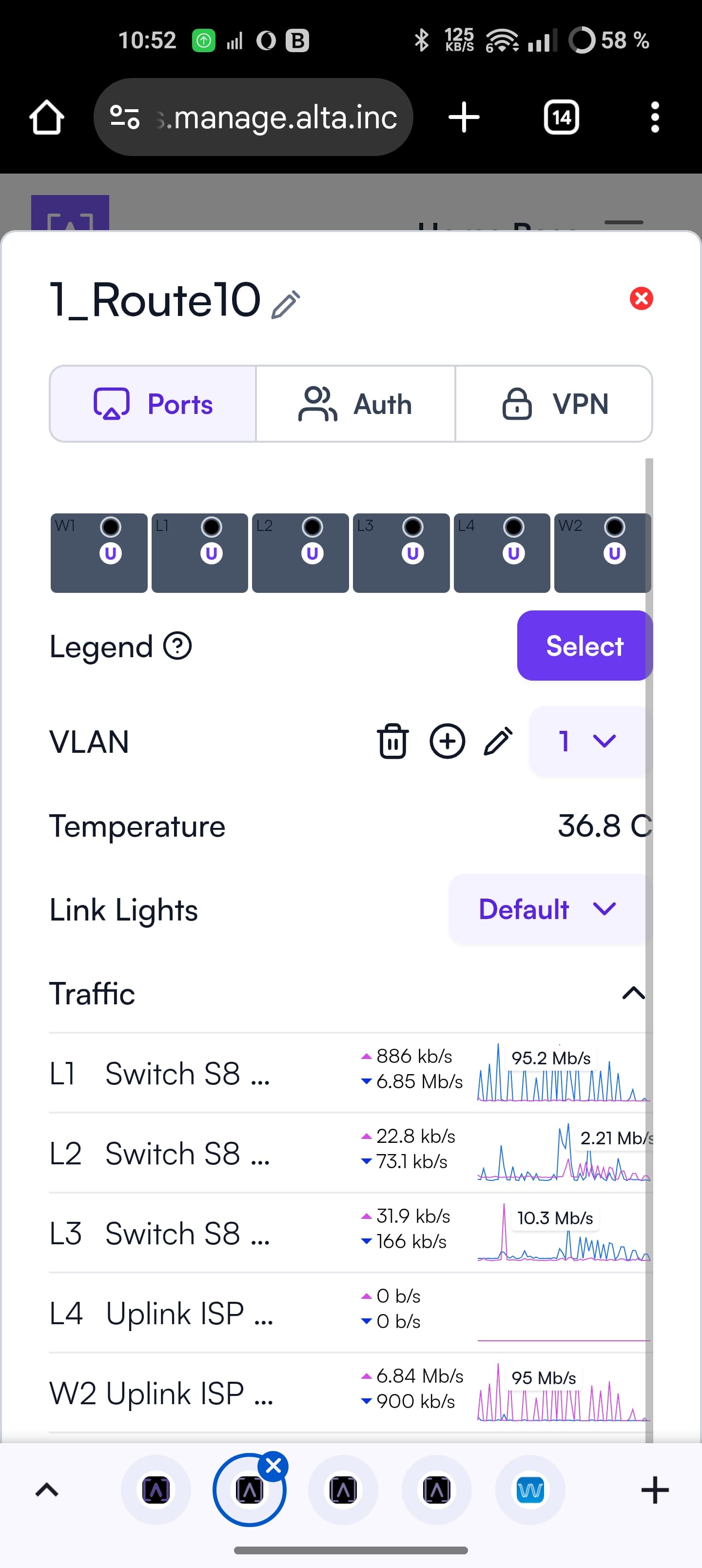

Reporting some strange behaviour on the On-premises hosted hardware Control UI (on 1.1c) for the Route10 (on 1.4f) and at least one Switch S8 (on 2.1u). The Port and Traffic intermittently changes between blank ports and proper ports, and port text annotations within the Traffic section changes between the port Name and the corresponding attached (Network) Device’s name. For a while it can change every second or so, and then maintain the correct info for a while, and then start over changing again. Not entirely sure if all three switches are affected or if only one (+Route 10).
Anyone else that has seen this?
I have tried a few things; impact from attaching through VPN, Control HW connected to Route10 directly or to downstream Switch S8 and Control powered by PoE or PSU. Problem still there.

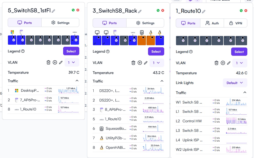

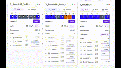

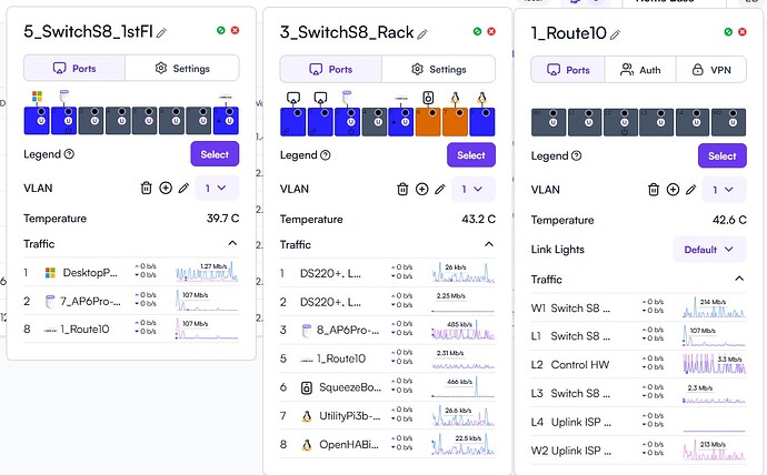

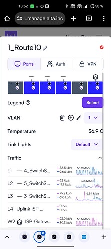

So, it seems like the intermittent flickering is back, even with the EEE disabled. Recorded on the PC and exported and uploaded as a GIF to visualize. My excuses for the low quality, but what I want to show is the ports and names in traffic flickering, so here is also a JPEG for reference.
