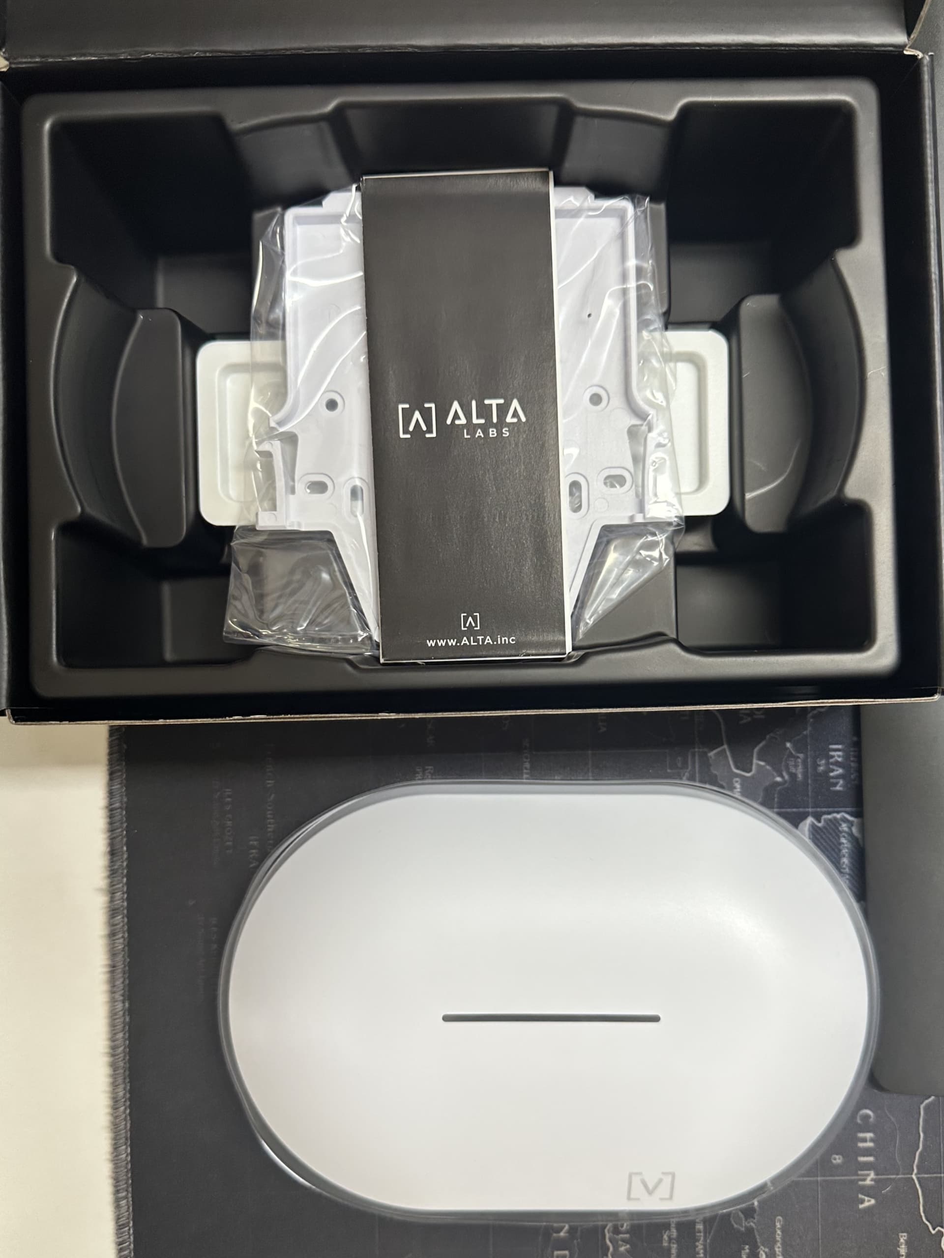

Whats in the Box?

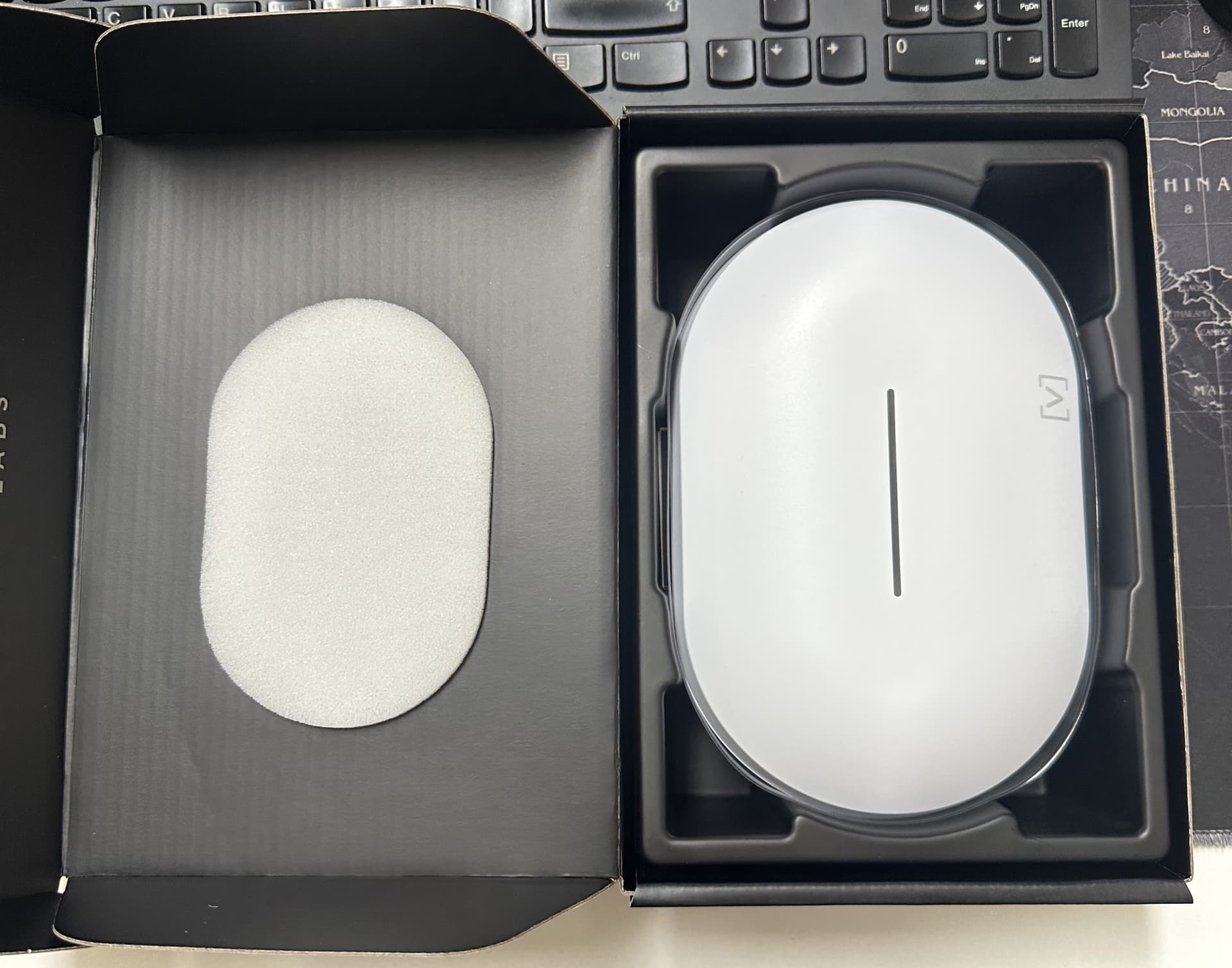

Inside the box as soon as you open it you’ll find the white oval shaped AP snuggly fitted into the box and held in place with a small amount of foam on the lid and a plastic back cover

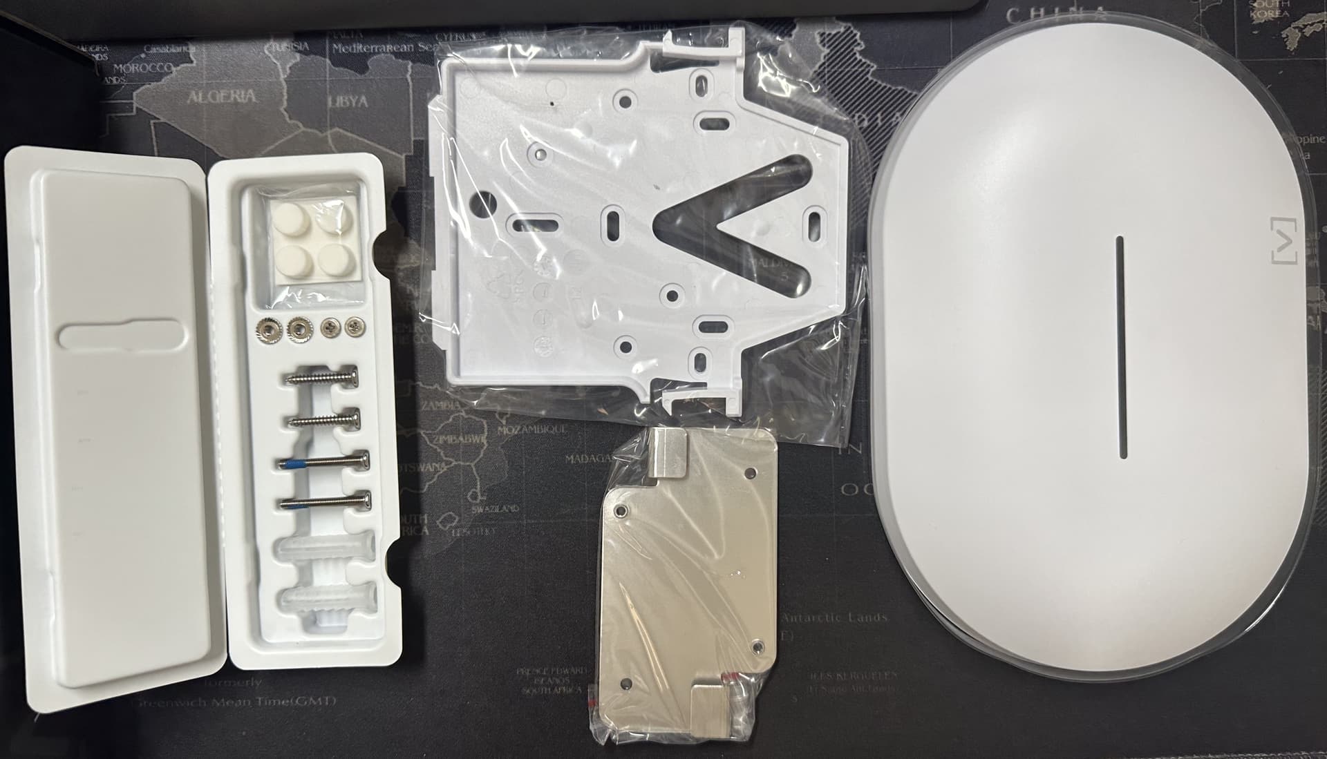

Beyond the unit you’ll also get the multi-lingual user guide to get you started as well as BOTH of the mounting options with fittings!
The plastic Wall/Ceiling mounting plate and the metal T-Rail mounting plate - Usually the T-Rail plate is an optional paid extra with certain vendors which was a nice bonus to see

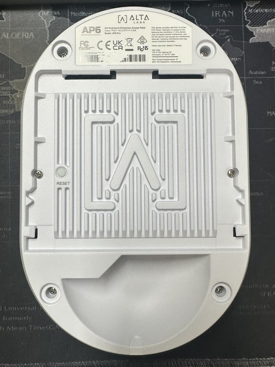

General look and feel of the unit itself - Its a very robust unit, it’s got a little bit of weight to it but that’ll be down to the heatsink - but do watch out as the front of the AP is a little slippery and I almost had it slip out of my hand picking it up.

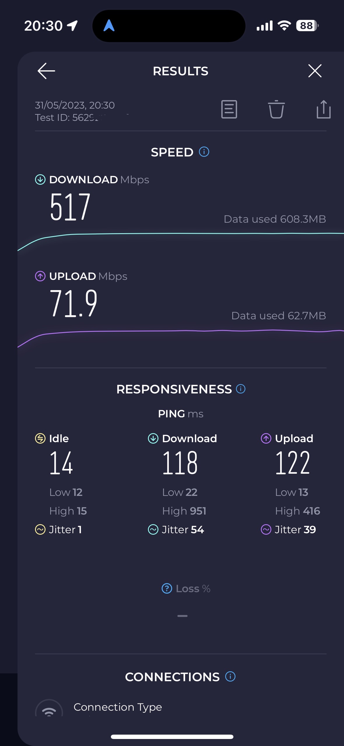

In my particular environment I’ve got a FTTP 550mb / 75mb service so I’ve already got a benchmark for what speeds I’m able to achieve “over the air” using my existing MikroTik cAP ax to my iPhone 14 Pro, Samsung S21+ and Lenovo Thinkbook 20SL with WiFi6 ax chipsets
Via my current setup which is:
FTTP > Fibre ONT > MikroTik RB4011 > MikroTik cAP ax
I generally see between 500 and 540mb depending on which speedtest server I test to in London at various times both during the day and evenings

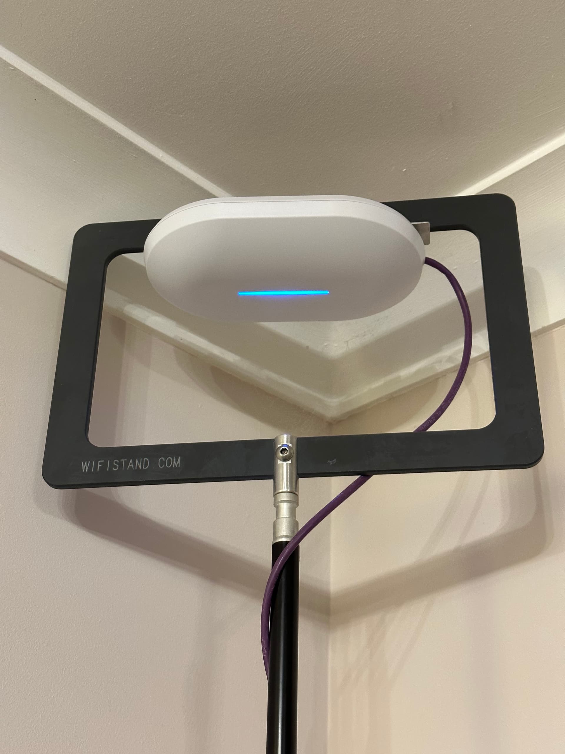

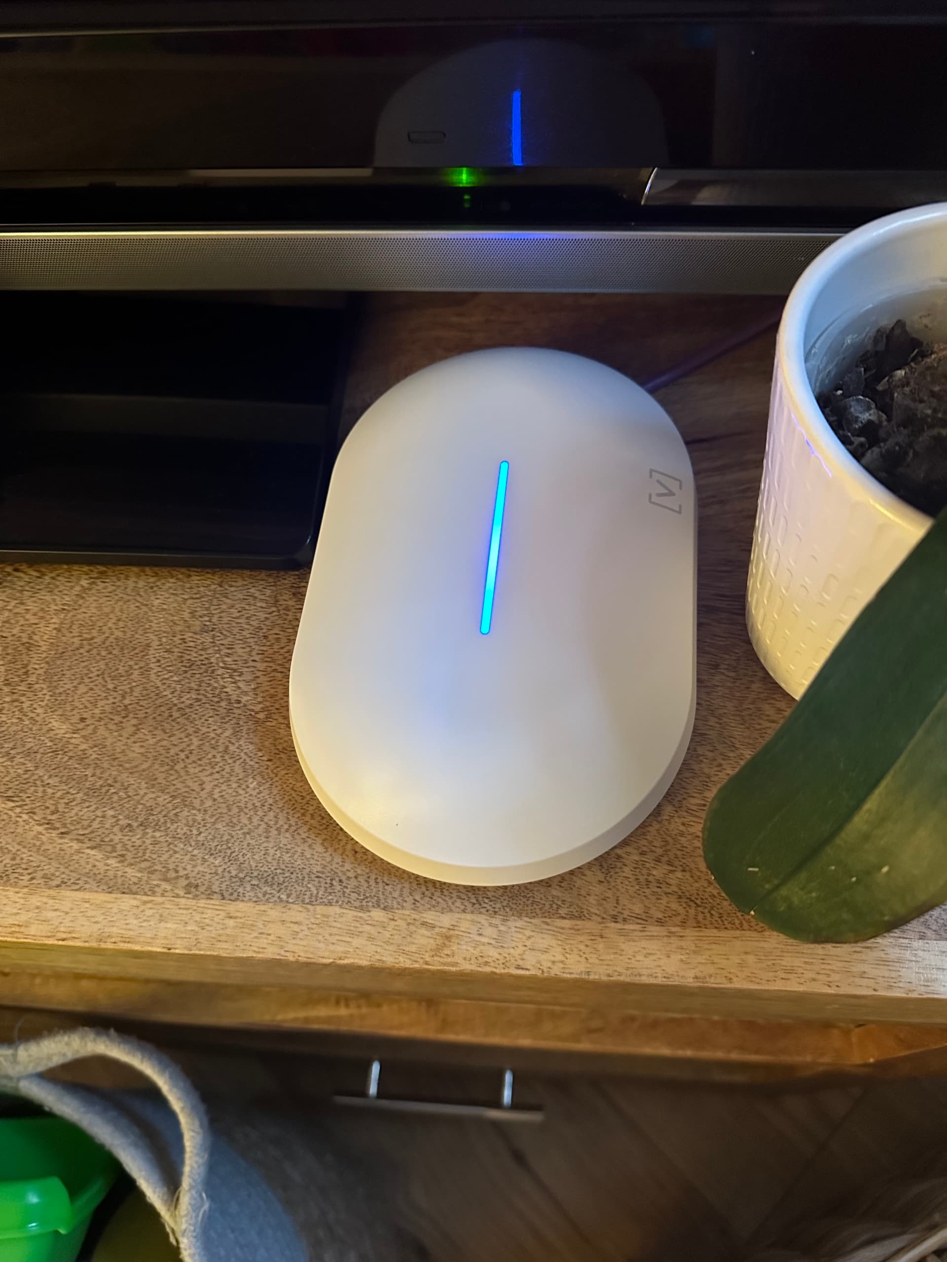

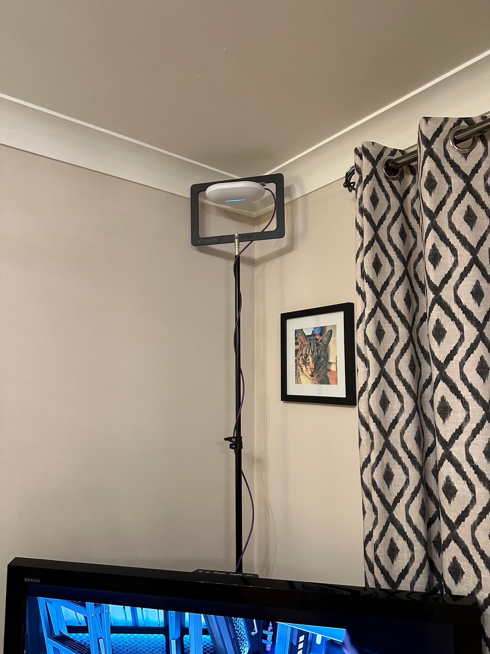

Same location as my cAP ax which is on my TV unit and also on a WiFi-Stand tripod at ceiling height - both in the corner of the room
The speeds and range from here were similar coverage to my existing AP in the same location, so it covers the whole of the living room, extends to the garden which is the external wall with window next to the AP location and outward to the front of the house through the Kitchen and upstairs to my bedroom’s - it does trail off so a 2nd AP upstairs would then give the complete coverage - It’s time like this I wish I had access to some WiFi survey hardware and software to map it properly!
The 2nd test was raising the unit in the exact same location but at ceiling height to avoid any physical obstacles which the lower position will have dampened.
The elevated position gave far better results to the first “range” test at low level - which goes to show to anyone who thinks leaving an AP on a table - usually will find it won’t go as far as if you wall or ceiling mount it - Best check the polar plots to see which might be better for what “direction” you want it to go which to be fair it is fairly well rounded in both polarities (bar going through itself with the heatsink obviously)
So overall the speeds I was getting was on par with the MikroTik cAP ax when tested against all 3 of my AX enabled devices, given internet speed is variable it was generally between 500 and 530 at a peak when I was watching the ethernet interface it was plugged into.

The only con’s which I have found have been the AP mounting process, I did find it a bit fiddly with how the mount is clipped in and did find it a bit difficult to do the right motion to tilt and click it in place - having a mounting tool to undo it would be handy but a thin flat blade screwdriver does work, my only concern is if it does need removing more than a few times it might start to pull out any wall mounting fixings
The IP rating does make it very much a if its outside make sure its well covered as the back is exposed with no gaskets but it does state this in the product description - if your familiar with the Ubiquiti AP’s, it’s similar to the back of the UAP-AC-Pro unit without the rubber bung
