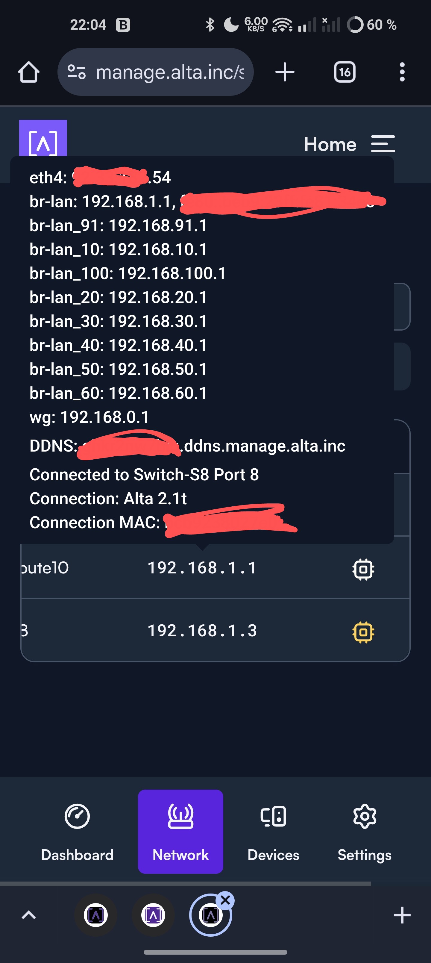

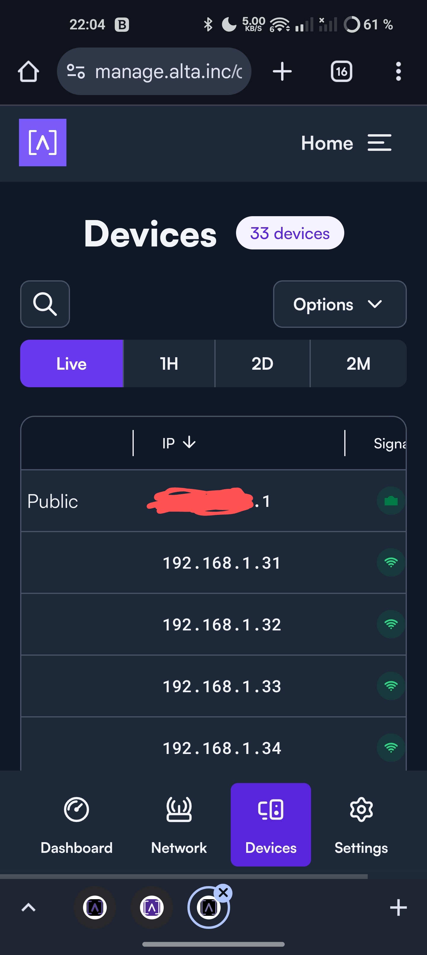

I noticed that the WAN port appeared with some information on the Devices list. It’s probably been blank before, because I haven’t even noticed it. This happened simultaneous with the batch of firmware updates yesterday. :slightly_smiling_face:
I noticed two things for that device/port:
  1. VLAN is listed as 1, though there is no VLAN set in the settings (Settings → WAN) for that particular WAN port. I’m confused about that VLAN listing.
  2. The Public IP shown ends with .1. Meanwhile, eth4 is shown as .54. A check for my public IP on the web shows that same .54. Confused about this too…
Screenshots
Anyone who can explain why there is a difference?
  1. The .1 address is the IP address of your gateway, so while the Route10’s WAN interface is .54, the gateway it is using will typically end in .1
  2. VLAN 1 just means the default VLAN, i.e. it is untagged.
Thanks! :slightly_smiling_face:
So, the x.1 is basically the gateway at the ISP’s end, that my WAN connects to. And it is shown as a client in the devices list. Is that a correct interpretation?
It’s definite a device connected to the Route10, but you’re right, we should probably flag it as a WAN device.
:+1: Yes, agree, it’s definitely a device connected to the Route10. Merely trying to understand what is what and I was contemplating on what the “device” actually indicated.
I agree, some sort of indicator of it being a WAN-device would perhaps be a good idea.
