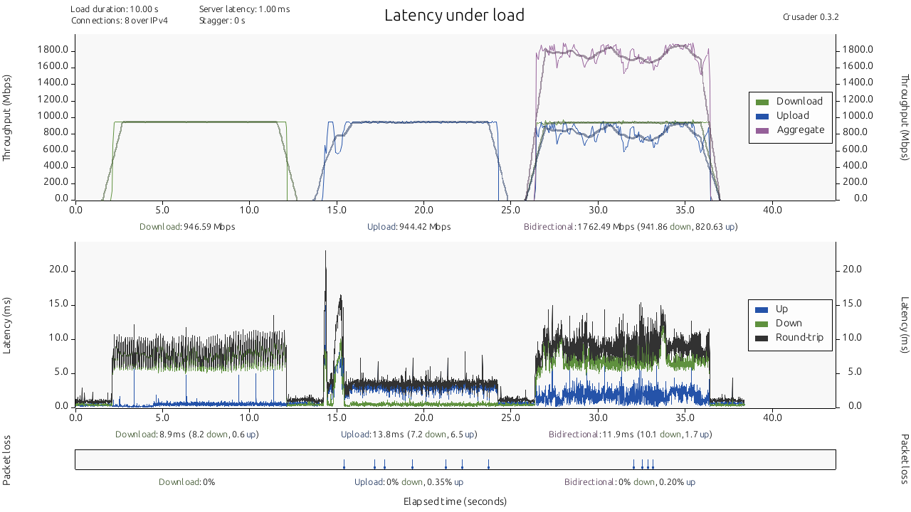

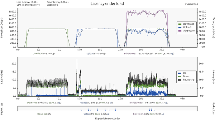

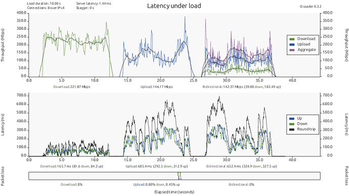

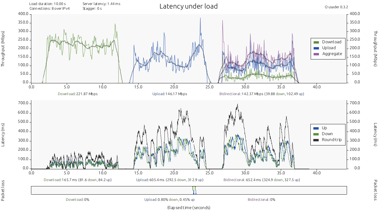

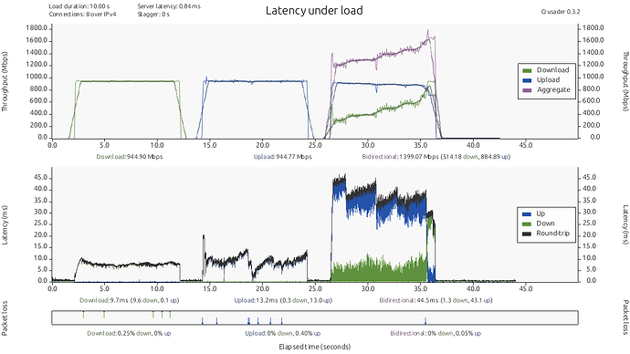

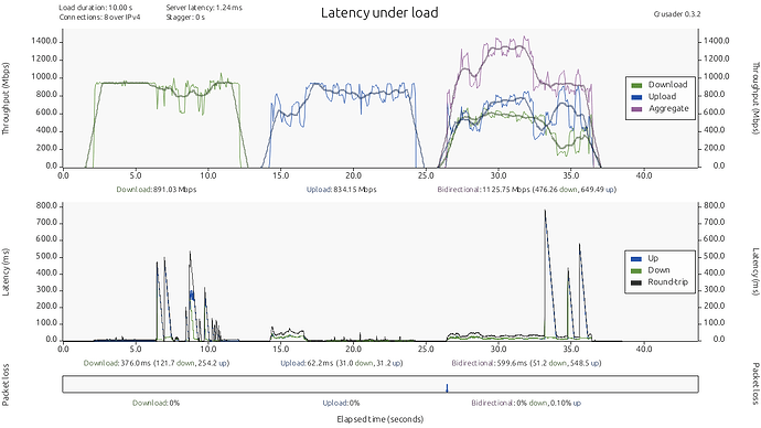

So I’ve been meaning to come back to this after letting IDS run for a while at another couple of sites. Memory usage seems about the same on those sites, but I decided to run some tests just to see how having IDS on affected performance to a VM on another VLAN. Just a warning, this post might be a bit long!
The path to the VM is a little convoluted, but typically 1Gbps is achievable when transferring a file over the network. Looks roughly likes this:
Windows PC 2.5Gb -->Mikrotik RB5009 10Gb → Switch 10Gb → S12 10Gb → Route10
Ubuntu VM 2x1Gb → Switch 10Gb → S12 10Gb → Route10
I also typically use this tool for testing as it yields some decent graphs and shows latency under load which I find to be handy:

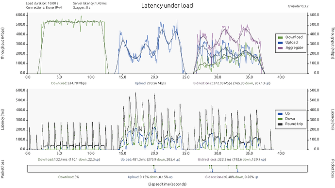

Anyway, my initial testing of the througput between the devices yielded not great results which surprised me a bit

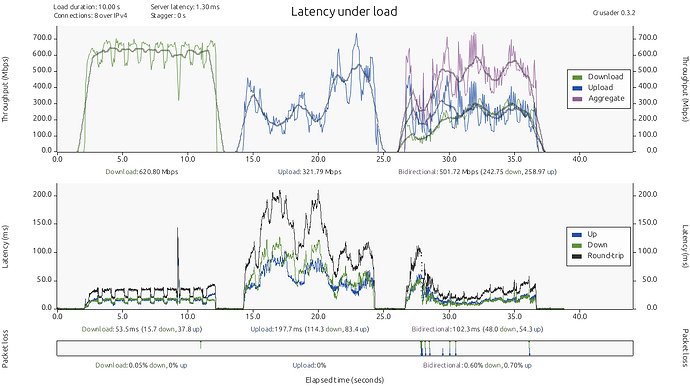

So I decided to click IDS back off, which yielded better but still not quite where I wanted it to be
I felt it was time for a reboot at this point and it seems performance was back to normal

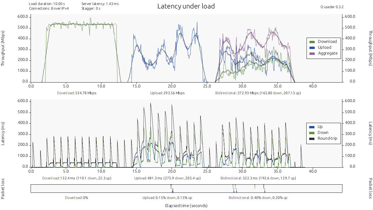

Turned IDS back on and saw some impact but definitely much more normal still
Had a little time to run these same tests ~24 hours later and throughput was back down to where it was before

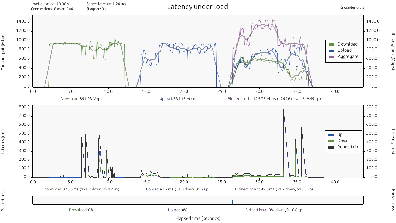

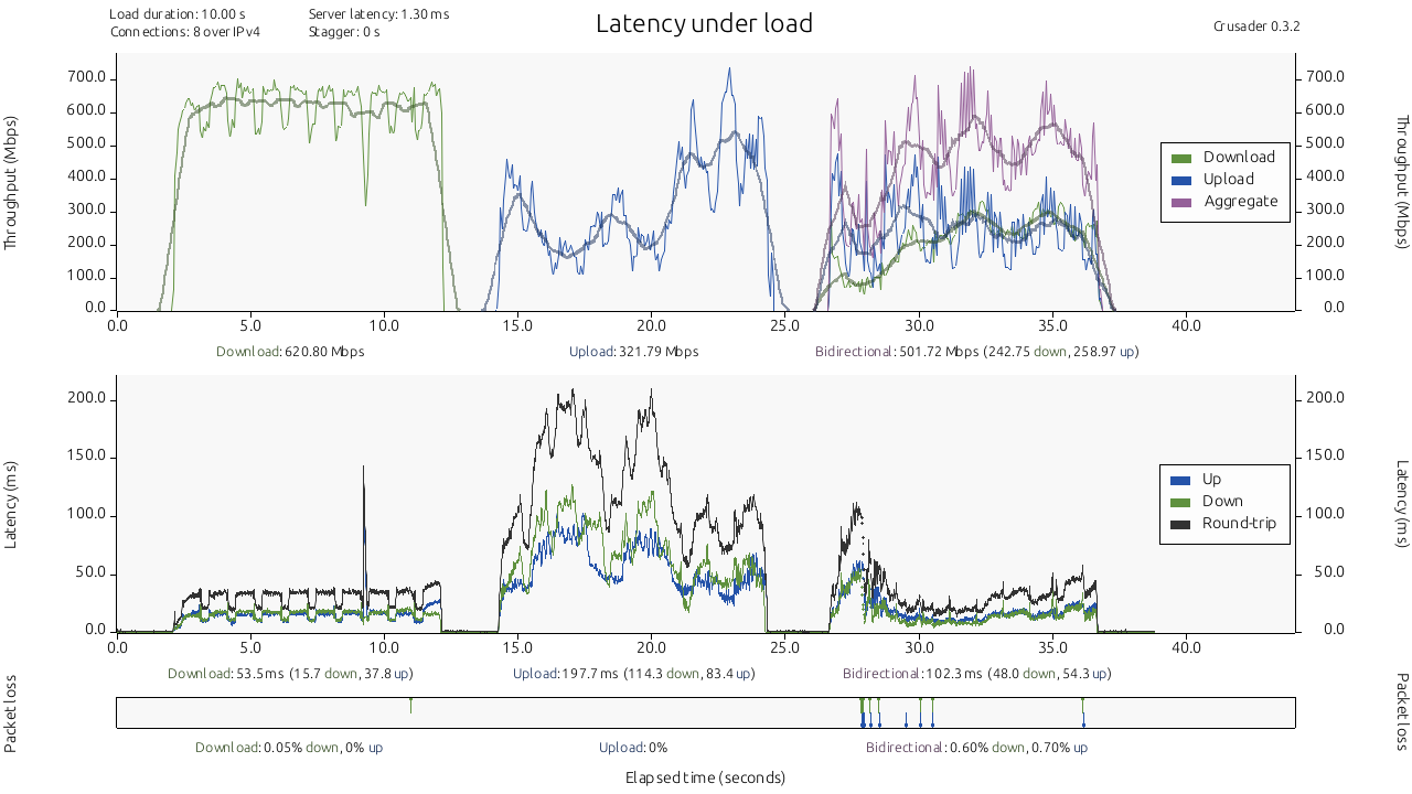

Turn off IDS and we’re a bit better again

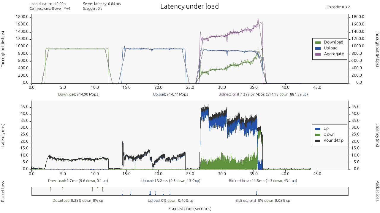

Then reboot the router and we’re back to normal
This is just behavior at one particular site where I can run some tests like this so I can’t comment if I see similar behavior elsewhere. Also since I just gathered this data up I haven’t tried filing a support ticket or anything like that to really drill down into it. Just wanted to share what I thought were some interesting results with the rest of the class :slight_smile:

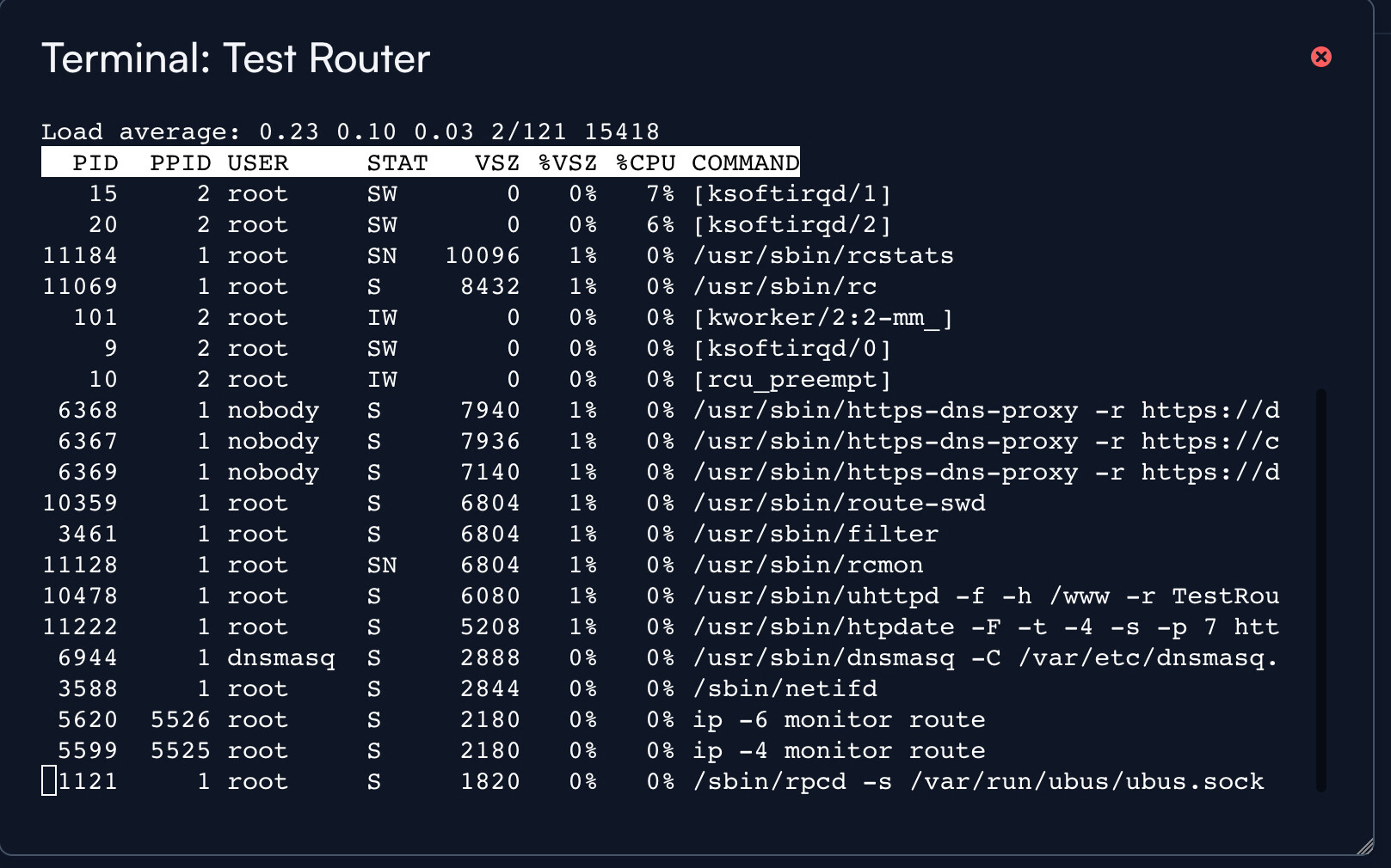

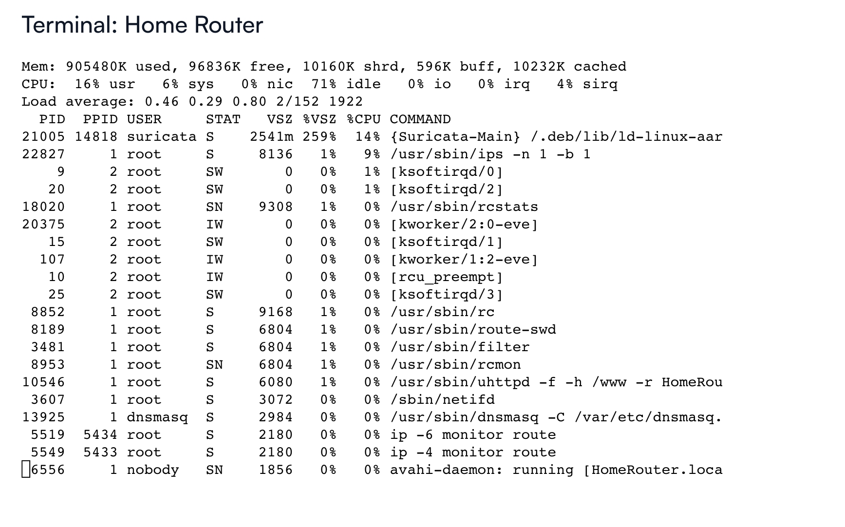

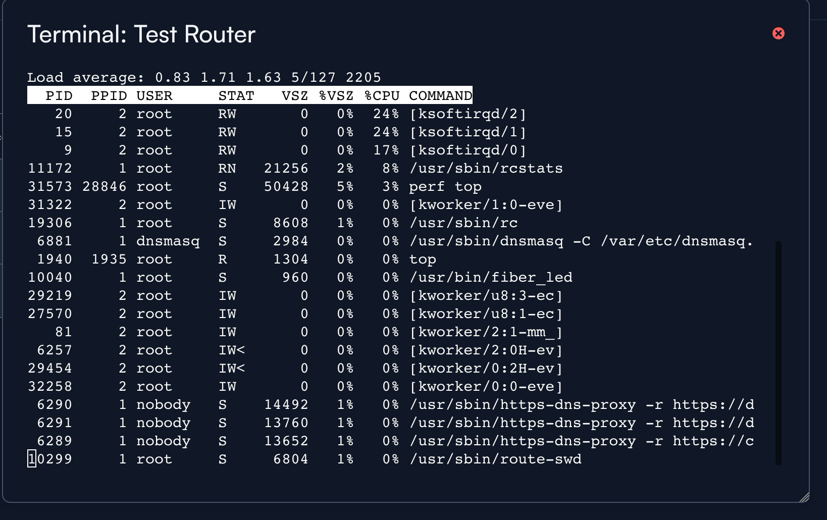

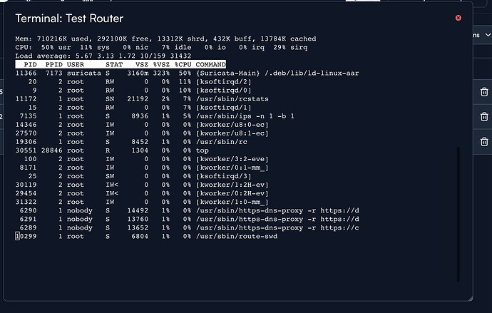

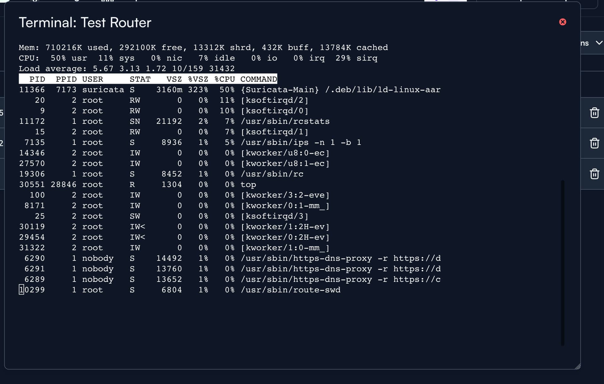

I did actually take some screenshots of how top was looking during those tests, although I didn’t take the time to really grab as much information as I could. I also didn’t want to make my post any longer than it already was! These would be during the second round of tests at this site:
Top after Suricata had been running for ~24 hours or so
Top after turning Suricata off
Top after a reboot with Suricata still off
I do still intend to run these same tests again at a different site to see if I can repeat the behavior. Just haven’t had a chance to yet!

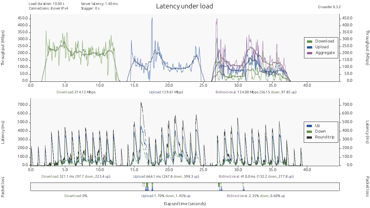

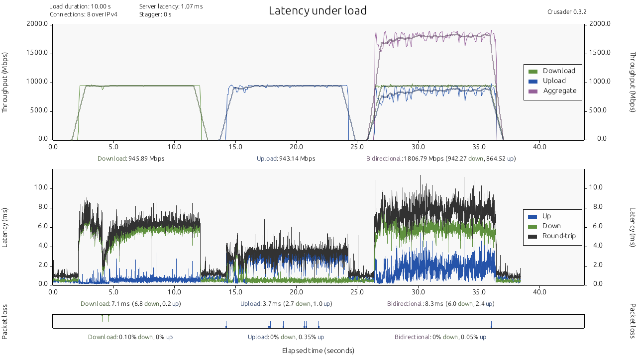

I was able to make a basic test environmet at another site that’s had IDS running for a bit and the performance definitely seems more in line with what I would hope for with Suricata turned on. Setup is basically like this:
Windows Client (VLAN1) 1Gb → Mikrotik RB5009 10Gb → Route10
Windows Server (VLAN 12) 1Gb → S8-POE 1Gb → Route10
and how Top looked during some of the test
So I don’t really have any conclusions to draw from this myself, just more data to look at right now.
