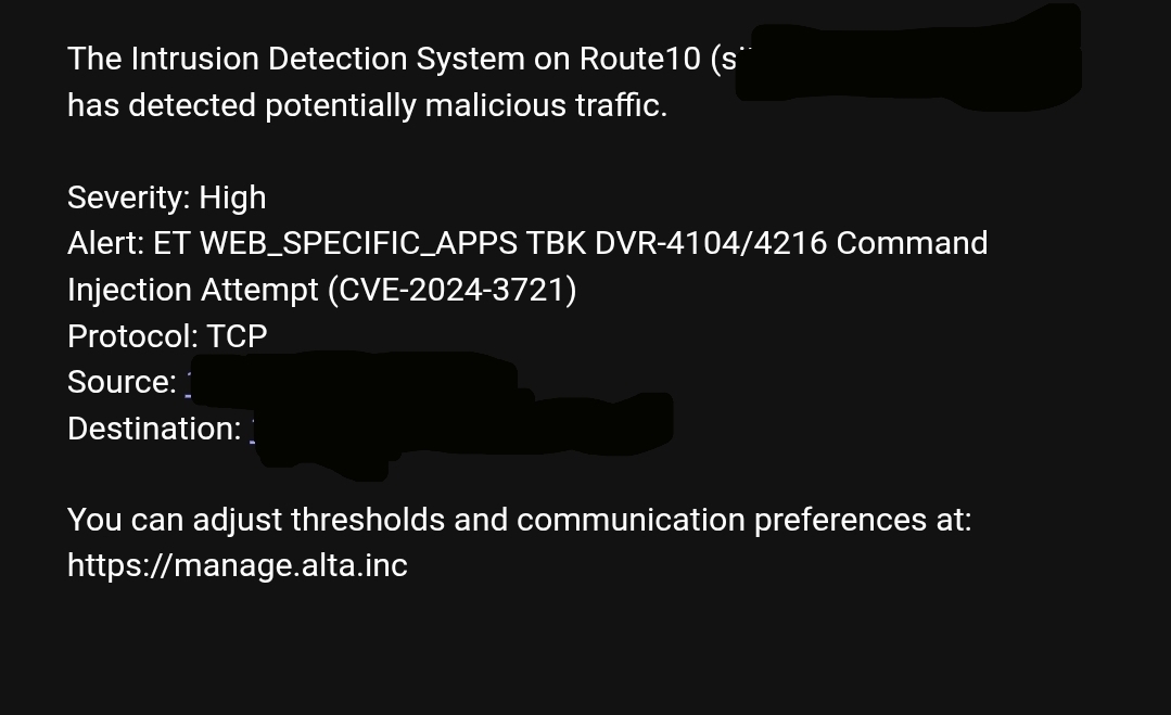

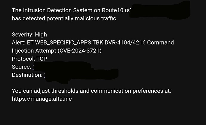

Is there supposed to be an alert associated with this activity? I’ve never seen anything other than IDS alerts, which dont mention anything about any action taken by the device regarding malicious traffic.

If you have blocking enabled, and the blocking level is the same or higher than than the notification level, then currently the alert serves as the notification that the specific TCP/UDP connection was blocked. As we are planning to implement improved blocking/IPS, there will likely be an icon next to IP<>IP connections that are currently blocked, which can be easily ignored/deleted if desired.
Im asking if there is an alert notifying of the block action being taken. This is the only type of alert Ive ever received from the device and it doesnt indicate anything other than there is an attack happening.

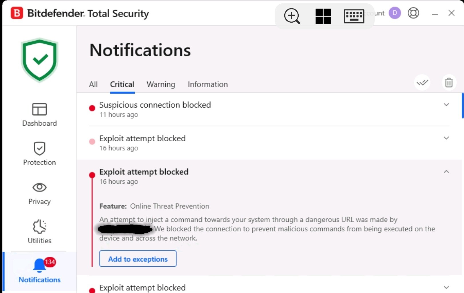

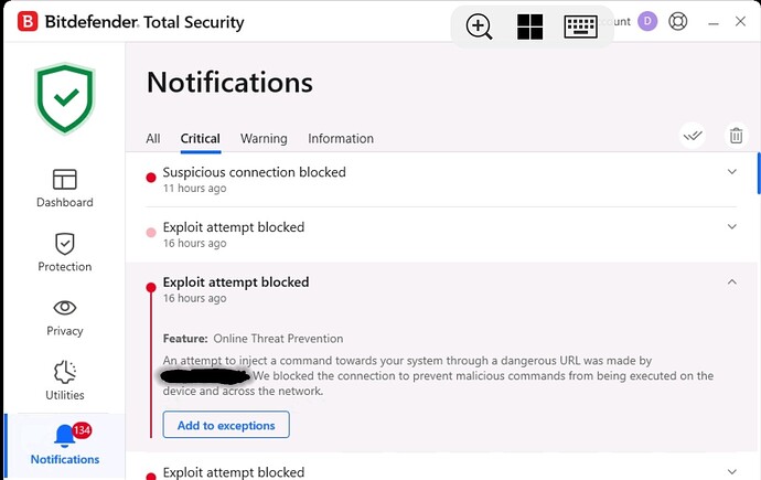

Meanwhile bitdefender on the targeted machine is actually blocking the attack.
I suspect with the approach of calling ‘conntract -D’ the initial attack packet and possibly more would get through before conntract -D updates the connection table to allow the firewall to drop subsequent packets as INVALID.
