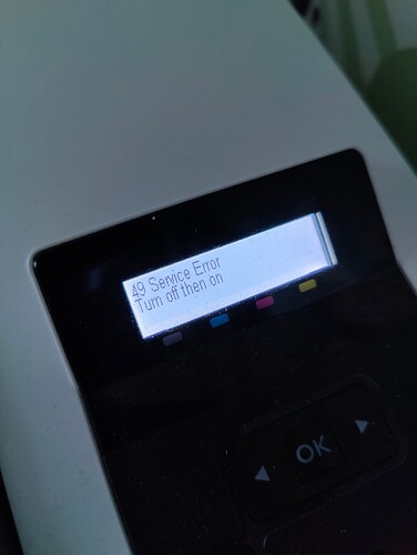

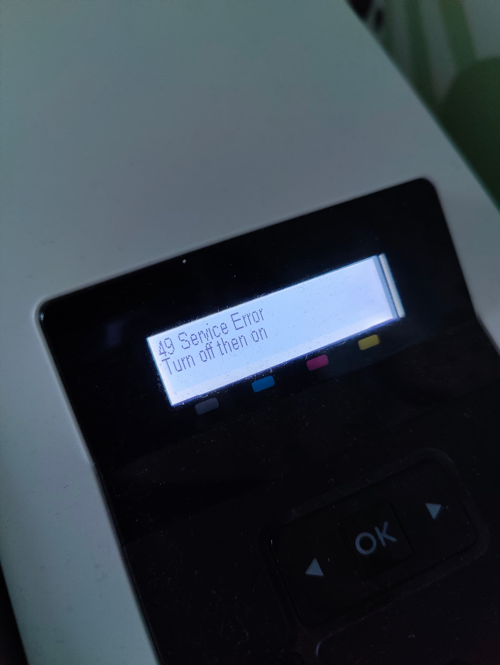

I tried this, right now, on the new set of firmwares, in case there was some remedy to this. All turned out the same, except for that I now could NOT print over WiFi from my Android phone to wired printer (PC on WiFi to wired printer continued to work both intra-VLAN and inter-VLAN).
No idea what that error meant, but it might be related to Android update, but Alta network updates are not ruled out.
