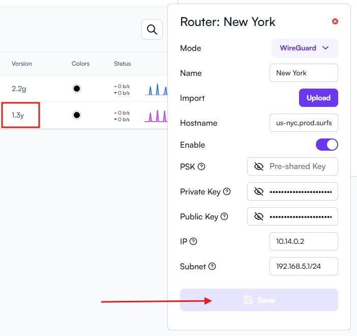

also, im still not able to add wg client without PKS.
firmware 1.3x → Add support for WireGuard client without PSK (controller support pending)

My Route10 is on the 1.3y firmware and also unable to save my configuration with no PSK in the field.
