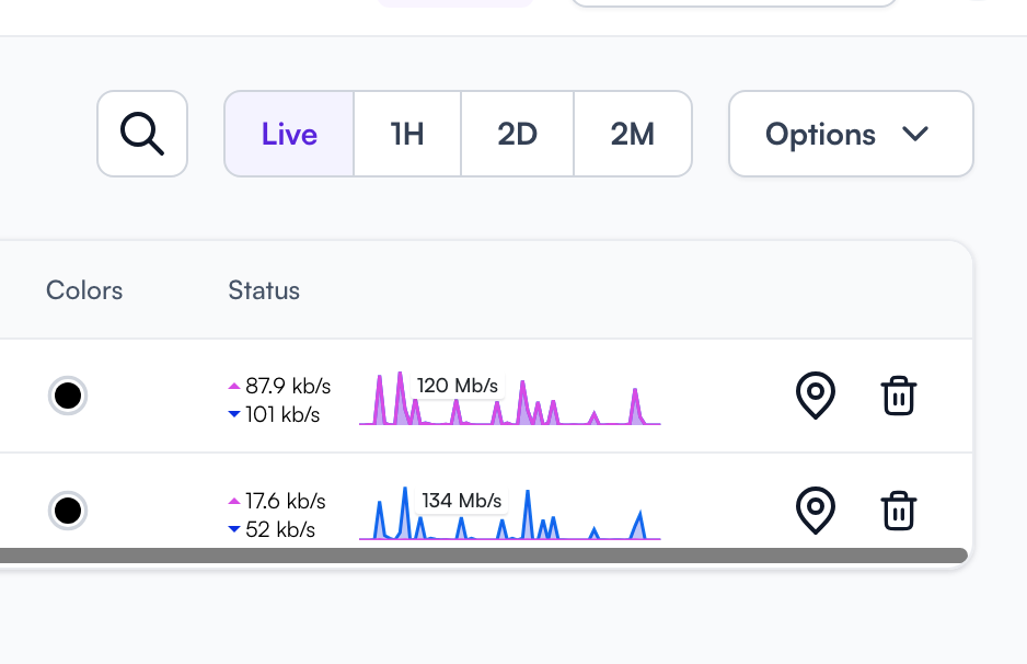

Should be a delete button alllllll the way over on the right:

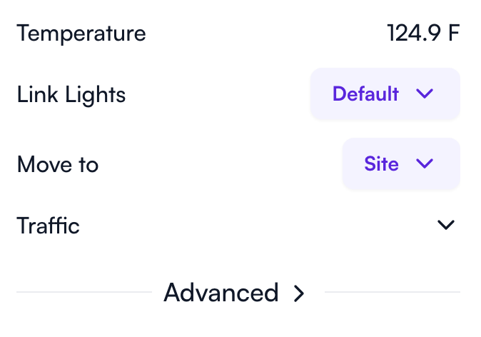

Although if you’re just moving it to another Alta site then you should have the option to move it to the new site in the router settings

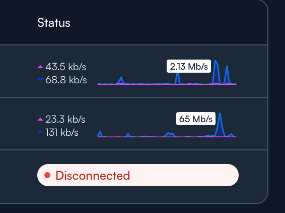

Not showing up on my side unless I am looking at the wrong panel in Network —> Right corner. Ignore the disconnected part for now waiting on a replacement power strip in the office.
Try another browser.
No, that’s seems correct to me.
I will say that if you’re on laptop and depending on size of the screen, I’ve sometimes had to swip left on my touchpad to in order to scroll further and see the icons. Swiping left on a network device in the iOS mobile app also presents the Locate and Delete options, and I assume the Android app is similar (just to give some more options to try!).

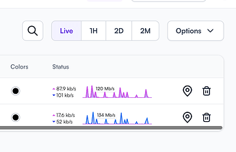

Interesting so @Beaker’s suggestion of trying a different browser worked actually. Unsure if it’s due to my browser being set to japanese as primary and English as secondary. Was using chrome on MacOS and swapped to brave on MacOS and it works. Mobile app for Android also works fine to swipe and delete it from the site.
Scaling wise I did try setting it to 80% but it didn’t show up on chrome it did show up on brave at most scaling sizes below 90%. It seems like the scaling of the webUI is based on a desktop sized monitor since typically I configure alta gear using a laptop since we use the mobile app for on site deployments

Also check if there is a scrollbar at the bottom of the table; you may need to scroll it over to the right to see every column.

Switching to another browser helped, sure, but in the future also check if there is a scrollbar in any browser. It may resolve the issue without switching browsers. It is also possible to use the mobile app and swipe the device to delete it.
