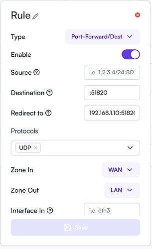

I have my route 10 up and running but I am struggeling with opening port 51820 for my pivpn.
Yes, I know route10 has a building wireguard server, but I’d like to keep using my pivpn for now. I can’t seem to get the port open.
my pivpn is assigned 192.168.1.10 as a reserved ip on the route10

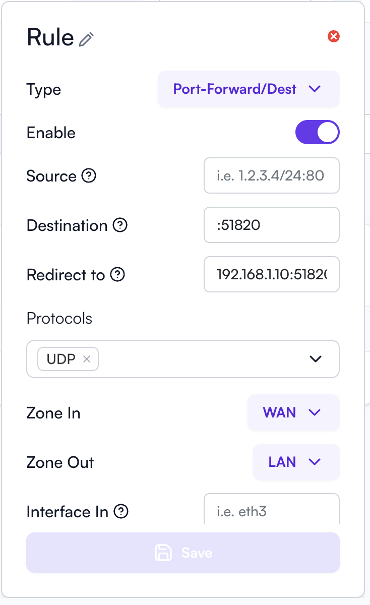

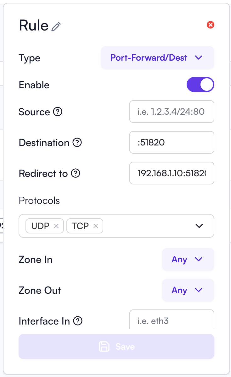

I’ve tried a million different combinations of the below:
anyone have suggestions?
THANK YOU
Hmm, looks pretty fine off hand although I think Zone In would typically be set to WAN and Zone Out would be LAN in this scenario. Also I think only UDP is needed for Wireguard as I recall.

I tried the change
seems to be working!
Awesome!
as quick as it started working — it quit :weary_face: :face_with_symbols_on_mouth:
I’m ready to throw this thing out the window :face_with_symbols_on_mouth:
Possibly, a companion firewall Allow rule has to be set up?
Remove the port on redirect to, just put the ip address in. Thats how i have all mine setup.
