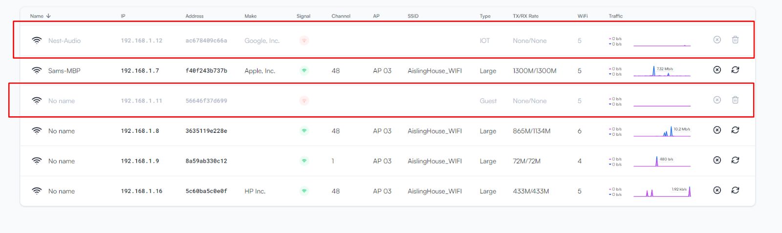

We have just completed our first project issue Alta labs AP’s.
We are having an issue with connecting a Google speaker. It gets an internet connection but the phone with the Google home app can’t see the speaker.
The speaker is on the IOT network
The phone is on the GUEST network
Works fine on their original WIFI system.
I am probably doing something wrong as this is the first time setting this up.
I am aware that both devices are showing offline in the photo, this is because the customer has moved the devices back to his original wifi system until I figure this out.
Also I should add, there are no VLAN’s
If you change both networks to “Standard” do they work? Using IoT and Guest might limit the communication between devices, so curious if Standard works, then we can go from there :slight_smile:
