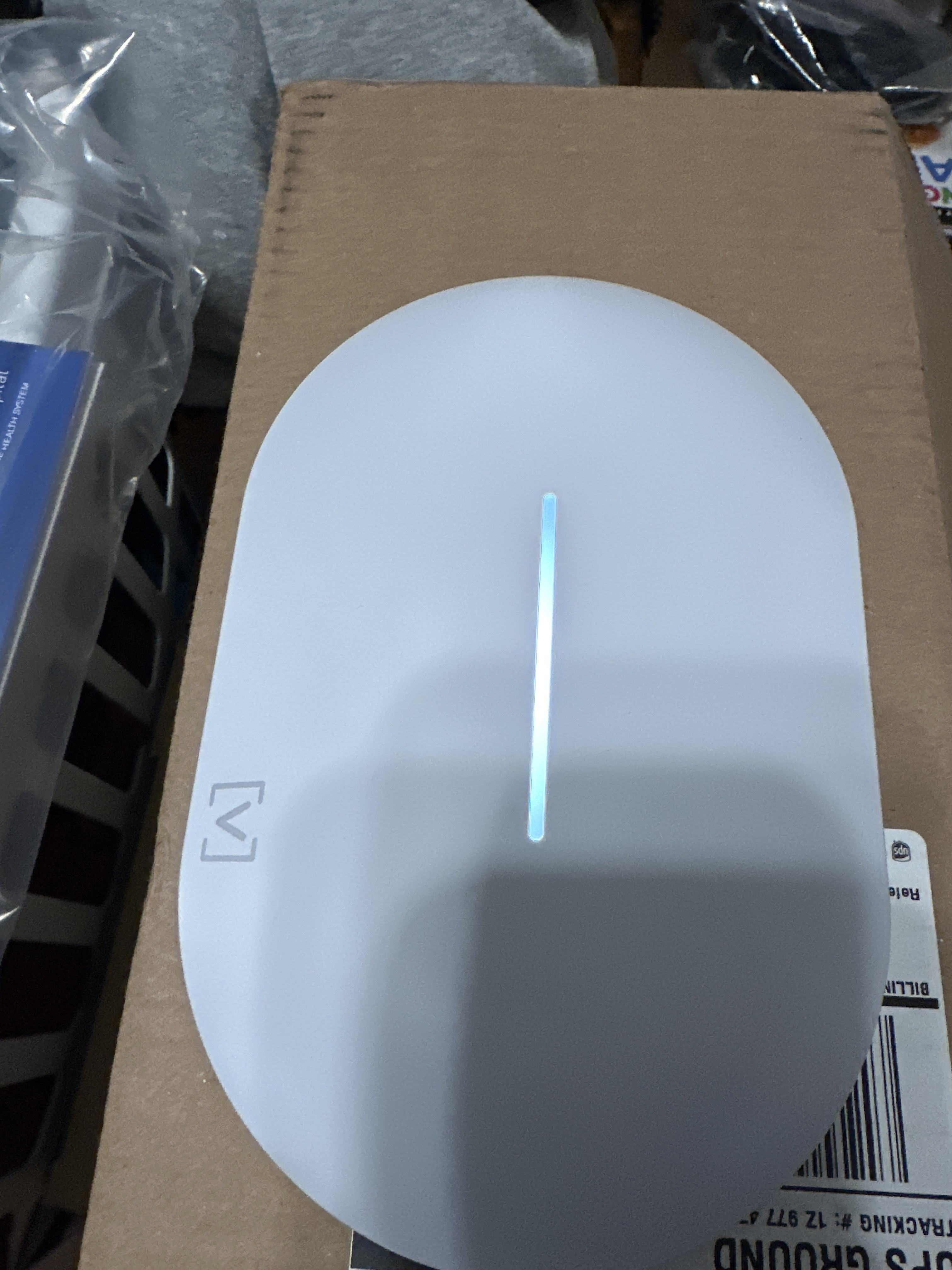

I just received my 8 Port switch and AP6 pro and was super ready to setup. I was already looking to get this setup but talked a buddy into it as well and he got his up and running in minutes.
This was not my experience, unplugged prior network which consists of the FIOS G3100 router.
I ran ethernet from ONT to switch port 8
AP6 pro poe port 1
Gaming pc port 5
Plex machine port 6

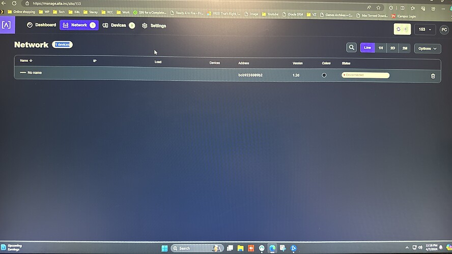

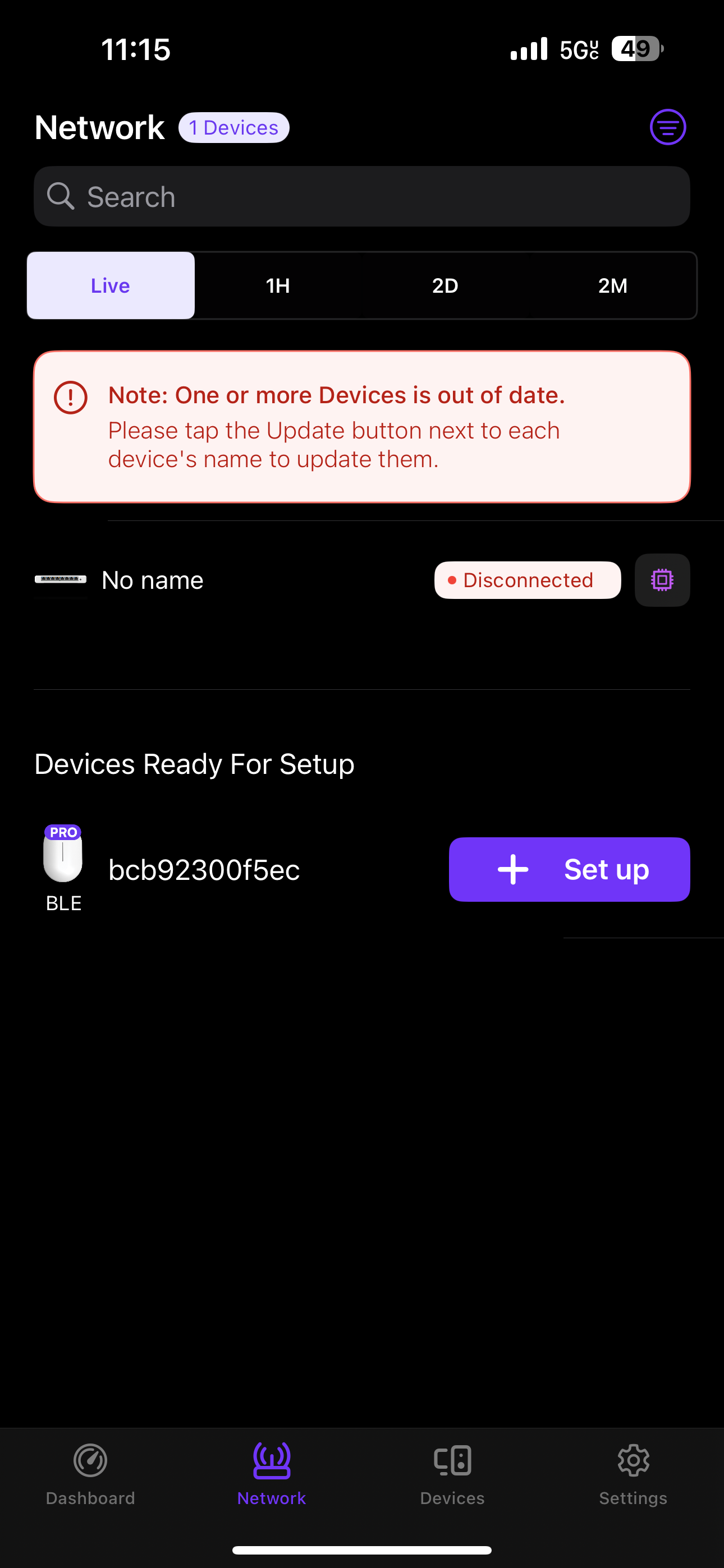

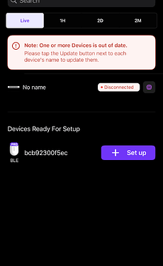

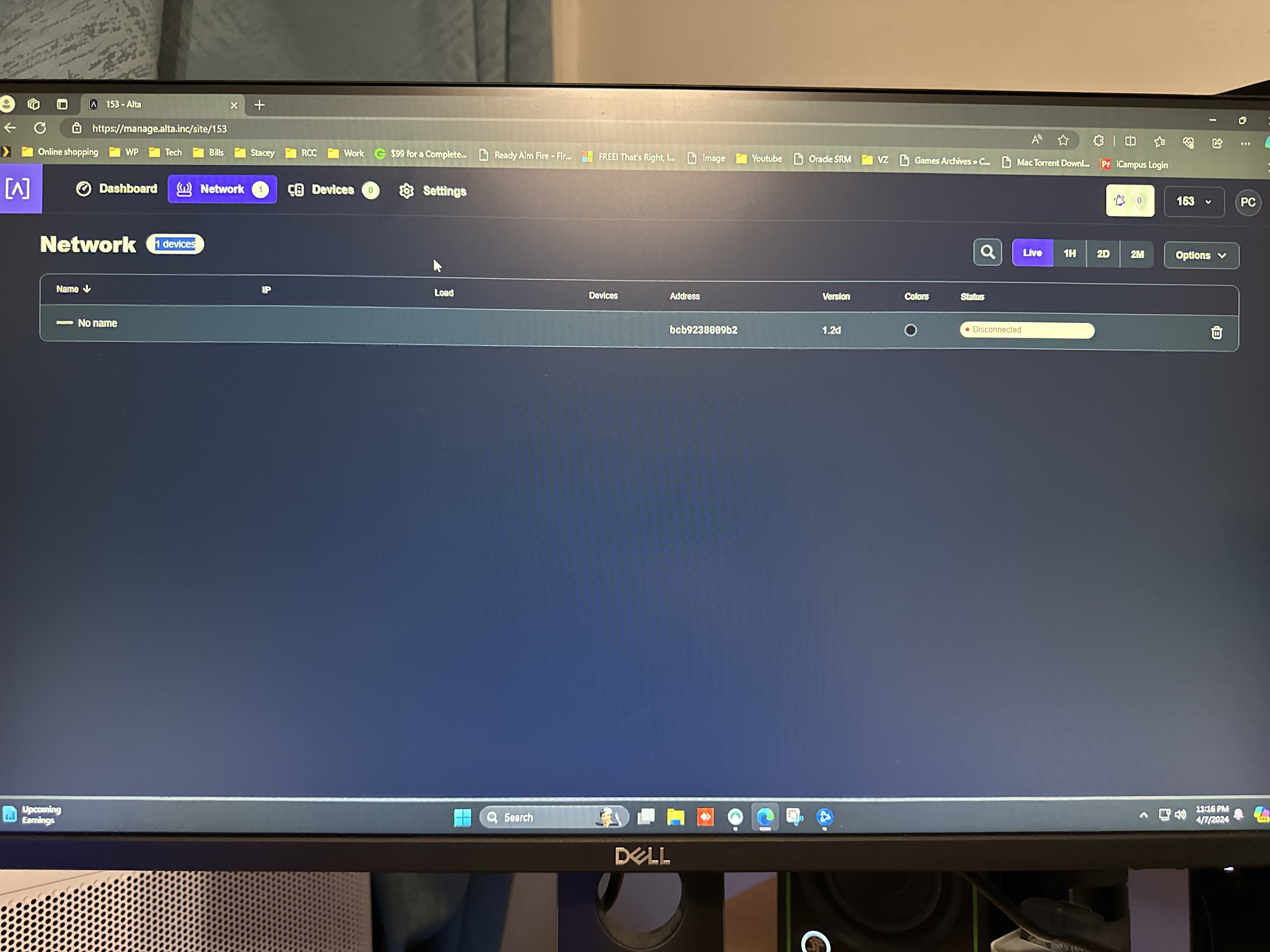

Powered on some how I was directed to app so I booted it up right away it detected both the switch and AP without a problem. It stated there was an update to one or more devices but no update button was visible.

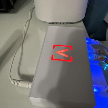

After several minutes trying from PC and app it showed up on app but it would not complete and my pc kept disconnecting from the web. Finally pulled power held reset powered up after a few minutes and now I have a flashing red logo from the switch HELP.

Got it working last night 3am by plugging the Verizon router to the switch and was able to update and get some traffic. Unplugged the the router anost connection again, so I ended up redoing the connection with the router to get my work PC and Plex server online.
Yes I was going to ask. you if you completely removed your router, and connected the fiber from Verizon directly to the switch. You will definitely need a router to get access to the other devices.
I just took a look and it seems like everything is working as it should, but if you need anything else, let us know!
