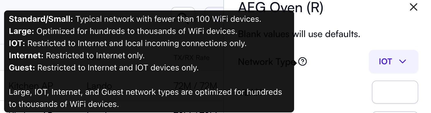

I have seen quite a few posts on here of Firewalla units being used with Alta Labs. If you use a Firewalla unit do you also use the catergorisation options in the APs such as IOT, Internet only etc. or do you just use VLAN Segregation etc.
Just interested to see how People have theirs set up and also wondering if you use both methods if there is a potential issue / s?

Thanks for your feedback - so I assume you weren’t using any of the Network types available in the network box on devices connected via Wi-Fi as per the picture below and use Default or Standard / Small
The reason for the ask is partly out of curiosity to see what people with Firewalla units are doing (as mentioned previously I have seen a lot of the pictures people have posted of their setups have Firewalla Golds or Purple) and to see if People are in the main using standard VLAN segregation or if they are using the available classifications available as part of the Alta Labs solution.
