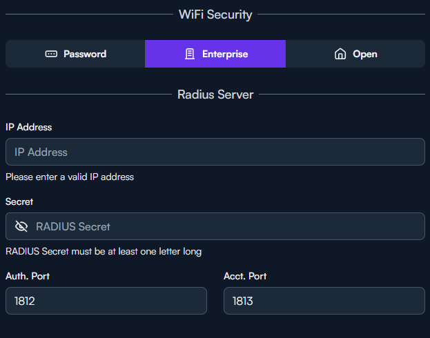

I think you can do this today but you are missing a component which is the Network policy server. You can set up your wifi to connect to a radius. Set up a Packetfence instance and point the wifi to that for the radius. Then in Packetfence you can create profiles for devices as well as policies like times for access etc. I have been meaning to try this as a lab but it hasn’t made it high on the priority list. If if do, ill maybe post about it. Im just not sure how far Alta took the 802.1X implementation and if they support Change of Authorization (CoA). Maybe someone around here has already tried this out.
