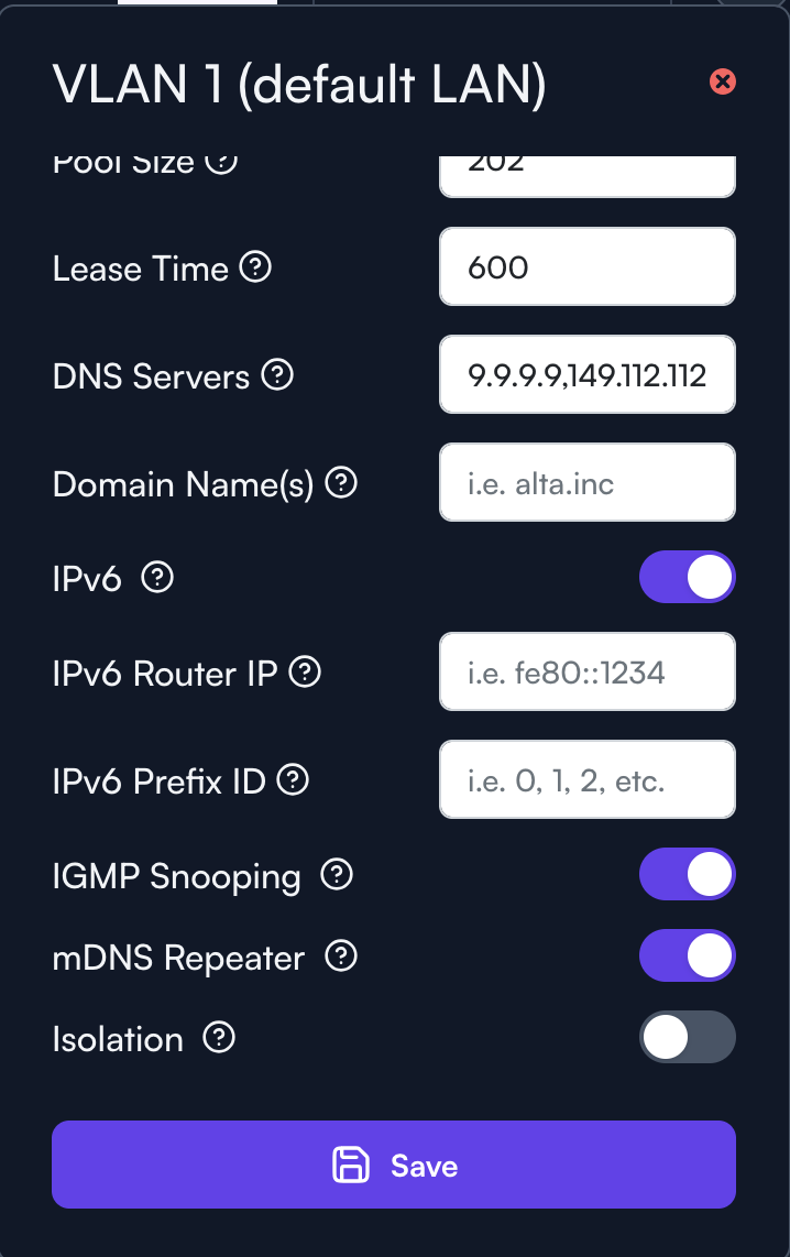

  1. Enable IPv6 on VLANs
  • Go to:Settings → Networks → VLAN
  • Select the VLAN you want to enable IPv6 for.
  • In the configuration window, ensure that IPv6 is enabled for this VLAN.
  • This is sufficient for basic IPv6 connectivity on the VLAN.

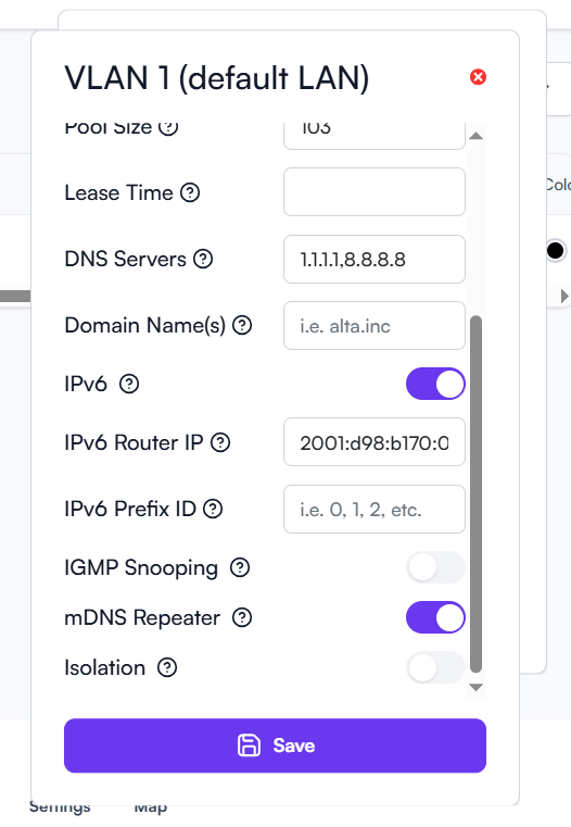

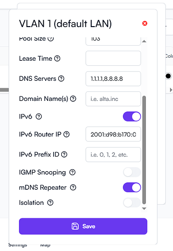

  • I set VLAN 1 to ipv6 and set the LAN address here (I have a /56). This is correctly set in the pop-up in the IP column.

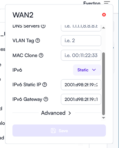

  • I set the right-most SFP slot to WAN2, and set that subdialog to the static WAN address (/64) and the gateway address. But this does not get saved into the pop-up in the IP column.

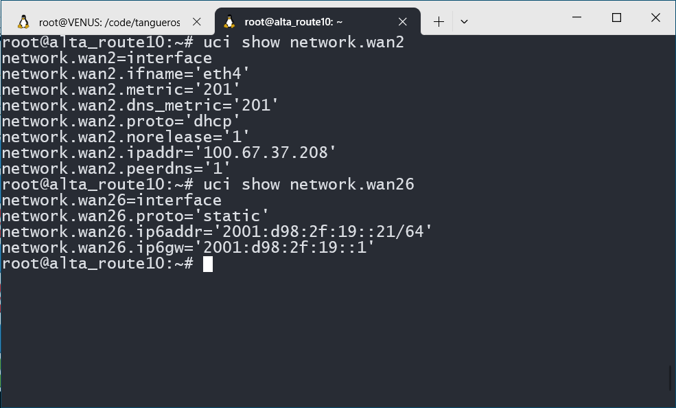

I ssh to the Route10 box and checked:
  • uci show network.wan26 has correct parameters stored.
  • ifconfig eth4 shows that IPv6 address is not updated.
  • ip -6 route shows that gateway address is not updated.
I don’t know how I am supposed to correct the problem – whatever changes I make to the CLI do not get saved when the box is reset. Is this a software bug in the current UI?

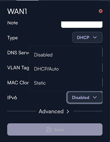

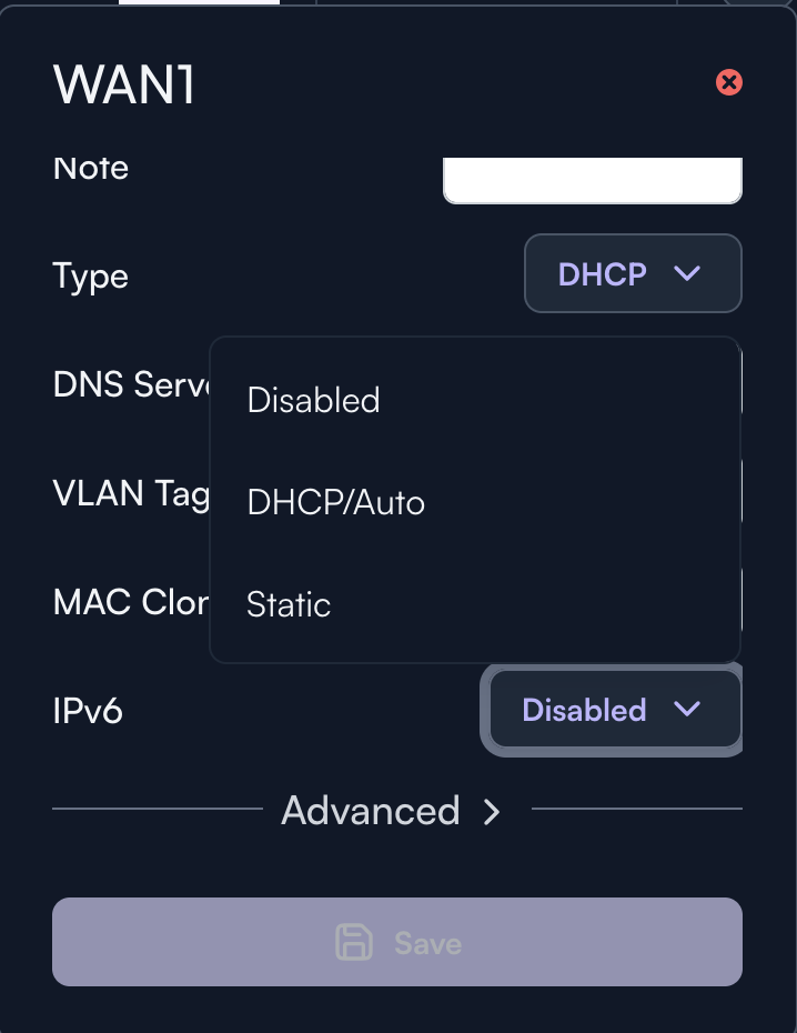

For the WAN, you can toggle IPv6 in Settings -> Networks -> WANs. For LAN, Settings -> Networks -> VLANs. Are you seeing these options?
Yes I saw these options in the Control UI, and they are all correctly set and saved.

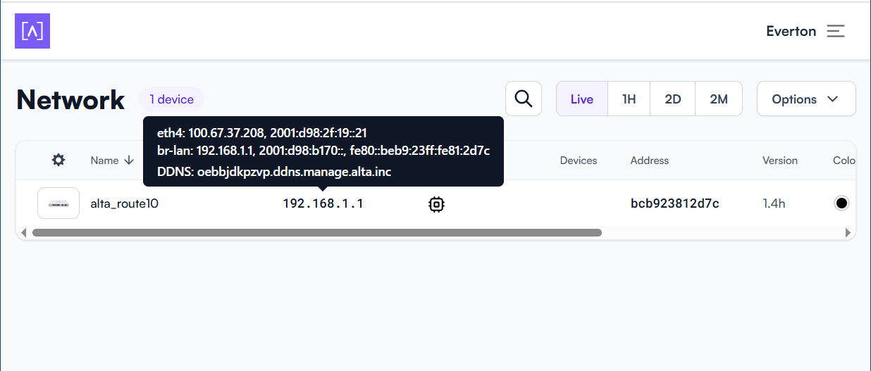

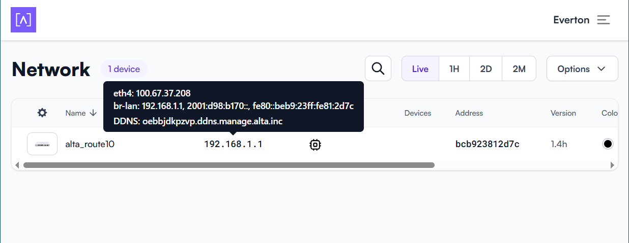

After power cycling, the control ui shows this, notice eth4 has only IPv4:
Drill down from the control UI shows IPv6 settings are all correct:
SSH to the Route10 and check with CLI commands:

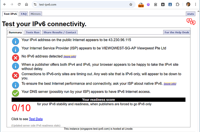

IPv6 fails
So the problem is very obvious: whatever the user enters into the control UI is saved, but did not set the WAN2 (eth4) interface correctly.
Since the Route10 is based on the OpenWRT system, I believe there is a misconfiguration between the web user interface and the underlying control files.

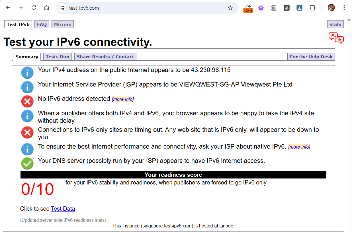

Not surprisingly the web test on IPv6 fails:

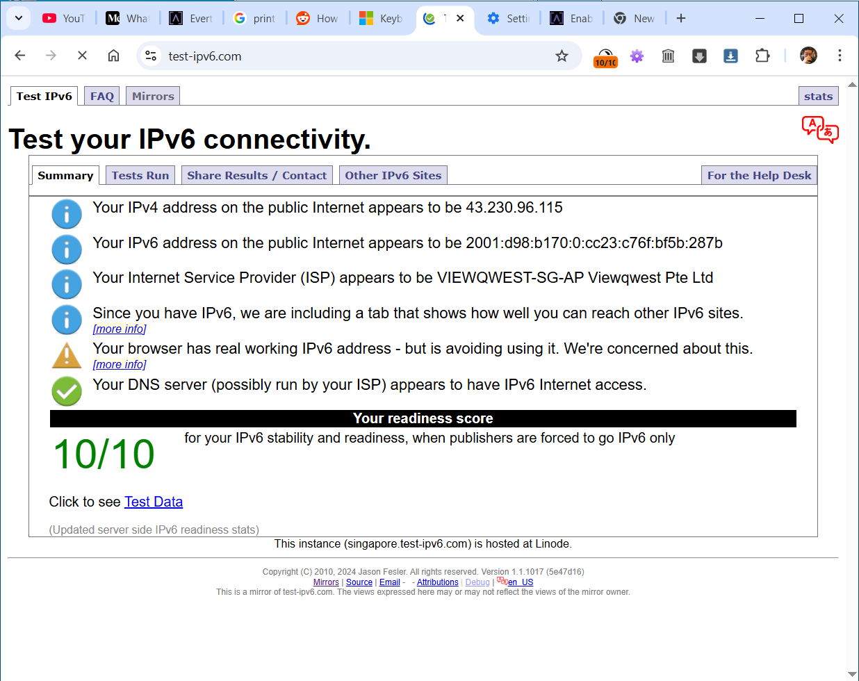

After modifying in the CLI, everything is normal:
Web test passes:
