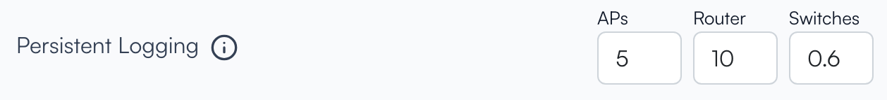

Because im facing “maybe” cache problem too, how can i proceed to make logs permanent after reboots and which logs do you need?
Persistent logging can be enabled in the System settings of the controller under the Advanced section :slight_smile: Here’s an example of how to set it:
