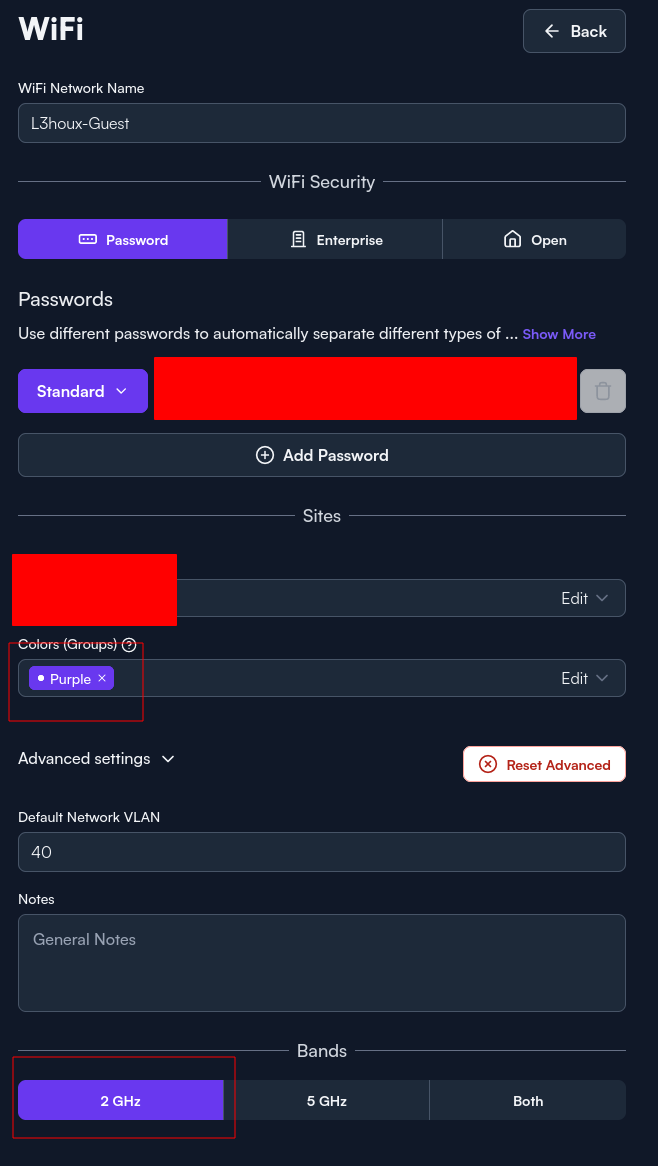

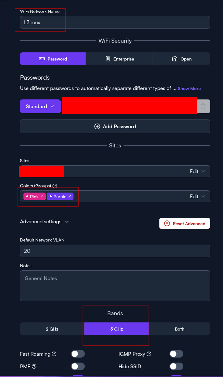

Yep, you can assign color to a Wi-Fi setting. After, assign that color to the AP.

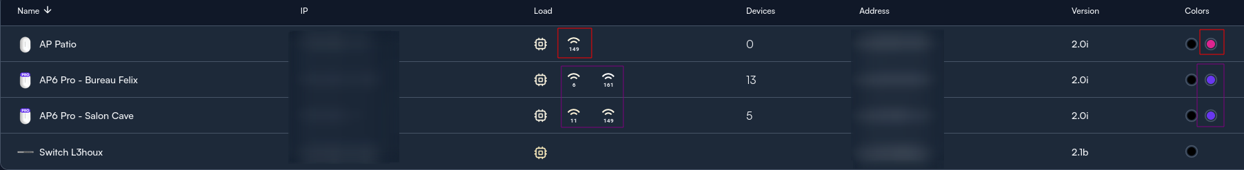

So purple is 5Ghz and 2.4Ghz (depending of the Wi-Fi SSID)
Pink is only 5Ghz for the “Home” network stuff. So this way, only IoT devices, and guests connect to 2.4 Ghz.
You can do it per SSID (colors) or on each AP.
