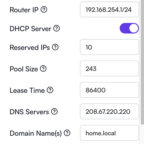

All the settings look pretty standard. DHCP is enabled on vlan 254, I have left the default 10 IP addresses reserved and added a specific DNS server address.

Here’s my additional subnet settings

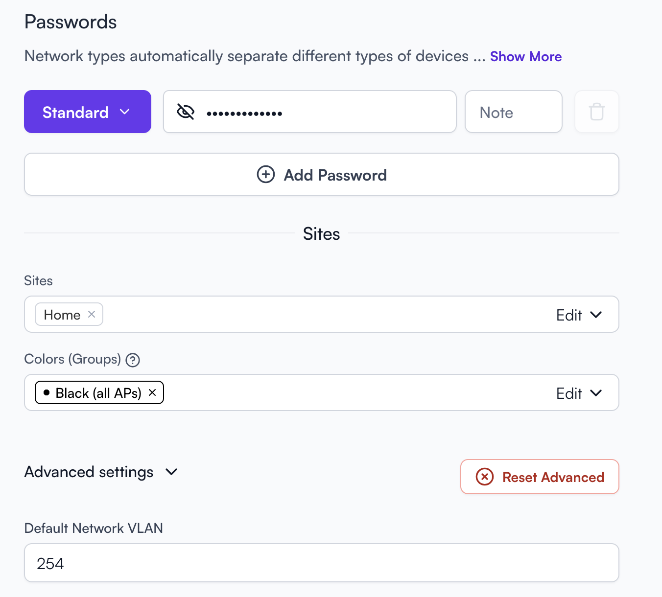

Here’s how I attach the vlan to my SSID
