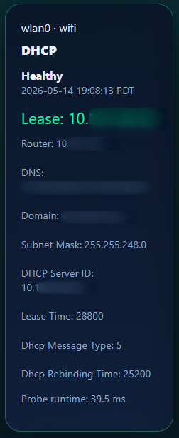

  • DHCP tests including DHCP option info provided by the DHCP server like voice vlan or tftp server etc.

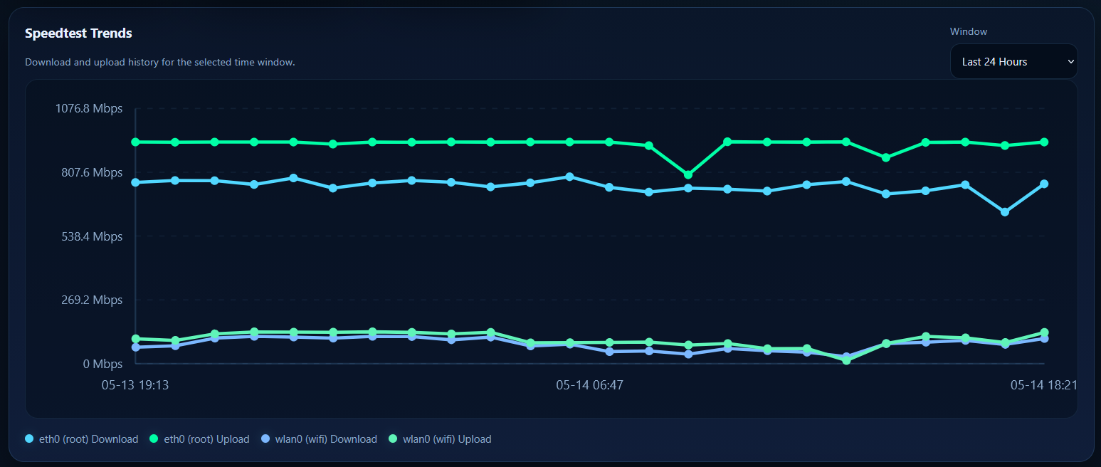

  • Speed tests

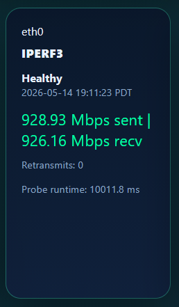

  • Iperf tests for on site servers

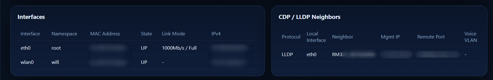

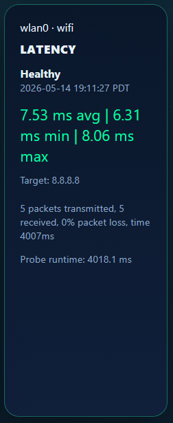

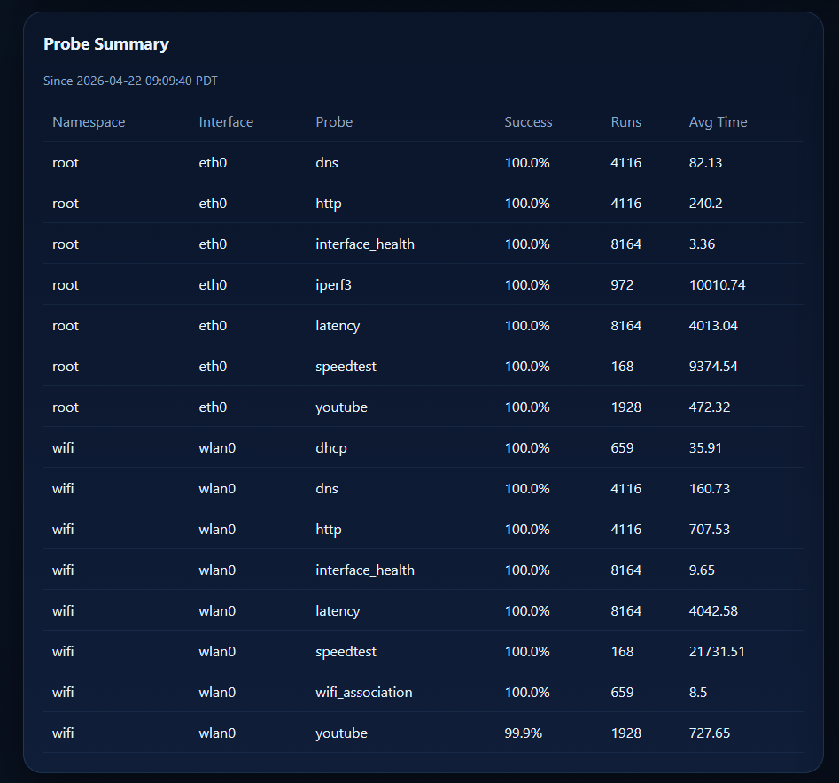

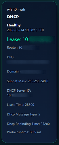

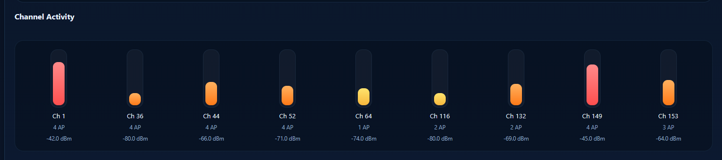

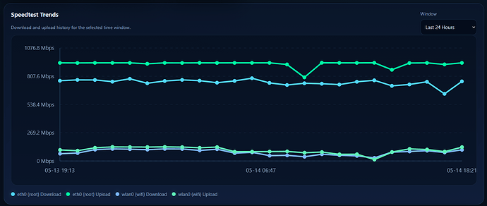

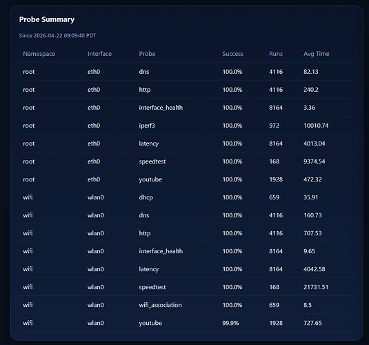

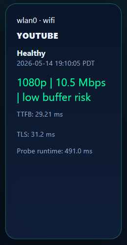

I’ve resulted in just home brewing my own (screenshots below) to run on a pi but SBC’s aren’t as cheap as they used to be and this could be a pretty cheap way to get value add for Alta I would think. I think most of the work with the testing has already been done, you would just need to convert the AP to client and put the Eth0 and WLAN interfaces in different net name spaces.
